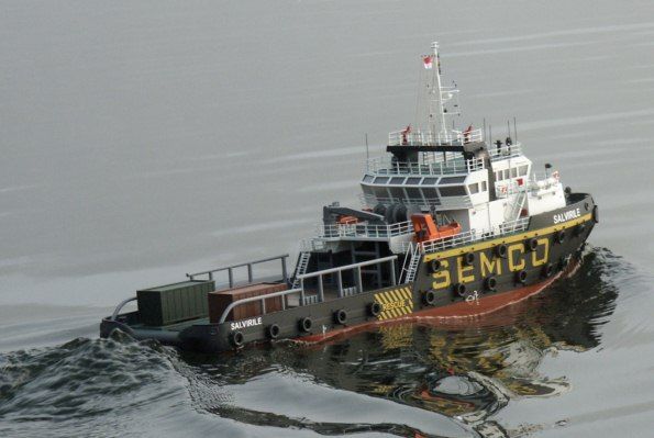

There is nothing particularly altruistic about this short piece on my Tian Jie (T.J.) Models 1:75 scale Salvirile tug nor is it a ‘blow by blow’ account of its construction, but I thought some model builders might be interested in something a bit different. I bought mine because I liked the kit when I first saw it in April 2007 at Intermodellbau, Dortmund, Germany. I was unable to purchase it there and then, because the manufacturer, although having a stand, had actually only bought one of each of some of their range plus some made-up models, and all as domestic luggage on the flight from China! I was not too keen on giving my credit details to a business that I didn’t really know, but was subsequently able to purchase the kit from Loyalhanna Dockyard in the USA. Their website address is: www.loyalhannadockyard.com and their service is excellent. Current price is 460$ plus p/p plus UK VAT on arrival in the UK. Obviously, different arrangements apply in different parts of the world and yes, Loyalhanna Dockyard does dispatch to anywhere on the globe. The effective final doorstep price was a fraction over £400, although the exchange rate at the time was better than it is now. I emailed Loyalhanna to confirm that they had the kit; once that was confirmed I telephoned them and gave my credit card details verbally. After that I received an email confirming dispatch, likely arrival time and in fact approx. 10 days later Parcel Force sent a card to say that they had it and the VAT payment required for delivery to be completed. So, the point of this little homily is to say that purchasing from ‘across the pond’ for UK residents is straightforward, provided the supplier is reputable. TJ Models have their own website: www.tjmodels.com.cn which includes information about the product range.

Now the ‘biggy’! First you will notice SEMCO on the sides and the rescue zone markings. These are supplied as sticky decals. Big problem: They would not readily take the contours of the hull or lie properly over the rubbing strakes, so what to do?
Well, after priming the hull with Halfords Red Oxide Plastic Primer (this is the base colour for the bottom) and then spraying the rest of the hull Humbrol Satin Black No.85, I used the SEMCO lettering sheet with the letters removed as a stencil through which I sprayed the word SEMCO. The sticky vinyl stayed on for just about enough time for the yellow spray not to ‘bleed’ onto the black, but it was touch and go. The same technique was used with the “Rescue Zone’ cross hatching except that BECC lettering was applied instead of stenciling.

If you are wondering about the two OO gauge containers on the stern? Well, they contain(!) the stern ballast. Being on deck at that level has not affected stability and they also ‘fill up’ a rather empty towing deck.
