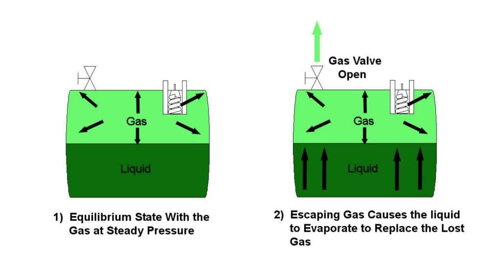

The first pair of diagrams shows:
1: A gas tank containing a liquid and its gas in a state of equilibrium at ambient temperature and the gasses saturation vapour pressure.
2: The gas valve has been opened so gas is now escaping. This causes the saturation vapour pressure to fall so the liquid will start to evaporate to replace the lost gas and maintain the pressure.

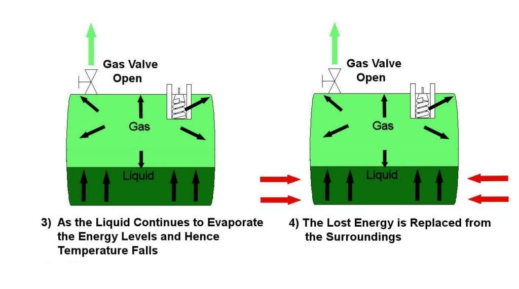

The second pair of diagrams shows:
3: The liquid level falling as the liquid continues to evaporate to replace the lost gas. It is accepted that the liquid molecules of a higher energy level are the first ones to evaporate and hence the aggregate energy level of the remaining liquid falls, causing the temperature to fall.
4: The liquid absorbs more heat energy from the surroundings to replace the lost energy. If the gas escapes quickly the temperature of the liquid will fall faster than it can be replaced from the surroundings
