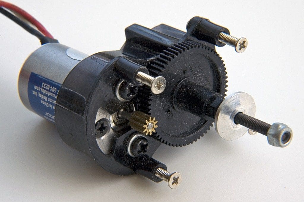

Modellers will be aware that the operation of a conventional direct current (i.e. brushed) motor depends on the repulsion and attraction of magnets to provide the forces needed to bring about rotation. A little further thought will show that to keep things moving, one of the interacting magnets will need to have its polarity continually changed, otherwise there will just be a momentary jerk of the shaft and things will come to rest with the magnets facing each other off. The polarity reversal comes from the action of the commutator, a segmented drum that rotates with the motor shaft and thereby is able to receive, from the brushes that press against it, a current of changing polarity to feed to the electromagnet poles of the armature. So the motor requires a commutator to keep it turning, and the commutator is turned by the motor, thus a nice cosy relationship.
This is the technology (amongst other power plants) that has driven our model boats around lakes for over a hundred years. It works, and it works quite well, but there is a downside to that cosy commutator and armature relationship. Chopping and changing the current to the armature in this way causes sparking at the commutator, producing heat, wearing away the brushes, wasting power and interfering with your radio receiver. So, the reason we fit suppression capacitors to a motor is to help quench this sparking. Additionally, power is lost due to the friction of the brushes and design constraints are imposed on the motor that limit its potential.

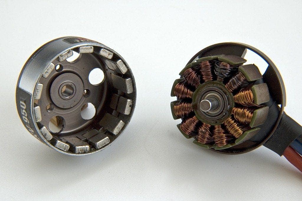

Without a need for brushes or a commutator, the electromagnetic windings of a brushless motor are made stationary (the stator) and the permanent magnets made to revolve (the rotor). The wiring connections are permanent and fixed; there is no need to make any electrical connection to revolving parts and two configurations are possible.

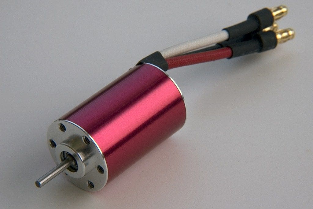

If the stator is in the form of a cylinder around the outside of the motor and the rotor spins within it, we get what is known as an ‘Inrunner’. If the stator is in the centre and the rotor spins around it, we get an ‘Outrunner’. Each has its own characteristics.
Inrunners look more like conventional motors, with a fixed cylindrical casing that for example would lend itself to watercooling in the usual way. With a small rotor, they turn at a high rpm.

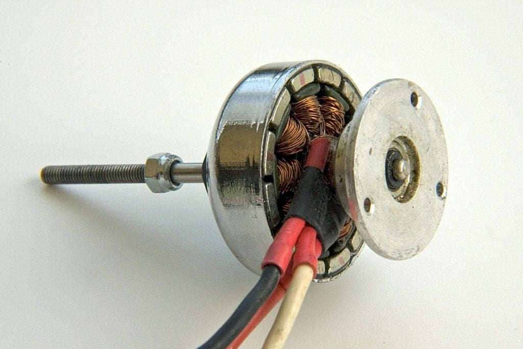

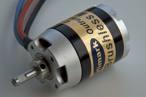

Outrunners most commonly have a rotating outer casing, with the permanent magnets arranged around the inside of its rim. They turn more slowly and do not readily lend themselves to being watercooled, but because the magnetic interaction occurs at a greater distance from the motor axis, they develop more torque.

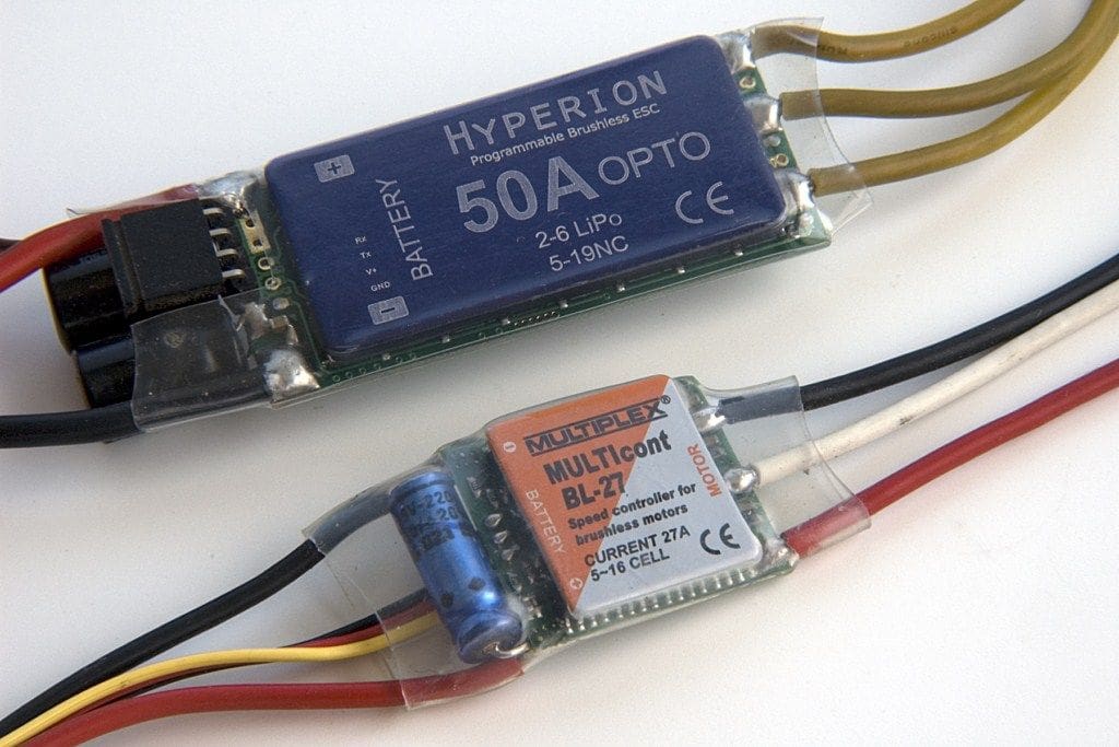

In the early days, perhaps just five years ago, almost all brushless motor controllers (BMC’s) available were designed for model aircraft and featured forwards only operation as there is little scope for running model aircraft in reverse. Those that offered reverse were expensive and hard to obtain. Now, with electric race cars making the switch to brushless motors there is a much wider choice of affordable controllers with a reversing function.

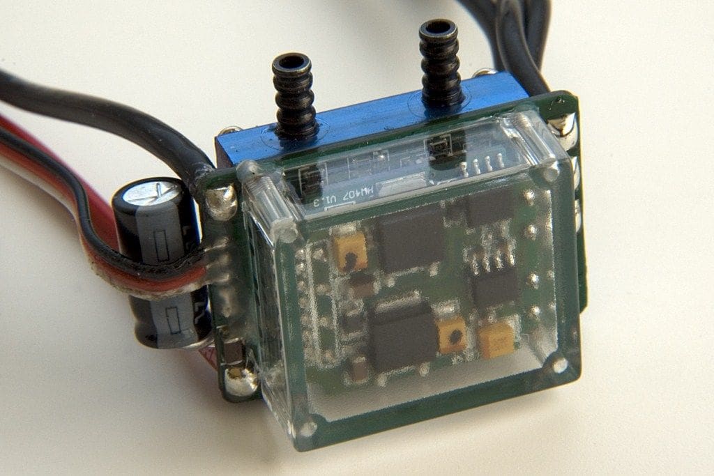

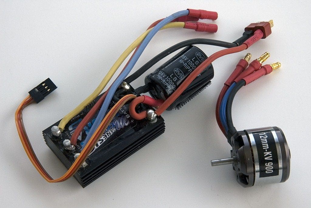

The common style of BMC consists of a small circuit board with surface mounted components in a shrink-wrapped plastic sleeve with wires poking out each end. Unless stated otherwise, the assumption is that there will be a generous flow of cooling air courtesy of the large aircraft propeller mounted just in front of it. If you use this type in a boat without any forced cooling, be sure to de-rate it by a factor of two or three. For example, use a 40 amp rating controller for a 15 amp maximum current rating. Run times tend to be longer with a model boat, allowing temperatures to rise higher than with short sprint operation.

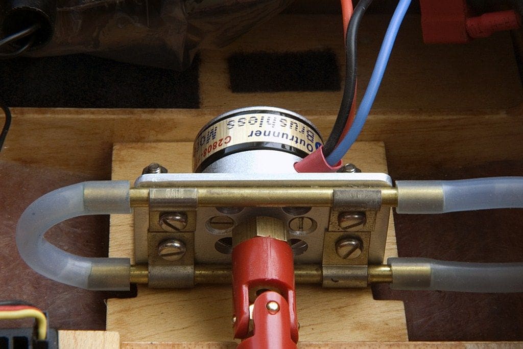

A more rugged type of BMC will feature a built-in heat sink, and this would be preferable for a larger model boat. It may then prove quite easy to watercool it by running cooling tubes between the fins of the heat sink. For continuous operation at higher power levels a dedicated watercooled controller is preferable.

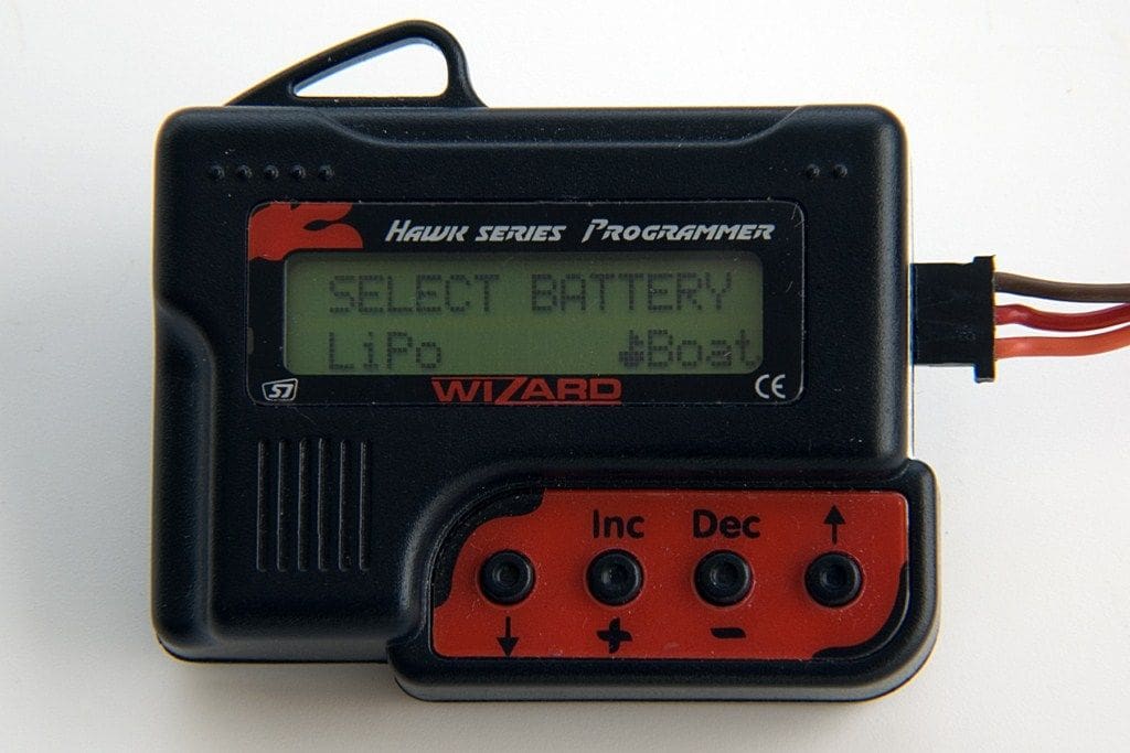

Many BMC’s have parameters that may be selected by the user and are thus referred to as ‘programmable’. The parameters might include the cut-off voltage (for use with lithium batteries), reverse function (enabled or disabled), braking (how quickly the motor responds to cutting the throttle), acceleration (how quickly the motor responds to throttle up), low voltage cut-off type (sudden or gradual) and so on. To enable you to do this using just your transmitter, manufacturers usually provide microscopically small instructions written in pidgin English that require you to interpret a form of Morse Code emitted by your controller in light flashes or beeps whilst you waggle your joystick in the prescribed way. This can be a nightmare, but there are a couple of ways around it.
When I buy a BMC at my local hobby shop, they will offer to set it up for me as I require it and perhaps your hobby store will do the same. Alternatively, most manufacturers offer a programmer to suit their brand of BMC that makes setting up a very simple and quick process. A programmer is not expensive, but only works for one brand and tends to lock you into their product. Provided you are not using a lithium battery, you might prefer to use a non-programmable controller such as the Mtroniks Hydra, which is intended and set-up for model boat use.

With a brushless motor controller, there are normally three connection streams to be made. For the sake of simplicity, here I am assuming the motor is the far more common ‘sensorless’ type. The signal connection is a flexible ribbon cable with three wires and a standard r/c plug that goes into the throttle channel of your receiver. This will provide power to the receiver via a BEC (Battery Eliminator Circuit) just like a normal electronic speed controller. If you are using a separate receiver battery you will need to cut the red wire or pull its pin from the socket so that your receiver has only one power source.
Two thick leads, usually red and black, are the battery connections and must be fitted with a suitable plug. Double check both the signal and power connections for correct polarity or you will likely do some damage. The three remaining wires need to be fitted with gold plated bullet connectors to match those on the motor wires. It doesn’t matter which of these wires goes where, but if the motor runs in the opposite direction to that required, swap any two of them around. Strange but true!

For most model boats, an Outrunner motor is the preferred choice as it will provide the torque needed to turn a larger propeller. This is usually more efficient and provides a better all-round performance. Due to their rotating cases, water-cooling can be difficult, but one of the photos shows a possible solution provided by cooling the motor mounting plate. The quicker-spinning Inrunners are more suited to fast electrics with light hulls that are able to accelerate to a speed where there will be better propulsive matching to a small fast turning propeller. Of course, there is no reason why an Inrunner (or an Outrunner for that matter) could not be geared down to suit a slower vessel with a large propeller and there are model aircraft gearboxes that might prove suitable for this. Higher powered Inrunner motors are available now with integral watercooling jackets for use in fast electric boats.
Other things to look for are the shaft diameter and length. Does it suit your intended coupling method? The method of mounting, which in the case of some Outrunners can be off either the front or the rear of the motor? When mounting the motor, take care that the mounting screws are no longer than they need be, otherwise they may penetrate the motor innards and cause irreversible damage. All the motors I have seen have had metric threads with M3 being the most common on small to medium motors. An oversized aluminium mounting plate may provide a measure of cooling by acting as a heat sink.
If you are a graduate of the old Taycol school of brushed motors, you will be impressed by the universal use of ball bearings and the precision CNC machined components that go into brushless motors, even the low cost ones. The small Outrunner illustrated, which is the size of a large bottle cap, can equal the power of a 1.3kg Taycol Double Special, so that may give you something to think about.

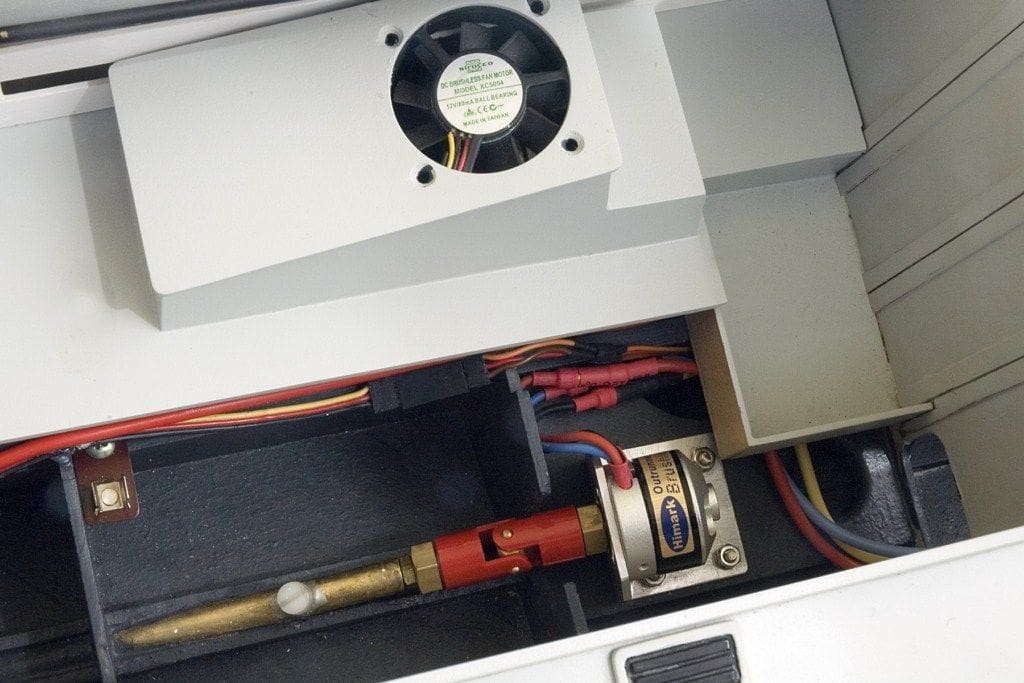

This is not a conversion and it is the ST206 Seaplane Tender in 2009 Model Boats Winter Special. This runs fine with forced air cooled Hi-Mark C2808-1360 motors and Prop Shop 1517/3 propellers. The forced air cooling refers to small CPU cooling fans that come on when the throttle is advanced over halfway, which is probably not necessary if you live in a cooler climate than that of Australia. My current model is a classic wooden power yacht and I have reverted to brushed motors, but this is largely because I happened to have two going spare and wanted to prove to my detractors that I am not completely addicted to brushless motors!
