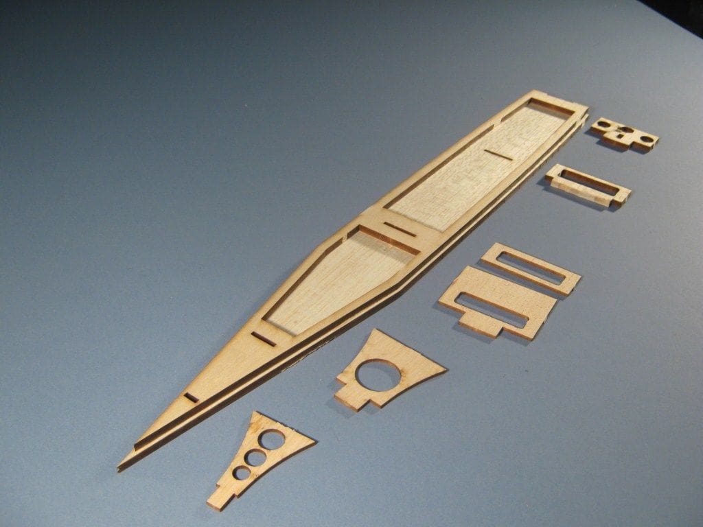

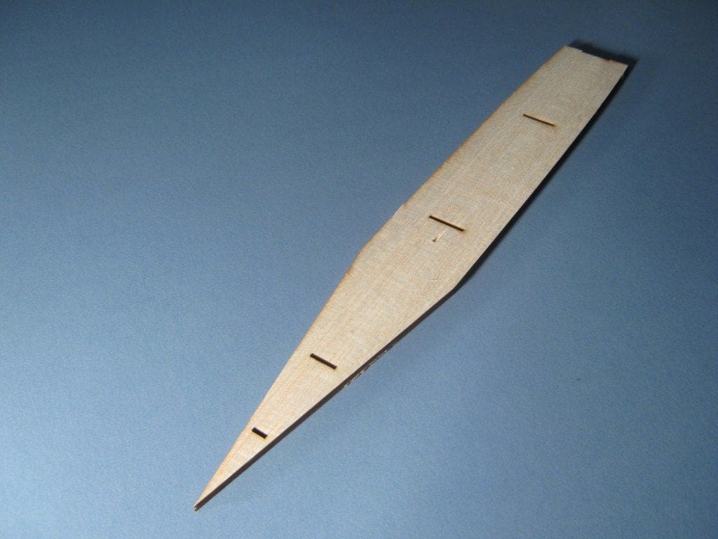

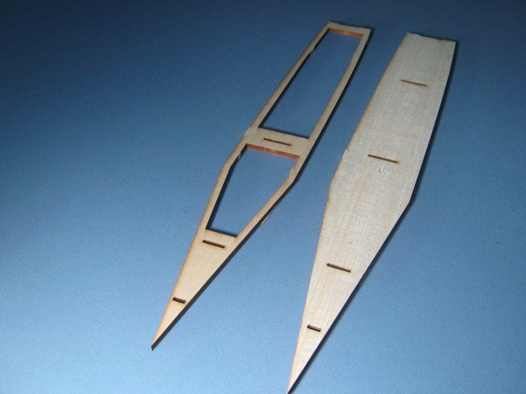

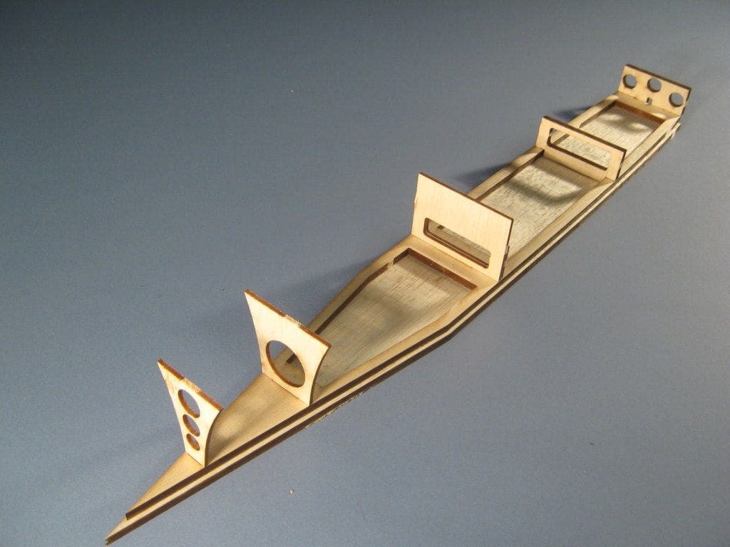

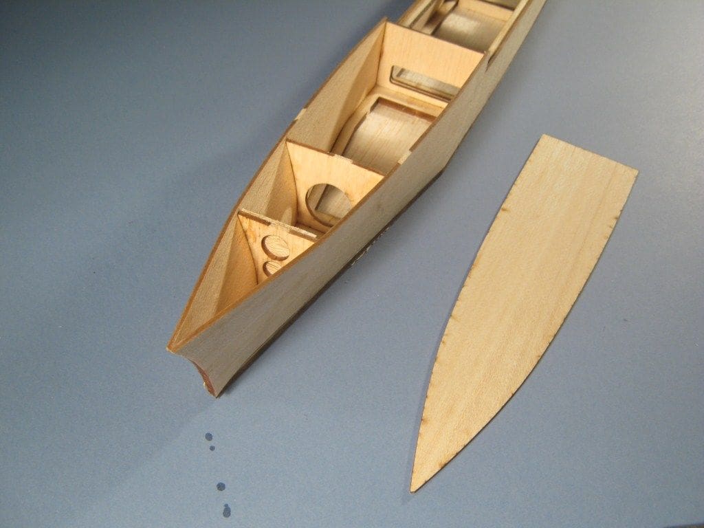

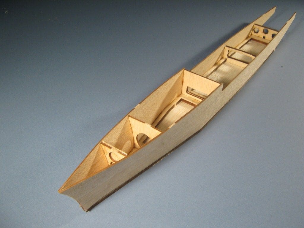

Step one is to cut out the base piece, Photo 1. Next, the inner base goes in place, Photos 2 and 3. If you are not using the laser cut parts you can simply line the edge of the outer base piece with 1/4 inch square balsa strip rather than the complete panel. This last picture (Photo 3) also shows the bulkheads prior to fitting. Note that B3 has a secondary backing piece designated B3A that is designed to support the main deck. Fit B3A to B3 together and glue. If you are using the laser cut bulkheads use the matching lightening holes to line the two parts up correctly. If not, then please refer to the plans.
Prior to installing the bulkheads, please note that the laser cut bulkhead B1 has lightning holes which tend to weaken it excessively. I recommend you reinforce B1 with a doublers of 1/8 inch balsa at this point.
Now go ahead and erect the bulkheads. Make sure you set them square and vertical, Photo 4. It is a good idea to chamfer the edges of the bulkheads forward and aft to match the curvature of the hull in those areas so as to create a good jointing surface for the side skins.

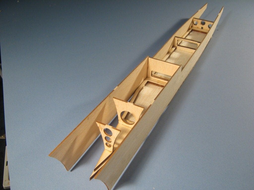

Fitting the hull sides and pulling them together is the only slightly awkward bit in the whole model. Start by sitting one hull side (either port or starboard) in place on the step created around the flat bottom by the hull base inner piece. Adjust so that it is square and properly seated and pin in place. Obviously, the rear section of each side is free and extends past the rear of the flat bottom. Do likewise with the other side so they both match perfectly. Once happy, loosen the sides on the pins slightly, inject thick superglue into the joints and push together quickly and firmly. You could use PVA or epoxy glue, but superglue (Zap-A-Gap in this case) certainly speeds construction. Photo 5 has both sides pulled in against the aft bulkheads (where the hull sides are parallel) and glued in place.
Now for the tricky but satisfying bit. Working from amidships, simultaneously and progressively pull the sides in together and glue them against the hull base and bulkheads working towards the bows. The objective of this is to establish a flare in the bow as you work forward. You can do this task easily by hand, cementing with superglue as you move forward. Keep working at it until you get to the stem. At this point you will now have a pointy box with some flare at the bow end, Photo 6.

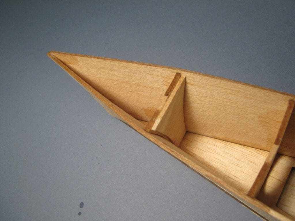

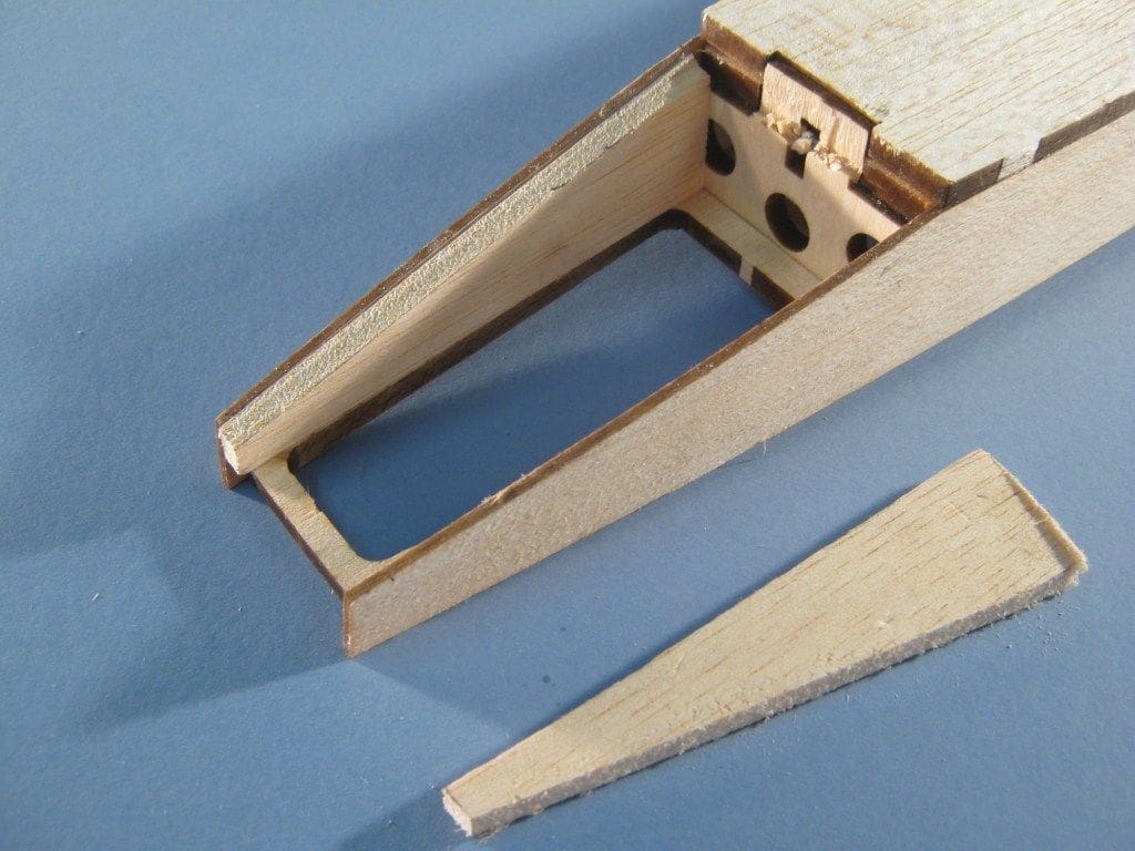

It is advisable to reinforce inside the bow joint with a little 3/4oz fibreglass cloth set into place with some superglue or epoxy. This is not critical but is advisable and Photo 7 is a close-up of the bow section interior.
Once the sides are secure the main deck support piece, which fits behind the break of the forecastle, can be fitted, Photos 8 and 9. This fits on top of the bulkheads and the sides at the stern are pulled inwards and glued to it. You will note that this piece is 1/4 inch down from the top edge, thus leaving a convenient ledge on to which the main deck will eventually fit. If not using the laser cut parts, this ledge could be created by just gluing 1/4 inch square balsa strip around the hull sides 1/4 inch below their top edges.

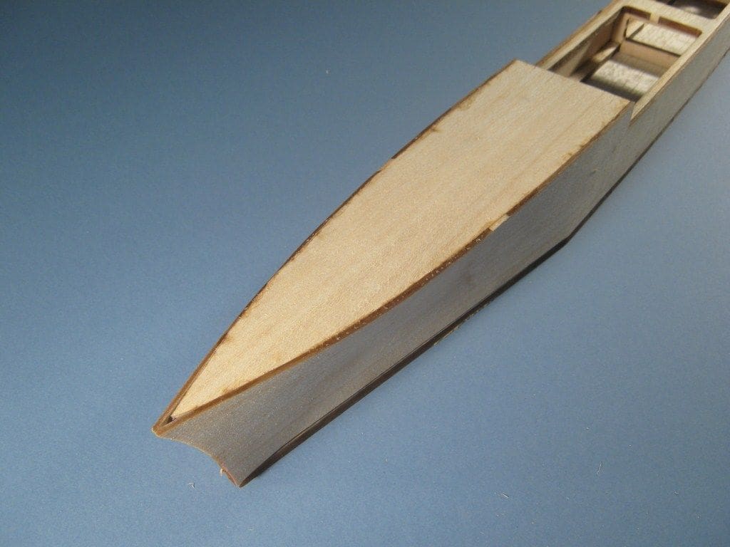

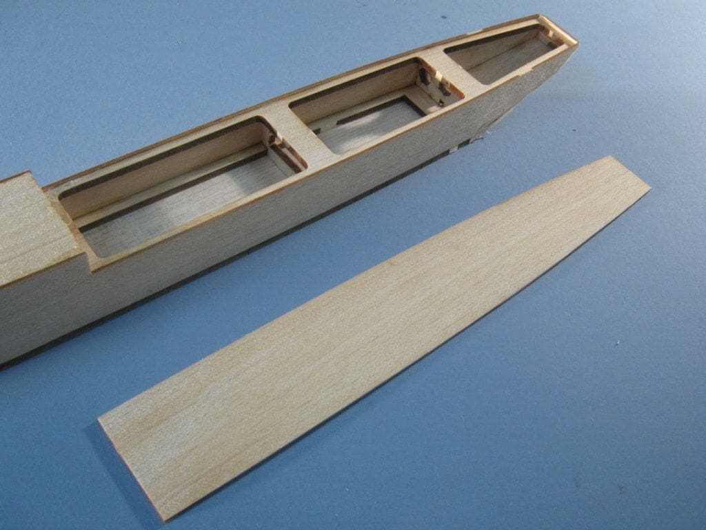

Returning to the forward part of the hull and it is now time to install the fore deck, Photo 10. There is no sub-deck frame for this as it is not removable and it will just need a little chamfering to obtain a snug fit over the bulkheads and inside the side pieces, Photo 11. Alternatively, if not using the laser cut parts, you could use the inverted hull as a template to cut out a fore deck to fit. Since it fits inside the hull rather than on top of it, all you would need to do is to take off an 1/8 inch strip around the marked edge so the part hopefully snuggly fits into the top of the hull nicely. Once a good fit is obtained, it may be glued in place with either thick superglue, PVA or epoxy. As I wrote earlier, this part of the decking is not removable. It is therefore essential to ensure that all the internal joints of the hull sides and bottom are sound. Therefore a fillet of epoxy glue or fibreglass resin inside will do no harm. The bulkheads are not all solid, so there is ventilation should any water get inside and with deft fingers and brush, applying the strengthening fillet to the inside of the joints is not that difficult. As with Glynn Guest’s models and his recommendations, it is best to leave the inside unpainted so the wood can breath.

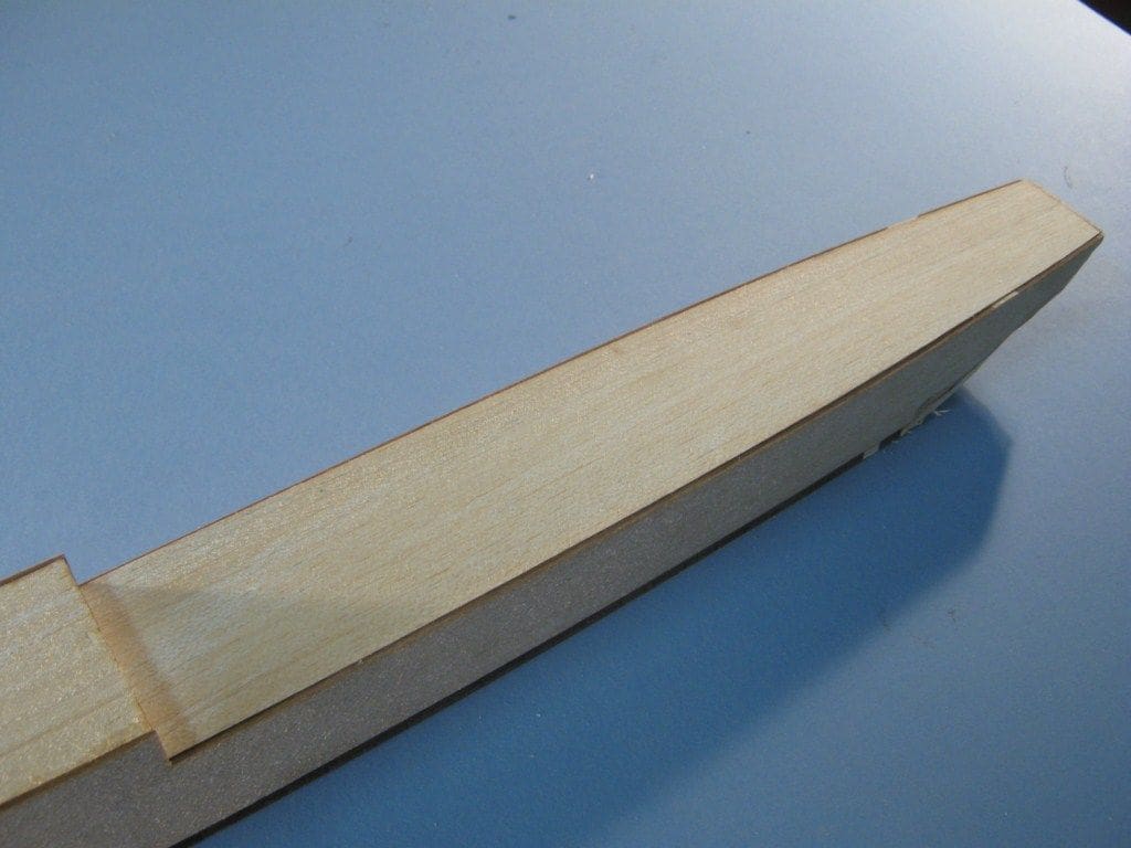

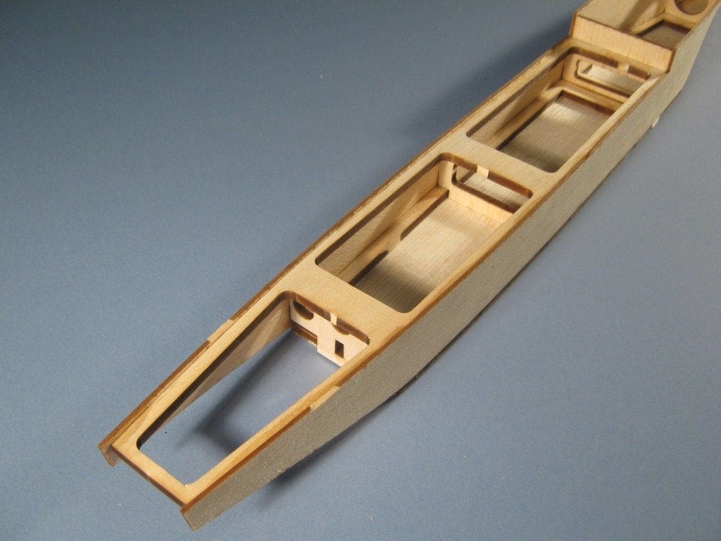

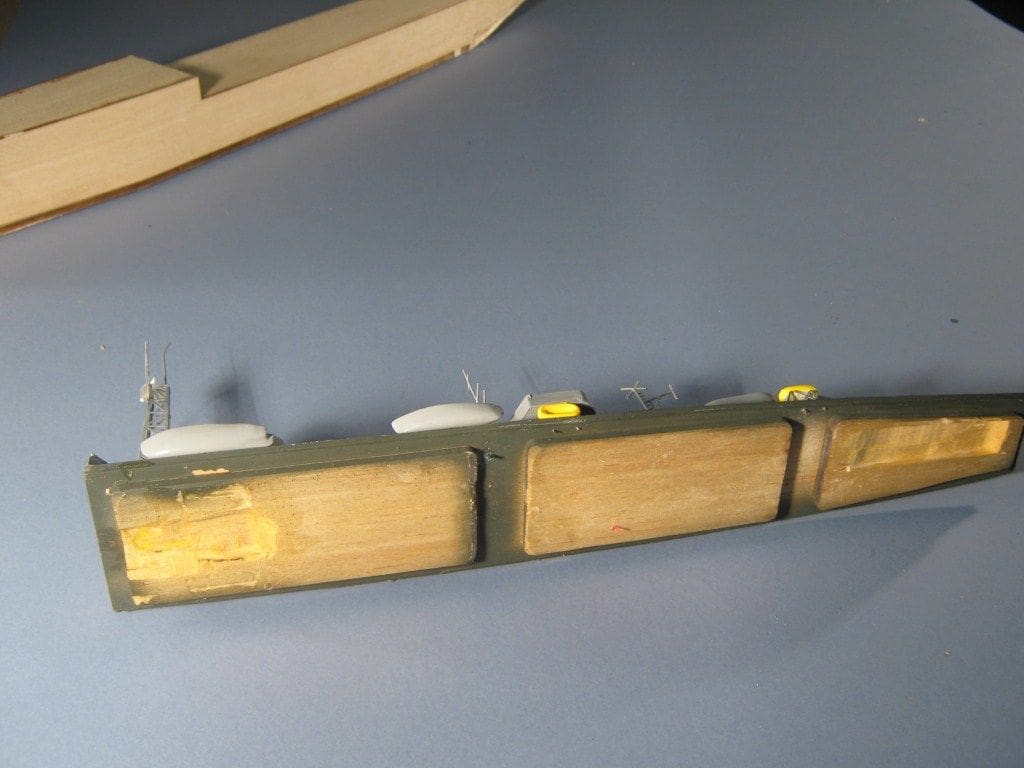

The final part of hull construction phase is to fit the main deck. It is NOT glued in place and is removable as a complete unit, again in the style of many of Glynn’s models. The laser cut deck should fit (just drop!) into place with minimal sanding or trimming, Photo 15, but if you are building from scratch without the laser cut parts, then again use the inverted hull as a template to mark out the deck edge line on a suitable piece of balsa. Please note then that the exterior dimensions will need to be reduced by the thickness of the hull sides. Photo 16 is of the main deck now slid into position.
On the model constructed from laser cut parts, the deck is further located by balsa blanks glued to the underside of it which fit in the large access holes in the sub-deck support. To fit these, fill the hull with scrunched up paper such that this paper supports the blanks. Apply glue to the blanks and then press the deck down in place onto them and leave to dry. When the deck is later removed after a judicious interval it should have the blanks attached to the underside of the deck in the correct place. It may be that some of the paper has adhered to the balsa wood – this is no problem as it can be easily sanded away. Photo 17 shows these deck locating blanks in place. I had later to do a little surgical trimming to accommodate some of the in internal equipment. This photo is also a good clue to the fact that I built two of these models!

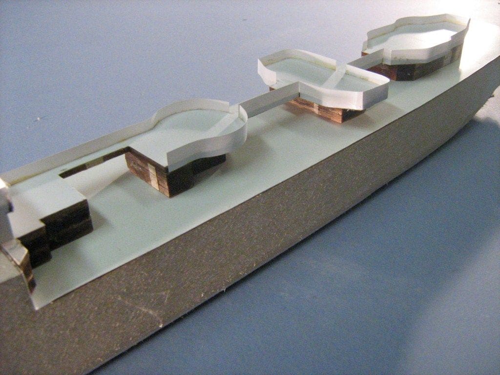

Cue the card!
This sort of model boat building benefits from the use of thin glossy card of the type used in birthday cards and brochure holders. It can be applied using contact adhesive and is useful for decks and superstructure where we want to cover the relatively soft balsa and also for creating a simulated steel deck.
The original Glynn Guest HMS Lagos, which inspired HMS Embling, had strips of card glued lengthways along the hull to give the impression of a welded steel hull. This has not been done on HMS Embling, but the fore deck was laminated with a single piece of card along with the main deck.
The easy way to do this, is to lay an overly wide piece of card over the fore deck and main deck (inserted into the hull). Invert the hull onto a flat surface and trim the card flush with the hull sides using a sharp knife, being careful not to cut into the hull. This should mean that not only do the balsa decks sit within the hull (the main deck is removable), but the overlay will then fit over the hull sides, thus hopefully creating another barrier to water ingress. Photo 18 shows the deck card overlay in place as well as the use of card to make up lightweight superstructure gun platforms etc.
These card surfaces can be made more durable and resilient by coating them with thinned two part epoxy resin (as used on model aircraft wooden surfaces). Using 30% methylated spirits as a thinning agent after you have mixed up the epoxy will ensure it soaks well into the card.
Superstructure and fittings

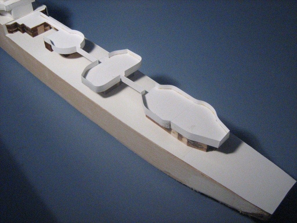

The superstructure is comprised of built up blocks made from balsa which are then laminated in card. Many of these components were cut out as blanks by laser, but if you are scratch building, a sharp knife and a good fine saw will do the job just as well. Do not use anything other than balsa and card for the superstructure or top weight will be increased unnecessarily and possibly effect the model’s stability. Photo 19 is of the main deck superstructure blocks with card used for their gun platforms. The balsa appears to be dark brown and this is because of the laser cutting process which ‘burns’ the edges slightly.

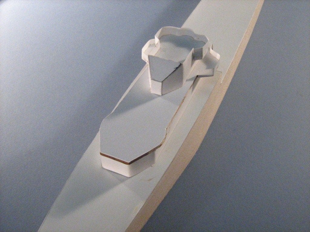

Photo 20 is of the bridge and B turret platform. Again, the former is from balsa sections which are then veneered with card.

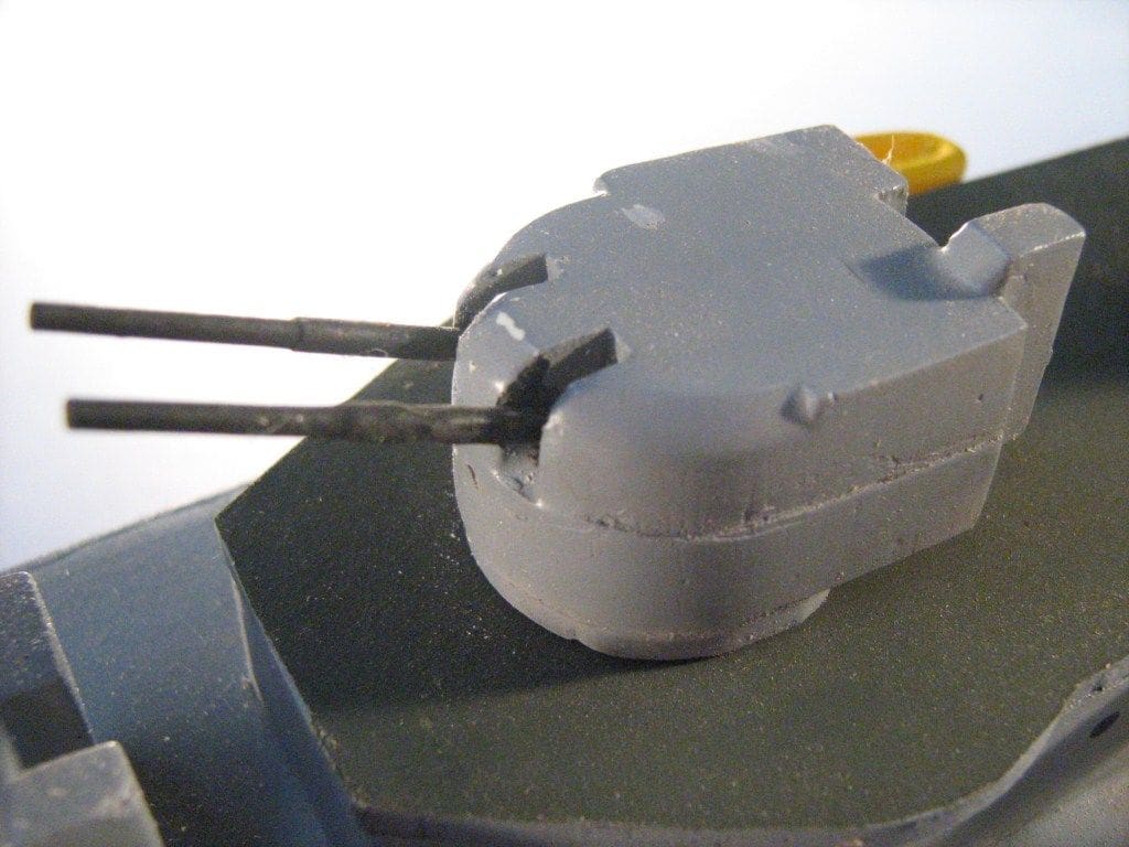

The turrets for the main armament are shaped balsa blocks, Photo 21, with the gun barrels of plastic tube, but lightweight brass or aluminium will do the trick just as well. A finishing coat of epoxy resin and then warship grey and they look menacing enough, Photo 22. The ship’s boats are carved from balsa and carried by davits formed from plastic coated steel wire. The bulwarks are all from card strip as mentioned earlier, but an alternative might be very thin styrene sheet.

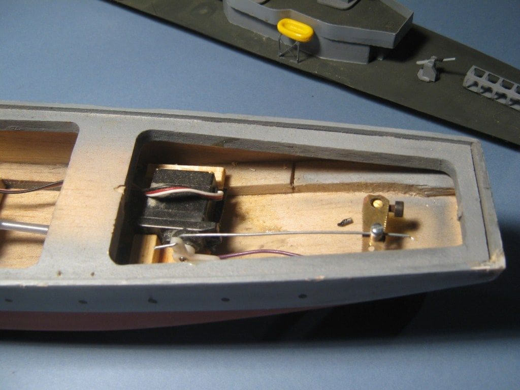

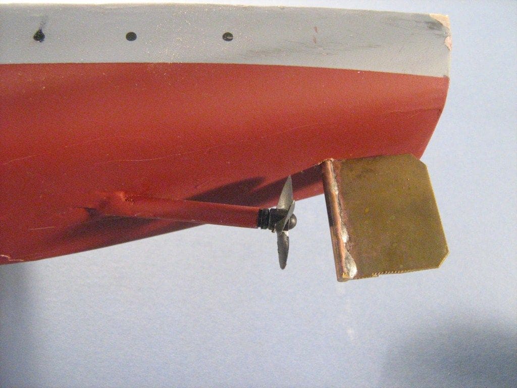

The rudder is a simple home made unit, but if you are not too confident on soldering, there are a number of basic commercial versions on the market. What is particularly important is that the rudder post is set vertical, both fore and aft and port to starboard, Photo 23. Ideally, the rudder blade should not extend past the extremity of the transom. However, and it is a ‘big however’, please ensure that the rudder blade and its shaft can be unshipped from the model so that the propshaft can be easily withdrawn.
The propshaft and tube is any conveniently available commercial product. A lightweight type is perfectly adequate for this model. Ideally, the rear of the propeller boss should be about 1/4 inch in front of the forward edge of the rudder blade. The propeller should be able to rotate with adequate, but not excessive, clearance to the hull. Having the propshaft as close to the hull bottom as possible, in my experience helps avoid excessive hull rolling.

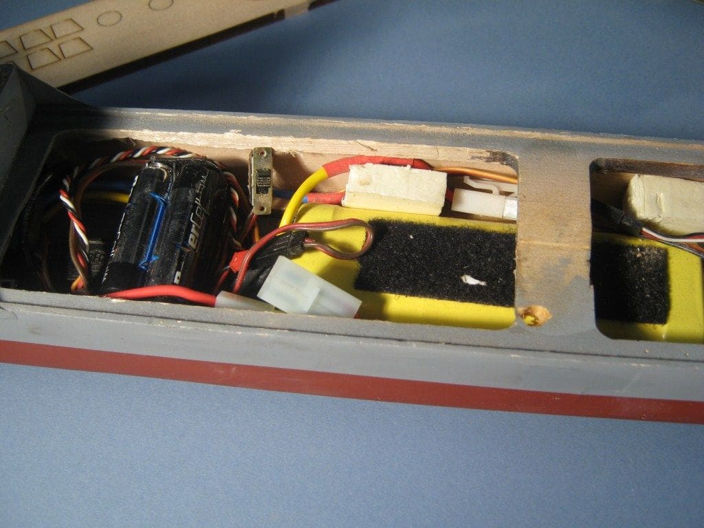

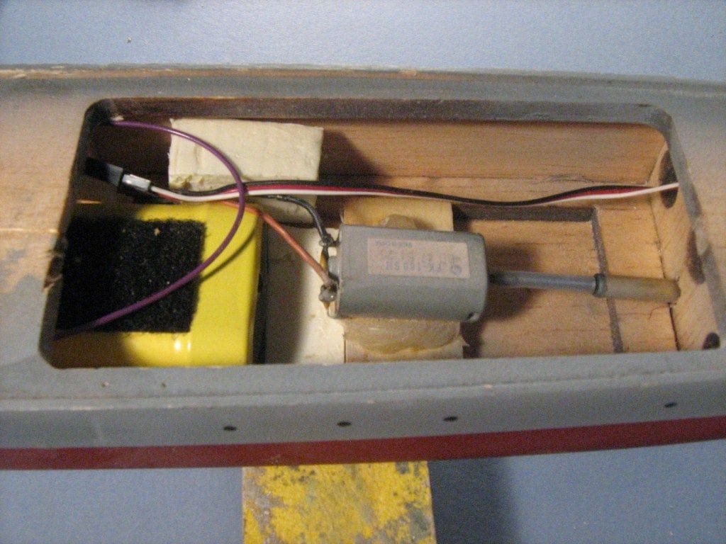

The motor I used is a small and old 180 type, Photo 24. Actually any current 280 or 380 type low current drain electric motor will also do, but just choose something small since the model is lightweight and does not need to be overpowered. In Europe, motors if they have the CE sticker should already be suppressed. If it is not, then there is a fair chance the motor will interfere with the receiver. Suitable suppressor packs are readily available at low cost and these should be fitted to the motor.
For motor speed control there are various units that will do the job, many of which are advertised in this magazine. A 15 amp electronic speed controller will be more than adequate, but a smaller version will be fine with this type of low power motor. I used an older non-BEC (Battery Eliminator Circuit) type, so had to install a separate receiver power pack for the r/c gear. The drive motor is powered by a standard 7.2 volt ‘buggy pack’. This is all a bit of a squeeze, but it does fit, Photo 25. Photo 26 is of the rudder linkage arrangement – there is nothing unusual about that except that a standard size servo will have to be fitted on its side. Having a one piece main deck does enable easy access and Photo 27 is an overhead view of the model.

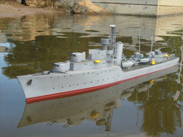

Over the years I have used different finishing methods on the models I have built. What have I learnt? Well I think the best finish and the most durable comes from using the two part epoxy coating resin of the type used for sealing wooden surfaces on model aircraft. It is light, tough, sandable and waterproof. In particular, it seems to sand very well if thinned with 30% methylated spirits which also increases the penetration of the epoxy into the balsa wood.
The final colour coats are your choice – airbrushing is handy when endeavouring to obtain a nice even finish and aerosol cans are even easier. The colours used here were home mixed and conform to the ‘looks right’ principle rather than being the absolutely correct colour scheme. I don’t think the real vessel had a green deck, but the contrast makes for a more interesting looking model.

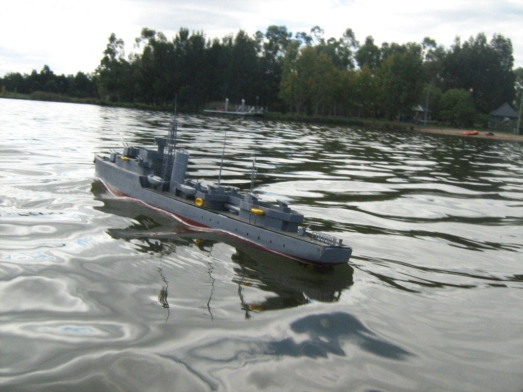

On the Water

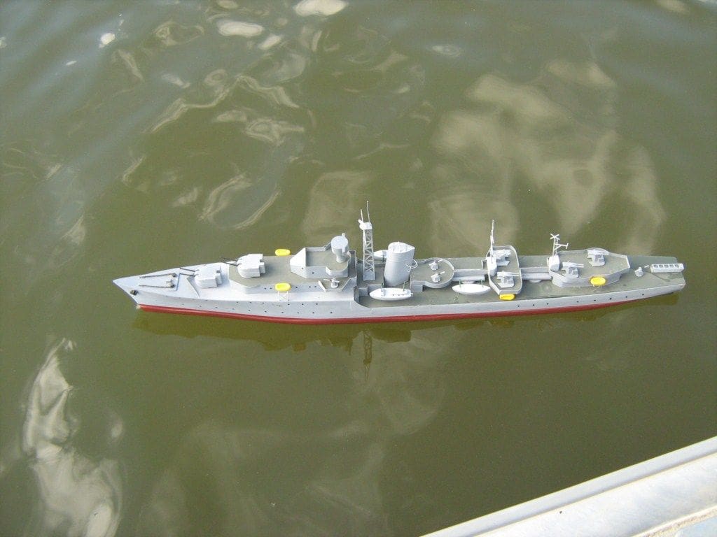

This sort of model is fun and quick to build, but they are at their best on water. Despite the relatively small power plant, HMS Embling slips along at a good speed on about one third throttle.
Some expect that a model boat should handle like a motor car, but this is not generally true. Water is a mobile fluid and the wind wants to swing your model around. Stopping when applying reverse thrust is excellent, although the stern swings with the paddle wheel effect as do all single screw models, but you can use this to your advantage when berthing to draw the hull alongside the wharf.
Sea keeping is good, even in relatively boisterous conditions. A little water is shipped at times, however precious little seems to penetrate below decks. Endurance with the 7.2v power pack is at least 30 minutes or more depending on how you drive the model.
