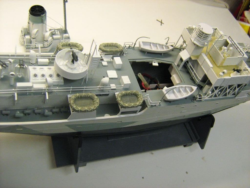

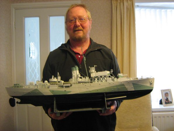

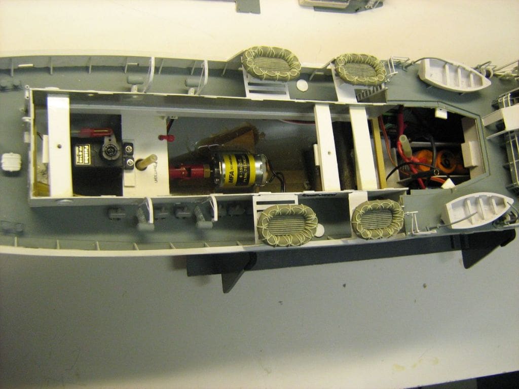

The Flower class corvette is of course from the Revell plastic kit. I have built this model once before and it sailed beautifully for a number of years until it rammed a landing stage and all but disintegrated which was due to a radio problem, honest! The new version is almost finished and will soon be sailing. I have made two sections of the deck removable. Each is held down by two bolts. I made four rectangular blocks of several laminations of 2mm styrene card which were then drilled to accept the bolts. The nuts were then put on the bolts for half a dozen turns and the bolt heated with a soldering iron until the nut melted into the plastic and was level with the bottom of the block. Once cooled, a further lamination with a bolt size hole in it was added so that the nut could not escape. These blocks were then glued either under the deck or under the cross pieces. With a bit of Vaseline around the edges, the removable sections are completely waterproof. Drive motor is an MFA 385 running on 6 volts via an Mtroniks Viper Marine 15 esc with a homemade brass three bladed propeller with almost no pitch and bath tests indicate all should be okay. This is not a model of any specific vessel as she is meant to represent a typical war weary corvette and is named Blue Moon. Anyway I have found that if you pick on a specific ship at a specific time there is always some ‘clever clogs’ who will tell you that this ship was not fitted with the left hand thread widgets during the period modelled!

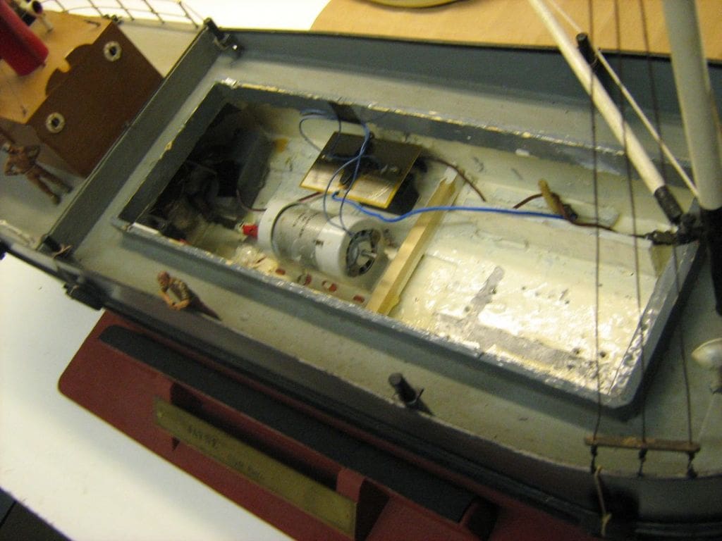

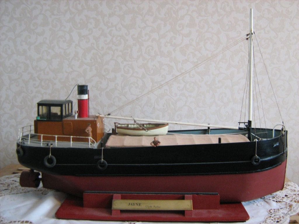

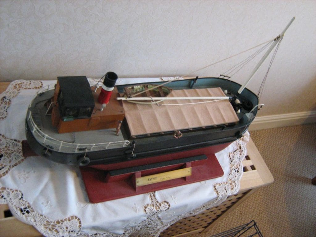

Next is Jayne, my good old faithful Clyde Puffer. Originally started in 1972, she is all balsa and ply. I drew the plans myself and it is based on several different ships. The model is 30 inches long by 8 inches beam. The bow and stern sections are bread and butter with a box section middle. The model was first sailed as a free running craft powered by a D.C. Merlin 0.75cc diesel engine with the exhaust directed up the funnel, but by 1975 was converted to electric with two channel r/c. That motor was later replaced with a geared Decaperm controlled by a Bob’s Board wiper type controller and this is exactly how she still operates.
Eagle eyed readers will notice the Kort nozzle at the stern. Soon after joining Tynemouth MBC I entered the puffer, fitted with the normal rudder, in one of the steering competitions. Needless to say she was impossible to control going astern and was soundly thrashed by several small fishing boats fitted with Kort nozzles. I was discussing this with Bill Thompson and told him that I might build such a small fishing boat, but his reply was pure Thompsonesque. He asked if I had read the Para Handy books. In any of these, was Para ever asked to reverse the Vital Spark in a dead straight line between several markers for at least six times the length of the vessel? No, he wasn’t, so the answer was simple. You are asking the model to do something the real one cannot do. To remedy that, simply install a longer propeller shaft and fit a Kort nozzle. As a result she then sailed perfectly, although no longer strictly pro-typical. She can sail as gently as the full size prototype but when necessary she can sail arrow straight in reverse and spin around almost in her own length. I think this is the first insight I had into Bill’s extraordinary personality.

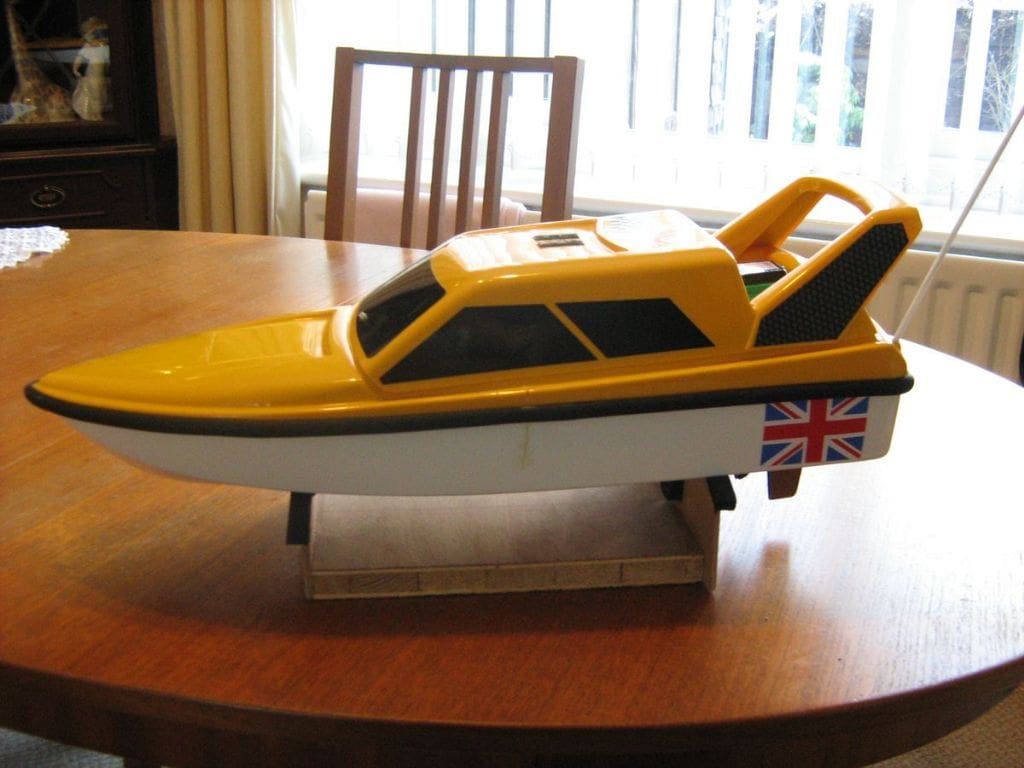

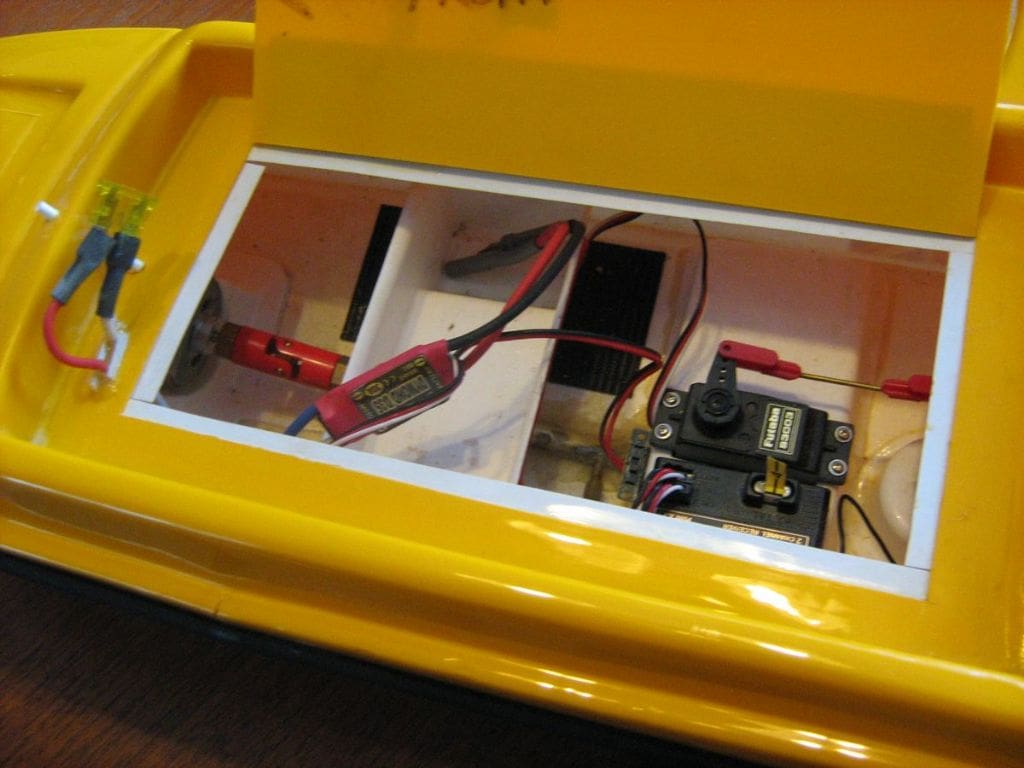

Last is a Club 500. She is a bog standard kit fitted with the usual 540 motor running on 7.2 volts with a standard 30 Amp aircraft esc which is forwards only. The hatch is hinged with Duck tape and the other three edges are sealed with electrical insulating tape. An external 20 amp car type fuse on spade terminals is connected prior to fitting the cabin top ready for running. The battery tray is held in place with Velcro and can be moved forwards and backwards a little depending on how rough the water is. This can have a significant effect on performance.
