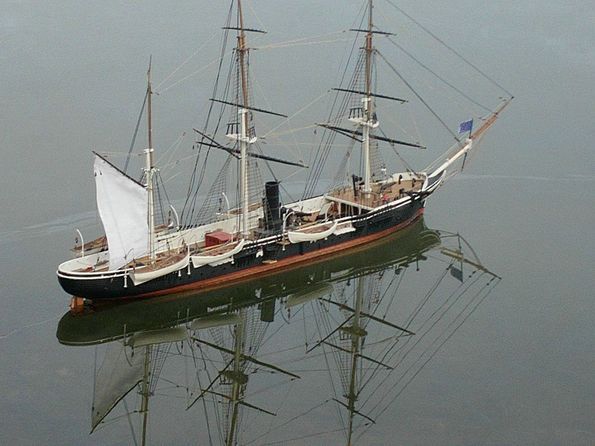

When ready to sail, USS Kearsarge only needs the on/off switches to be activated and away she goes. In operation she has performed very well, being nice and stable with a decent but not excessive turn of speed. The motor does not need excessive rpm to provide adequate thrust and 3 volts is about right. The sail was used more for effect than anything else but does help stabilise the model. (Running motors on lower voltages than normal to achieve a scale performance, is something that Glynn Guest has positively commented on within this magazine – Editor).
Conclusion and the future
In the end the model turned out well although I have to admit not as planned. The fundamental problem was lack of interior vertical height and volume to accommodate a suitable boiler. I am not saying it is impossible to fit a steam plant as I was close to success and constructing a third boiler may have been the answer, but the failure of the second boiler, did rather put me off!
