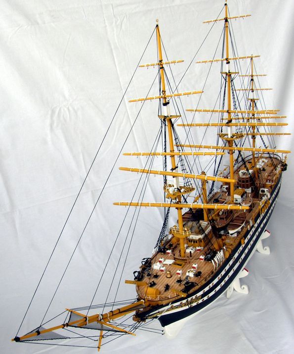

TERRY LAWRENCE reviews the Panart kit – Part One
As the current Euro/£ exchange rate has sunk to virtual parity, so the Mantua Model Group have increased the U.K. prices of their products. This kit cost me serious money, approx. £600, so it ought to be very good indeed. Panart are part of the Mantua Model Group.
Because this is the Panart flagship, it is also their most expensive, and they offer an alternative to the full kit, namely a sequence of eight mini-kits to spread the cost over the build time. There is a ninth kit which is an extra for both options, and that is a suit of sails. The eight kits are about £50 dearer than the complete 1/84 scale kit, presumably because of the cost of the packaging and an extra pick and pack line at Roverbella where Panart are based.

For the build, I will follow, within reason, the sequences shown in the instruction books. You may notice, as the review proceeds, that I have made a few minor changes as a matter of practicality. Purists should ignore any variations from true scale. However, the manufacturers have created quite a few variations themselves, as comparisons between details in the instruction books and the box photography will show.
