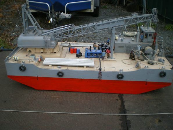

Work started on this model in January 2008 with the usual rough sketch drawing, but the idea had been brewing for months before this date. I could not find much information on this type of vessel, so it was a bit of: ‘Make a start and see how it goes’ method. Probably not the best way to approach a project of this size, but I had very few alternatives, as I just wanted to get on with it. If I messed it up, then it would go in the scrap bin, but I wanted to see if I could make something worthwhile from this idea of a working crane barge.
Getting started
There are of course many full size examples of these barges in use today around the globe. Some are able to lift just a few tons, but there are much bigger versions that can lift thousands of tons. This example is a 20 ton lift version, quite small really, but typical of this type of barge in use today.
I had drawn up a list of some of the things that I thought could be accommodated in this project. Starting off with the all important large flat deck, a big winch, a pump or generator and the very large crane were of course essential. I had built a working crane before which was installed on my dredger. This worked well but had been a lot of work due mainly to its small size, but this time I was lucky that before I actually started building this much larger crane, I came across a model of a large radio controlled tracked crane at a model engineering show. I thought it was cheap as it had also been reduced in price, so I bought it. I considered that if I was just able to use the radio gear and winches then I was saving myself a lot of time and expense. However all the under parts had to be cut away just to remove the tracks and that involved cutting a lot of the crane structure as well. I finished up after a lot of cutting and shaping with a flat underside to the main body which could be attached to the deck on a completely new under frame.
The plastic cab and some of the other ancillary bits were removed and the many holes that I had created were made good with either plastic card or fibreglass, Photo 1. I think on later reflection it might have been easier to scrap the original crane body and make a completely new one, but hindsight is a wonderful thing!

If you look at photos of working examples, barges do not seem to be tidy craft and there is often a lot of clutter on the deck. By that I mean ropes, drums, chains, pipes and timber etc all over the place, Photo 4. On the deck are winches and pumps with anchor handling equipment at both ends of the barge with a main towing bridle at the bows (although both ends of the hull are similar in shape). The crane of course is the main feature and is mounted aft. On each side of the deck are bollards and plenty of tyre fenders plus the usual guard rails. At the opposite end of the deck to the crane mounting is a large heavy tubular structure for supporting the crane jib when stowed, Photo 5.
At the bow end of the barge on the port side is the crew accommodation block and engine room, on top of which is housed the small bridge with the crane controls. Aft of the bridge are stowed the lifeboat and a liferaft, Photo 6. On top of the bridge is a small mast for the radar, aerials and navigation lights.

There is no fancy paint work on this model as it is intended to be a working model and not a museum piece. The hull is red below the waterline and grey above. In fact the whole thing is meant to look pretty scruffy just like the full size barges. Two 6v batteries power the lights, pumps and motors. I have yet to find out how long they will last, but this will probably all depend on how much use the crane gets. Photo 10 is of the model on display at the Midlands Model Engineering Exhibition, 2009.
