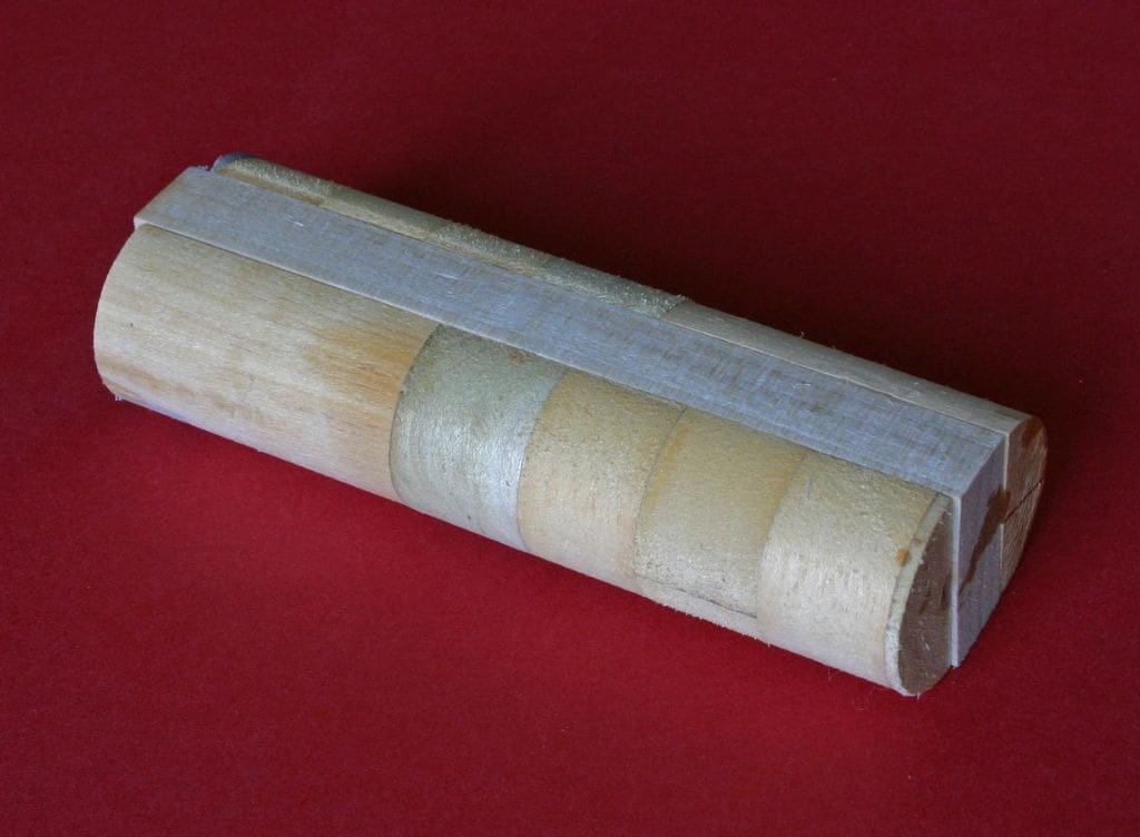

The first thing to make is the former. The overall dimension will be the final size of the job minus the total thickness of the laminate. I usually calculate the size of the former, which will also be the diameter of the rounded ends of course and make up a cylinder of this size. I then cut this in half lengthways. I find the best way is to use my band-saw with a ‘lay’ set up. Otherwise careful marking out and consequent sawing will be required.
These two halves should be identical. They are then glued to a central rectangular block to give you, in section, the interior shape of the funnel, Fig. 1.

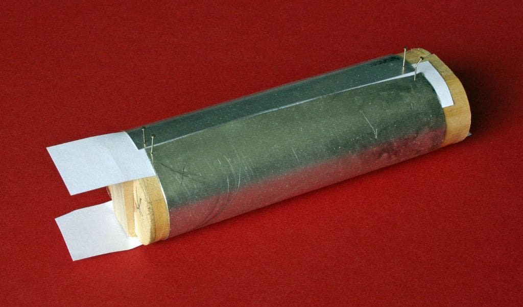

I started by making the first layer of the laminate of litho plate. I cut out a piece of litho plate and fitted it to the former. I usually butt the ends as this first layer will be held in position by the final layer. Fig. 2 shows this first layer in place held with four half inch dressmaking pins. Note also the strips of paper. These have two functions: to prevent any glue penetrating the butt joint and gluing the whole assembly to the former and to provide a bit of extra clearance. Pulling these strips out first usually enables the former to be removed easily.

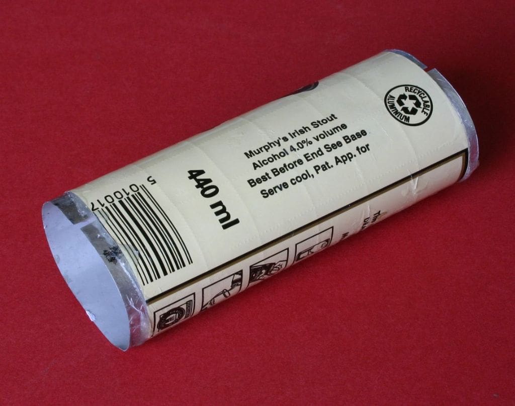

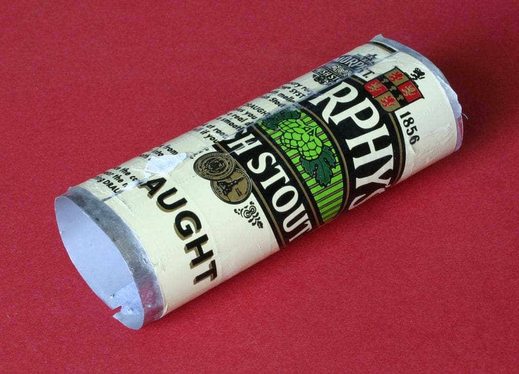

The top layer as can be seen from Figs. 3 and 4 was made from a beer can. I just cut the two ends out leaving a curly, roughly rectangular piece with some built-in curve already. Although, unfortunately it does not show on the pictures, I had scored the back of the sheet with an old alarm clock gear to simulate riveting. You need to find a suitably soft piece of card to lay the sheet on to allow the pounce wheel, for that is what your alarm clock gear wheel is, to do its job. The teeth of the wheel also need attention otherwise you get little lines instead of dots. The teeth need filing slightly each side and the wheel has to be mounted on a suitable handle. Otherwise the sheet needs to be fitted round the former to give a close butt joint. I usually arrange this on the flat opposite the butt in the first layer. However, I have in the past arranged the joint on the curved ends where it can be hidden behind a steam pipe.
I always use Araldite for this job as you need the rigidity of the glue line to add strength. If you make the first layer long enough you can keep the four pins in position when fitting the final layer which helps a lot.

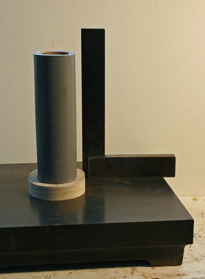

Fig. 5 shows the funnel assembly being tested for squareness. The top ring, described above, can just be seen at the top of the funnel. Finally the inside of the funnel is painted matt black including any fixing screws as it makes the exhibition judges happier!
