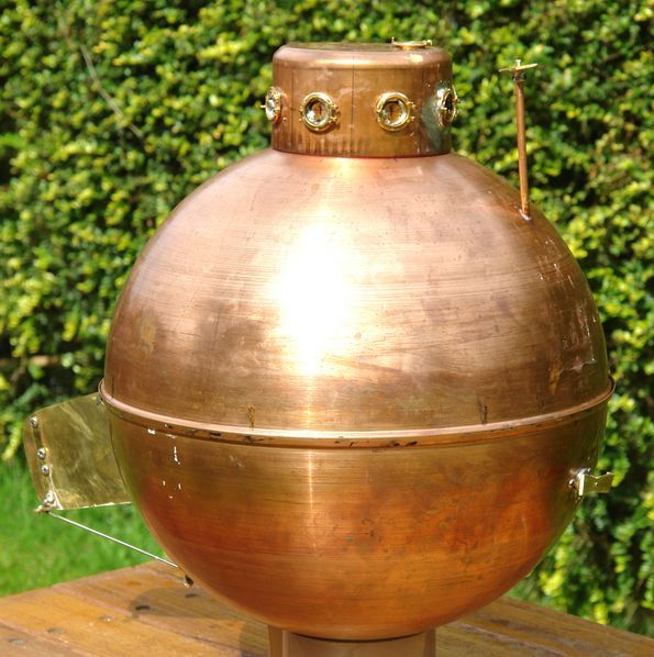

The reason for the need to waterproof servos is that in this working model of the Turtle submersible, they could not go inside a waterproof compartment – there just isn’t enough room!
This topic of conversation came up for discussion whilst I was chatting with some of the lads at Greenock Model Yacht and Power Boat Club. Some of the members who are yachtsmen had problems on occasion with damaged winches caused by pond water getting on to the circuit board, shorting the electronics and making the servo winch redundant, usually in the middle of the pond.
At this time I was building ‘The first submarine in the world’, Turtle of 1776, and this was relevant to me as I didn’t have enough room in the WTC (Water Tight Container) for the three motors, speed controllers and servos plus the ballast system and I thought I had an insurmountable problem.
