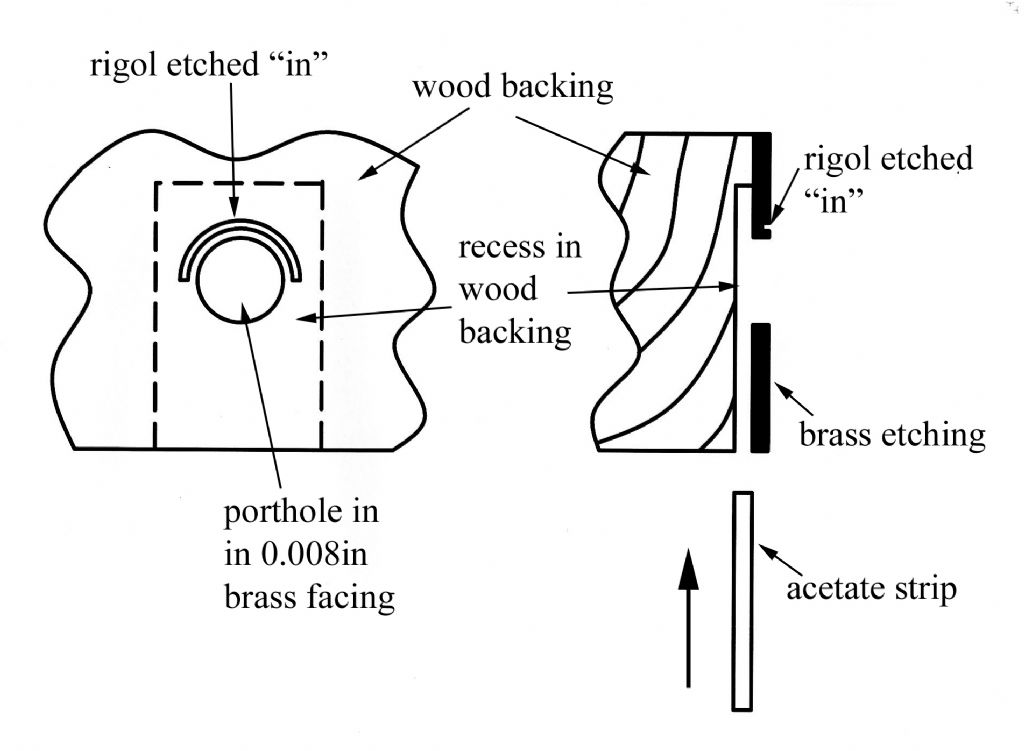

The more I thought about it the more attractive the idea became. Just think of the advantages. The computer could be used to mark out all the detail, ports, rigols, hatches, etc. All this with much greater accuracy than I could achieve on the bench even on a good day! Getting a finish on the etching would be a lot easier than the wood. The ports on the hull were holes in the brass etching of course, but instead of filling these with Perspex slugs I cut a recess in the wood backing (onto which the etching was glued) as shown in Fig. 1.
Fig 1
This was to house a piece of transparent acetate sheet, the back of which, was painted a suitable grey. You will note that the recess is cut from the bottom and therefore the acetate is prevented from falling out by the model being screwed to its baseboard. During the extensive spraying of the hull sides (comprising not only the basic black but also the white boot topping and the red anti-fouling below) a piece of cardboard was slipped into the recess to prevent the wood backing becoming black and showing through the acetate. Probably not really necessary, but a good precaution possibly saving a rotten clean up job afterwards.

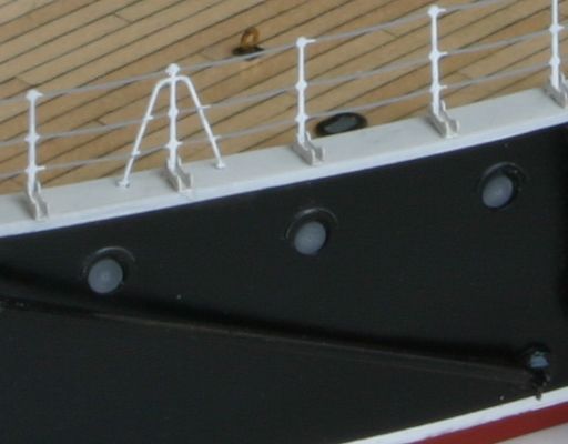

One of the sources of any inspiration I get has always been that marvellous book by John Leather called; ‘World Warships in Review 1860-1960’ containing photos by Beken of Cowes. The picture on the dust jacket of HMS Colossus long teased me; such an ugly ship but she is handsome! I finally decided to build her using the same methods as on HMS Camperdown. However Colossus has a clipper stern and not the canoe stern of Camperdown. This meant the method of using pieces of acetate sheet to glaze the ports could not be used. Fitting the acetate bit was the difficulty, so why not get rid of it, but how? Further thought provided the answer, paint the backing wood at the site of the port, first making sure the surface was smooth enough, with your selected grey and then put a gloss on it. I managed to find a bottle of Tamiya clear gloss and a test showed the idea to be good and very simple and time saving, Fig. 2.
