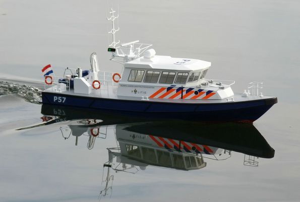

JOHN ELLIOTT reviews the Deans Marine R.A.M.B. model

Photo 1 is of what is in the large box. The main item is a moulded high impact styrene hull with the propshafts, rudders and linkages already installed. It is pre-painted red below the waterline, blue above and the deck is grey, all in a satin/semi-gloss finish with the rubbing strakes picked out in black. The cabin has been pre-assembled, painted white and all the glazing and window frames are pre-fitted. Brass tube and rod have been used for the mast and railings, which have been bent to shape, soldered and painted, The separate top mast even comes in its own protective box. Other items include a Hiab crane, a Sea Raider inflatable, life raft, life belts, other fittings, stainless steel propshafts and brass propellers. Also enclosed is a sheet of vinyl decals (Stickers are provided for either P47 or P57), motor mounts and battery trays along with an assembly guide that details the construction sequence, adhesives required and the parts to motorise it.

On the Water
Prior to going to the lake there was the inevitable bath test. Would it float? Well, yes it did and approx. 1kg of ballast was required amidships and 0.5kg at the stern to bring the model to the painted waterline, or so it appeared, but more on this later. Anyway off to the Brentwood MY&PBC lake with your Editor in tow for a test session.
The instructions suggest two scenarios, one for optimum running time and one for speed. The first uses the propellers supplied but with geared motors and the second uses smaller propellers but ungeared. Now as it was not practical to change the direct drive motors for geared units, the test was done with different size propellers.
After the usual checks and with the larger propellers on direct drive motors, off she went and somewhat disappointingly was smooth running, but not very quick. After a few minutes sailing it was brought back to the bank and checked. The battery was hot and was already getting close to ‘dumping’. On the other hand, the motors rated for 6 to 12v were not particularly warm at all.
The propellers were changed for smaller versions and the model re-launched. This time there was an improved speed performance but still not as much as was expected. It seemed to be biting into the water instead of the bows lifting. So we removed the amidships ballast and tried again. There was a further noticeable performance improvement, but the stern was now digging deeper into the water. So, out of the water again and the stern ballast was removed. It now sat very slightly above the waterline with a bit more red bottom showing at the bows, but the performance improvement was very noticeable from the first run and now judged to be satisfactory.
Conclusion
For best performance no ballast is necessary other than to correct a list (if any) and the smaller propellers on direct drive from the Kestrel motors are worth the additional cost. As the motors were only running on 7.2v it follows that an 8.4v or 9.6v battery should give more speed and longer running time but that is a matter of choice. The model was a pleasure to build and looks impressive on the water. This type of kit may well suit those that don’t have workshop facilities or sufficient free time but still want to have some modelling input to their models. Deans Marine have always prided themselves on customer service and I cannot fault them with this model which fills a useful niche in the market.
