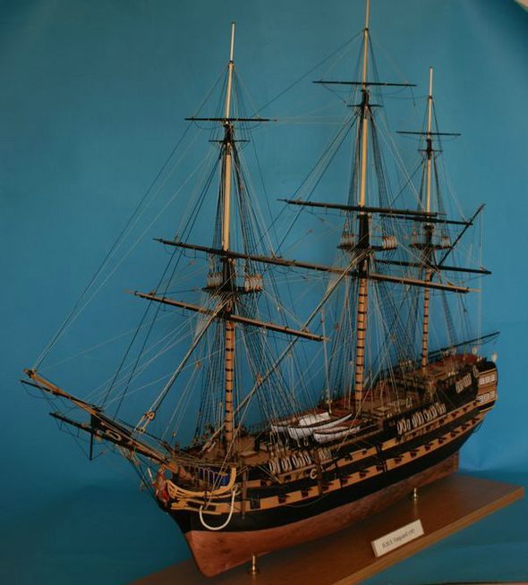

Conclusions
This is arguably the most complex kit of its type that I have come across, but I feel that the designer has met the challenge well and the result is superb. Okay, there were one or two niggles, bits of misplaced or missing information and one major problem that has since been put right, but on the whole it is a package that any serious model maker would be pleased to build. This is a first rate kit for a third rate ship.
The misplaced and missing detail largely related to the running rigging and identification of belaying points, and a thorough study of the drawings was found necessary to sort matters out. The major problem was with the stern fascia casting being undersize, apparently due to excessive contraction, but this has now been put to rights by the provision of a new resin cast part, which is available FOC on application to the distributor, or there is a revised instruction sheet showing how to convert the original casting.
I feel that I should comment on the use of MDF for the core structural parts. I have to admit that I had my doubts initially as to the suitability of the material. However, I quickly found that it was superior to ply in both stability and quality. I discovered too that it was easier to work providing that sharp tools were used. This was particularly apparent when chamfering and bevelling the edges of the bulkhead parts.
The etched brass parts were of the highest quality and the standard of laser cutting on wooden parts was excellent throughout.
H.M.S. Vanguard is a major project for any model maker and a thoroughly nice job to boot. At the time of writing this review, the recommended retail price of the kit, exacerbated by the current Euro/Sterling exchange rate, is around £800, but to keep things in perspective, you are talking in terms of potentially eighteen months enjoyable work, even longer if you rig sails. Above all, you are getting quality in both materials and design.
