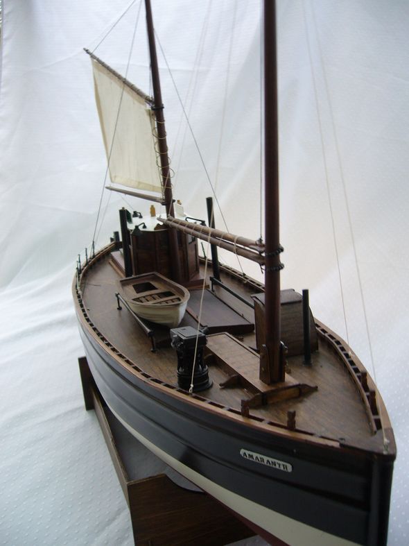

This model, from the Caldercraft Mini-Fleet Series, was to be my next challenge. Regular readers of this magazine will know that I suffer from Parkinson’s Disease, but also that model boat building is both therapeutic and challenging for me.
The model, to a scale of 1:40, has a length of 600mm and a beam of 170mm and was to be a slight change for my model shipbuilding, since it has a moulded hull unlike my previous models which have been plank on frame. However, this Scottish trawler in all other respects is constructed of wood. The first task as always, was to open the box and check all the components against the list supplied. The detailed instructions supplied with Caldercraft (and Jotika) kits, are very explicit, easy to read and understand. The model is designed for electric propulsion and radio control, but I decided to build it as a static model as indeed have been my other models, but with the option of perhaps installing motive power later.

Having made and painted the aft hatch and fitted the wheelhouse base, this last item could then be built on top of it. As I am right handed and that hand has the worst wobble, I decided to glue six small block supports to the wheelhouse base, which would be unseen when the model was completed, but would enable me to fit the cabin sides without knocking them over before the glue had set.
Unusually, the wheelhouse sides were satin varnished and glazed prior to assembly as I felt this as easier for me. The sides were then glued in place, the interior fitted out and the roof added. Any glue blemishes on the joints were touched in, but anyway it all fitted together rather well.
The navigation lights were painted gold and with the appropriate red, green and white coloured lenses. The deck light whitemetal parts were cleaned and fettled, painted satin black and were all fitted to the cabin roof with a very reasonable final result.
When fitting the aft hatch and its wheelhouse assembly, I found that unless it was in exactly the right position, it did not completely cover the hole in the deck. The hatch obviously needed to be removable in order to get to the hull interior should I so want at a later date.
So, after placing the hatch in its correct position, I fitted a wooden rail around the outside on the deck, so that whenever it was removed it would go back firmly in the correct spot and properly conceal the deck aperture. A different procedure was adopted for the main hatch in front of the cabin where I created a lip by gluing small strips of wood to the inner edge of the hole. This hatch, previously constructed, then fitted snugly over the lip allowing it to be removed to gain access to the motor space.
The two aft chimney exhausts could now be painted satin black and glued in place (see Photo 7 again). The ten metal stanchions were duly prepared and painted Humbrol satin Coal Black No. 85, glued in place and rigged with the thick thread supplied and this turned out to be rather easier than I expected. I could keep the thread taut by tying it through the eyelet at one end, running it through the eyes of the stanchions and then through the last eyelet on the gunwale. By hanging a pair of tweezers on the free end to keep it taut, I then put a small dab of glue on the eyelet and cord, which would keep it taut and when dry, it was then easy enough to tie a further knot to finish the job.
With the hatches complete and the chimney exhausts firmly fixed in place, I turned my attention to the dinghy.
This was straightforward to construct within my limitations and I decided to stain the wooden seats and gunwale medium brown before finishing off with satin varnish. The exterior of the dinghy hull I chose to paint satin white, rather than green as recommended in the instructions. With this type of model, the colour scheme can within reason be whatever the builder might personally choose.
Next came the preparation and assembly of the whitemetal parts for the steam winch, which were also painted satin black before fixing to the deck. The companionway was however rather more challenging. This was due to the radius of the roof and I decided to assemble it on its own base before gluing it to the deck. It was not too difficult forming the radius of the roof with the thin plywood supplied, but I found it difficult to keep it in place whilst the glue was setting. Rubber bands were a great help in solving this problem and after a few adjustments, a successful result was achieved.

Dowel is supplied for these and it requires shaping. The question arose as to how to taper these without a lathe and my solution was to place the dowel in an electric drill chuck. When the drill was switched on at low speed, I could taper the dowel with various grades of abrasive paper until it was shaped as per the drawings. Obviously, the drill needs to be secured with either the chuck vertical or horizontal and care has to be taken with the dowel not to exert too much pressure when sanding or it could fracture. After staining and satin varnishing, the booms and mast were drilled for the necessary cleats and eyelets. The gaff booms were duly fitted with the wooden jaws and drilled to take the Parrel beads, which would encircle the masts. Here, I decided to make a small modification for my benefit to help with attaching the booms to the masts. I drilled a small hole in the end of the booms and into these holes I glued a short length of brass rod. This was concealed by the boom jaws and with a matching hole drilled in the mast, the booms could be fitted with some accuracy in the correct position. Okay, this is cheating a bit, but seemed to me to be acceptable for a static display model.
The masts were duly stepped into the hull and my thoughts turned to the sail and rigging. The sail supplied needed to be slightly modified to fit the shape of the aft mast and boom. This task was sub-contracted to my wife with her expert sewing skills. The metal rings for running the sail up and down the aft mast were simply made by winding some brass wire around a wooden dowel the same size as the mast.
All was now complete except for the whitemetal name plates. To paint these correctly and finish the model in the manner it deserved, this last piece of work was clearly beyond the ability of The Wobbly Shipbuilder and help was sought from a local artist who is an expert in miniature painting. As would be expected, the results were excellent and finished off my three and a half year’s work. So yes as you have guessed, I am not a rapid builder, but I find it very therapeutic and satisfying to achieve a decent personal final result.
