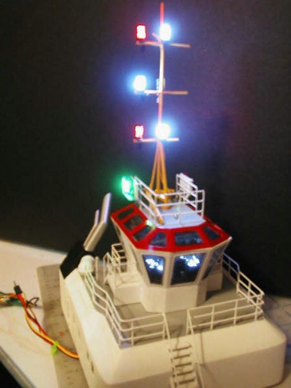

While researching for this article I came across a really clever idea. Some of you may well be familiar with the top notch modeller known as Umi_Ryuzuki who posts on at least one of the web forums. This idea is hers and I have her permission to share it with the readers of Model Boats. The basic concept could be adapted to a number of applications but in essence it involves casting lighting fixtures in a clear or coloured resin, Photo 7. That may sound like nothing special, but the clever bit is that the LED used to illuminate the fixture is included within the casting. Additional pictures can be readily seen on Umi_Ryuzuki’s website (see Internet Resources below). If you don’t want the bother of casting your own, then they and a number of other useful items are also available for sale via the same website.
