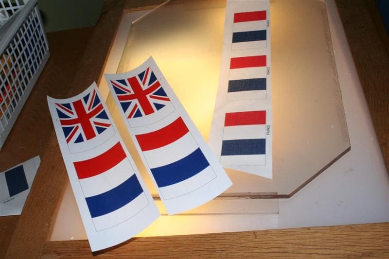

The company started by manufacturing flags and there are literally hundreds now available ranging from the common UK White and Red Ensigns to more obscure designs such as the Alaska State Flag. Burgees and other specialist flags also feature including that of the San Francisco Model Boat Club! Sets of signal flags are produced at different scales so you can compose your own messages or even fly ‘England Expects’ from your model of HMS Victory. Flags are printed on to a cotton base and a special manual process allows printing on both sides for better definition of the design. The inks and sealant used are both waterproof and fade resistant.

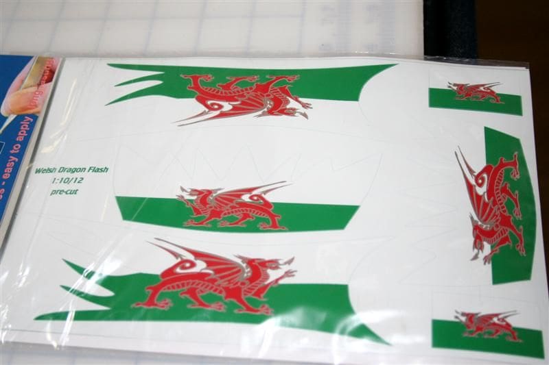

Decals and graphics

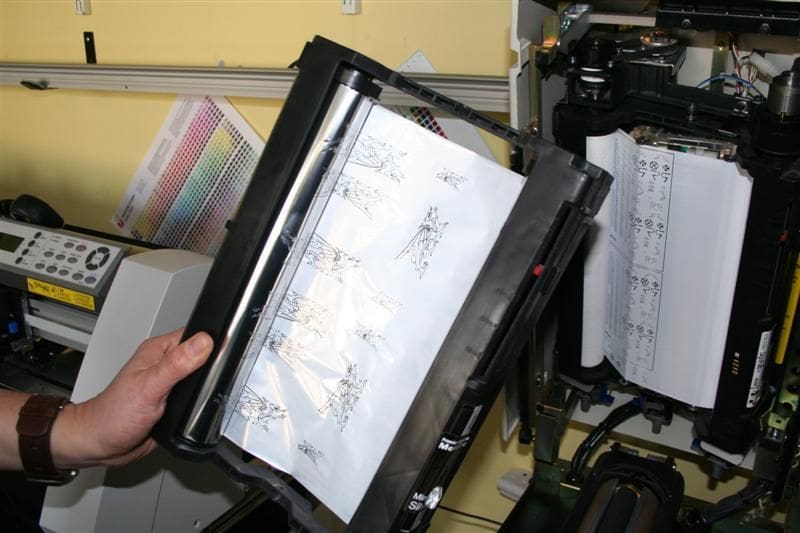

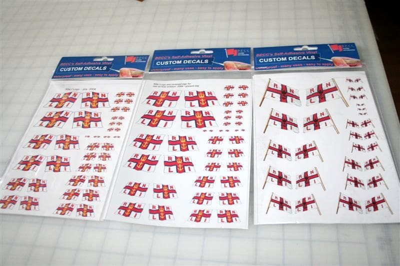

The range of decals and graphics is the biggest growth area at the moment and takes advantage of the sophisticated capabilities of the company’s plotter/cutters and thermal printers which allow complex multi colour CAD designs to be produced in vinyl. There are several variations in the production process depending upon the subject, but a typical method entails producing separate design templates for each colour. These are cut from coloured thermal transfer foils under computer control and then sequentially aligned and fused to a vinyl substrate using a Gerber Edge thermal transfer printer. A wide range of subjects are available including military and commercial insignia, instrument dials and customizing graphics
Sheets of general purpose graphics are also available including lining and sheets in solid or mirror finish. The material is very tolerant of stretching and the lining can be bent smoothly around quite tight radii. Many flags are also available in vinyl as well.

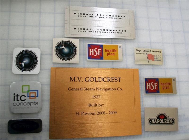

Although BECC do not normally sell directly to the public they will quote for one off specialist commissions if requested. These include club car stickers and company signage and they are also able to produce some neat nameplates by printing directly onto metal which I thought would be very useful for glass case static models.
