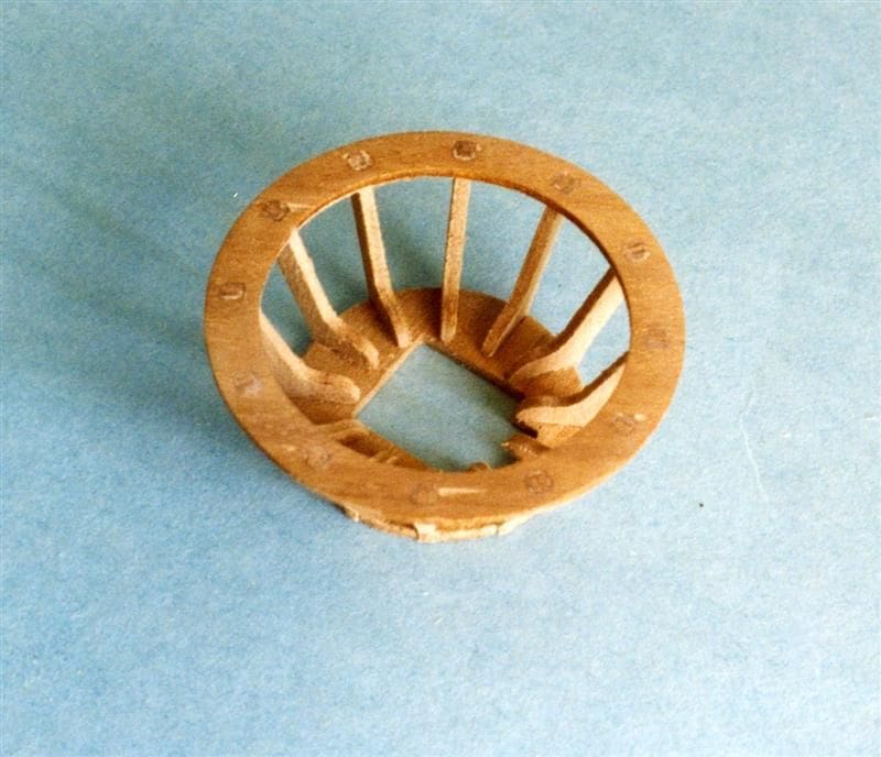

The shape and complexity of construction varied according to the period. On vessels up to around 1700, tops were circular and had angled sides, Photo 48, which were often planked with a capping rail around the top edge, the supports for the sides usually being an integral part of the battens radially spaced around the floor of the top. A good kit will provide these parts pre-cut, but care is still needed to get the spacing correct. The fixing of the top rail is particularly important, since it is through these that the deadeye strops for the topmast shrouds will pass, the angular sides of the top providing clearance for attaching the futtock shrouds below.

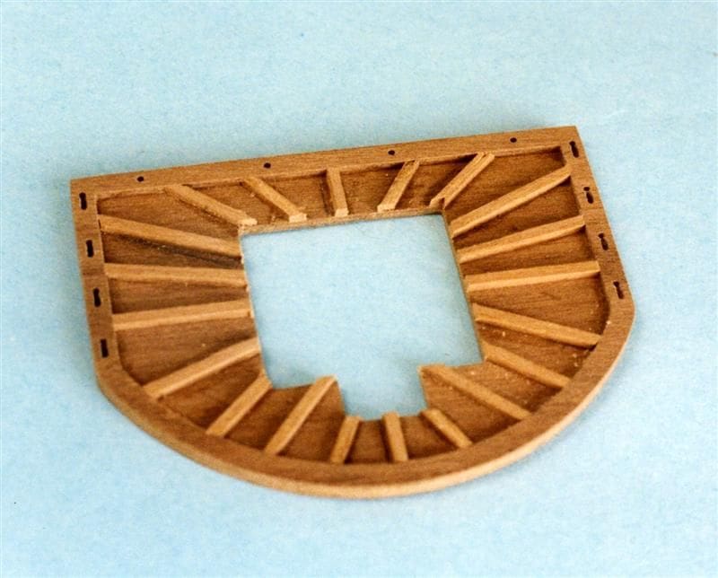

Again, there will be a number of battens to arrange in a set pattern on the upper surface of the top. Getting the pattern symmetrical calls for careful measurement and accurate trimming of the ends of the wood strip being used. It is best to start with the central or lateral battens and use a pair of dividers to determine the position of the others. The corners of the lubber holes in the platform proper are useful gauging points for getting the inner ends of the battens in the right place, Photo 49.

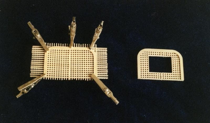

Another variation arises in the case of some merchant vessels where the top may be a framed grating. These are constructed in a similar fashion to deck gratings but without the battens described above, Photo 50.

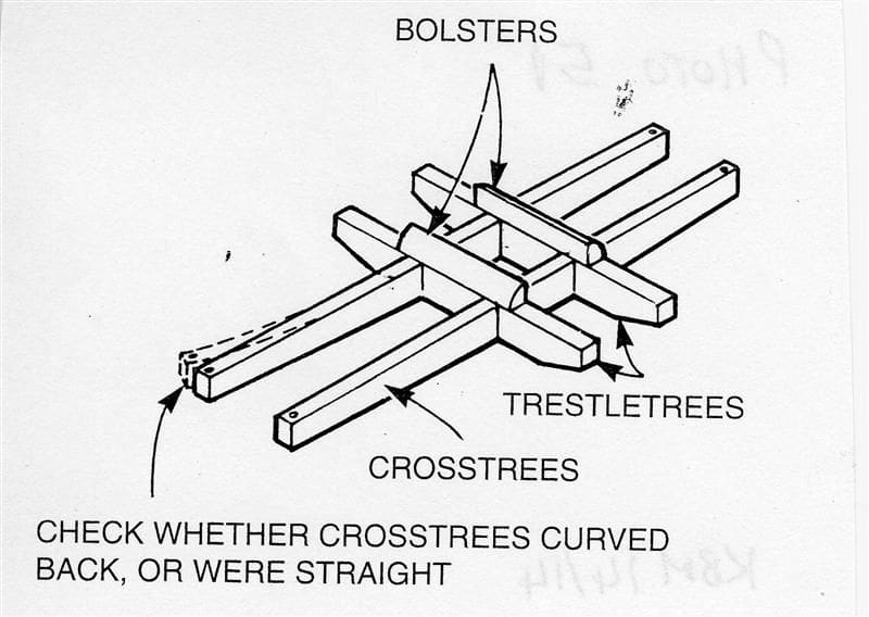

Bolsters
51
These were strips of timber, quadrant shaped, and fitted to the top surface of the trestletrees to protect the lower shrouds from the sharp edges of the structure as can be seen in the drawing in Photo 51. You can normally expect to form the section yourself using a suitable piece of square sectioned strip.
