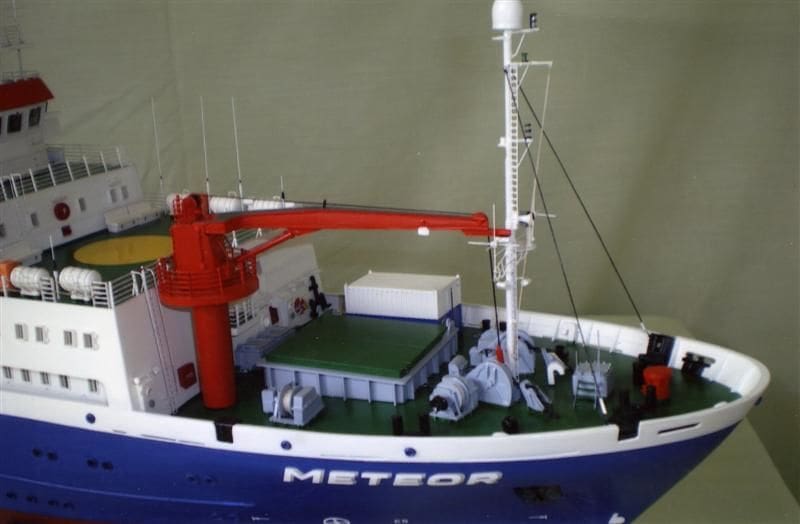

The model, Photo 2, is scratch built to a scale of 1:100 from the original drawings with most of the detail based on the photographs I received. The hull is ‘plank on frame’ on 1/4 inch marine ply frames with lime planking (1.5mm x 5mm). The superstructure is of 1mm ply on 1/8 inch ply frames.
The fixtures, fittings and most of the detail parts are made from wood and brass. The only significant exceptions to scratch building are the 300 or so five rail stanchions (designed and photo-etched for me by Gordon Brooks to accommodate the 0.4mm steel piano wire I use for the rails) and the propeller which was manufactured by George Sitek.

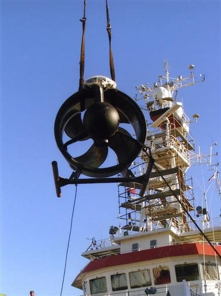

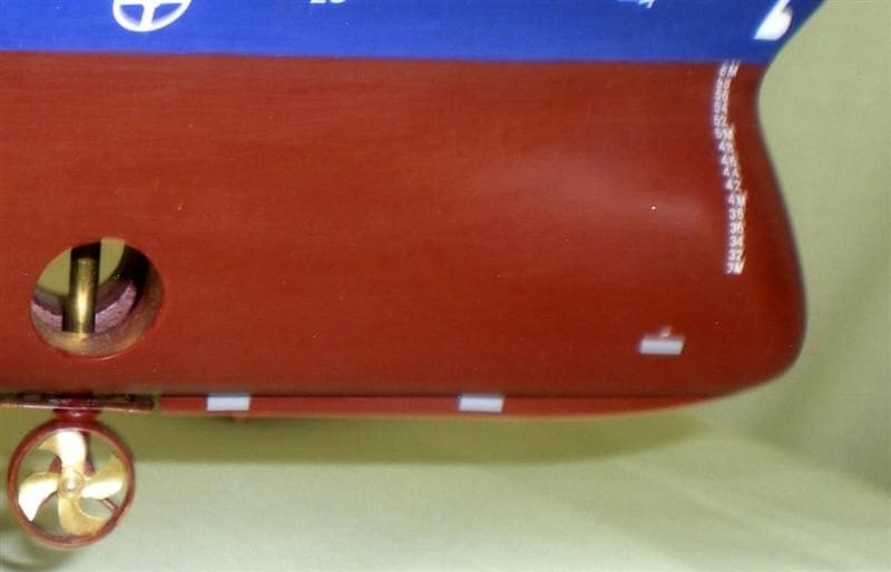

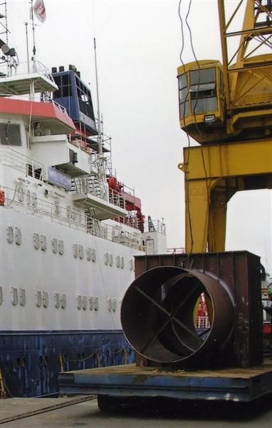

Coinciding with the final stages of building the hull, I was informed that Meteor was to have a major refit early in 2006 at Talcahuano, a shipyard about 250 miles south of Valparaiso in Chile, involving amongst other things the removal of the existing bow thruster and the section of hull adjacent to it, Photo 3, followed by the fitting of an entirely different type of thruster, Photos 4 and 5.
Fortunately, the details and dimensions of the new thruster were made available to me just in time to let me do my own refit on the model without having to start all over again.
Photos 6 and 7 show the new thruster in its normal position for steaming and in its lowered position when it can rotate on its vertical axis through 360 degrees, which is very useful for dynamic positioning.

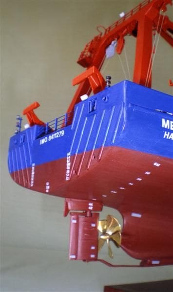

One or two of the more unusual features encountered during the building are perhaps worth a mention. The first of those is the fact that Meteor has an asymmetric stern. Have you heard of these? Well no, I hadn’t either, nor have I met anyone who has. However, It is clearly shown on the bodyplan as received but it can be reproduced here in Figure One. I have shaded the shape of the lower part of Ordinate One. This clearly illustrates how asymmetric the hull is at the stern. I don’t know if the shipbuilders had any problems with this, but I certainly found that planking the hull in this area was not easy.

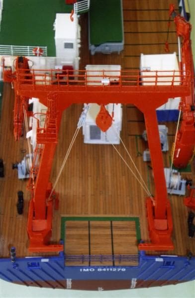

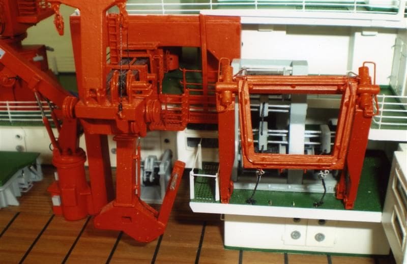

The variety of cranes mounted is also very interesting. Those seen aft of the starboard lifeboat in Photos 10 and 11 are in fact designed to handle some of the scientific equipment and are unique, as is the very large crane aft, Photo 12. Fortunately, I received drawings for all of these cranes so was able to build them accurately and reasonably detailed. Readers who know me are well aware of my attachment to cranes!

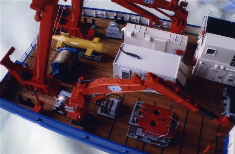

A few of the pieces of scientific equipment available on board have been modelled and are shown on the main deck aft, Photo 13. Below the jib of the starboard crane is a very sophisticated ROV (Remotely Operated Vehicle): At the base of the port leg of the A Frame is an AUV (Autonomous Underwater Vehicle), the newest development in underwater research and alongside the AUV is a Streamer, about 500m long that is equipped with hydrophones and is used for seismic research.

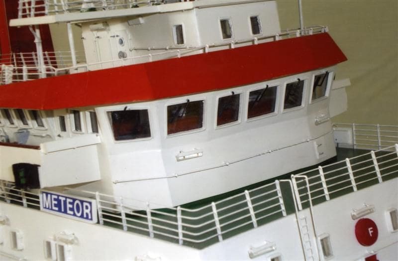

Photo 15 is of the wheelhouse with laboratories on its roof.

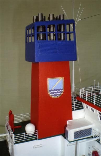

Photo 16 is a close-up of the forecastle deck and the funnel in Photo 17 is certainly unusual.

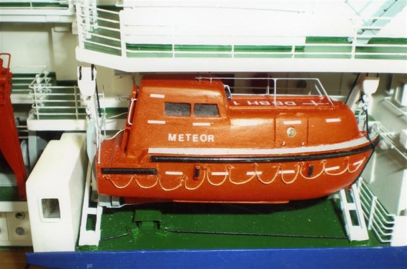

The starboard lifeboat in Photo 18 is a miniature model in its own right and Photo 19 is of the stern mounted A Frame with the main deck still awaiting some of the detail parts.
