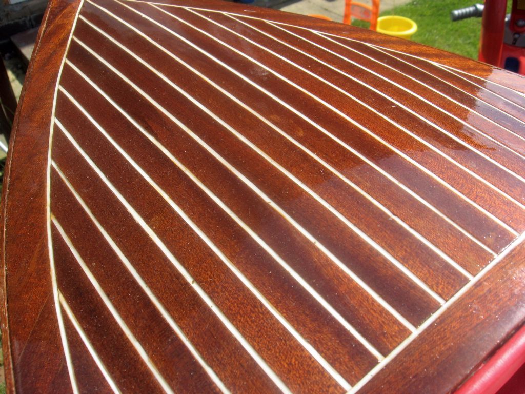

The first coat of varnish might raise the grain so dont be disappointed if your carefully prepared work becomes rough, simply use a fine sandpaper such as 1200g and gently sand the surface, always sand with the grain. Apply the second coat, this time of undiluted varnish, using the same care that you took with the first and allow to dry then lightly sand smooth.
You should repeat this process several times until you achieve the finish that you require although obviously dont sand the final coat.

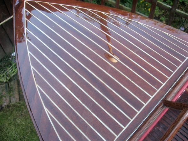

It should go without saying that you must do everything that you can to minimise any dust or the possibility of dust when varnishing so it is usually best not to varnish in your normal work area as there will be all sorts of dust and debris in the atmosphere. You also need to watchful of temperature and humidity as both can ruin a great finish by giving a milky haze to the dry coat, this is called Bloom and if you get it then you will have to sand and start the last coat again.

The last problem are insects as they just love to land on your newly applied surface, if you are lucky you will spot it and be able to remove the little bugger before the varnish sets it in place. If not then when the varnish is fully dry a little local light sanding and delicate brushwork should restore the perfect finish.

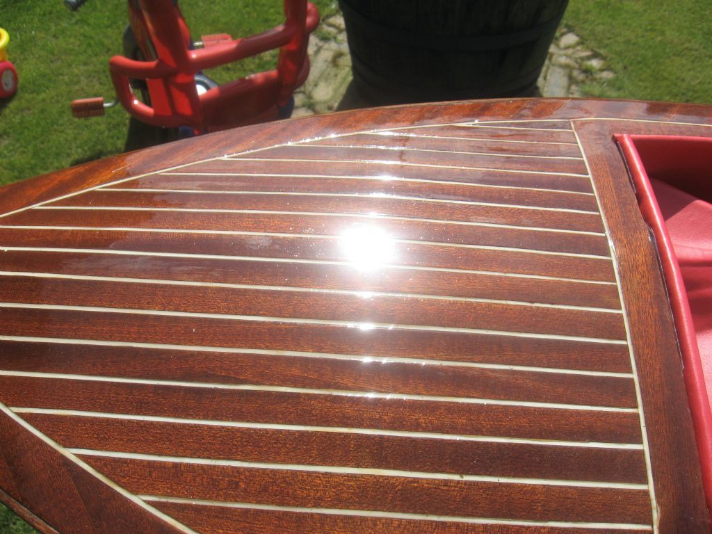

An option that furniture makers employ is to use a rubbing compound on the final coat of varnish and then a few coats of polish for that really deep mellow finish.
