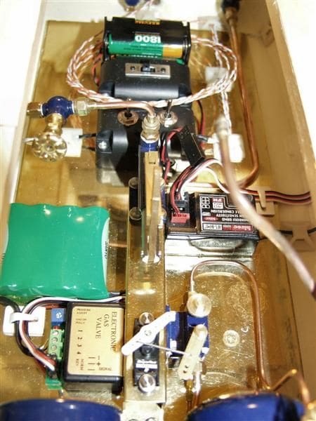

1) I wanted to fill the boiler under pressure, but I did not want automatic level control. This meant the inclusion of a manual feed pump and an on board feed water tank (in the bows), Photo 2.

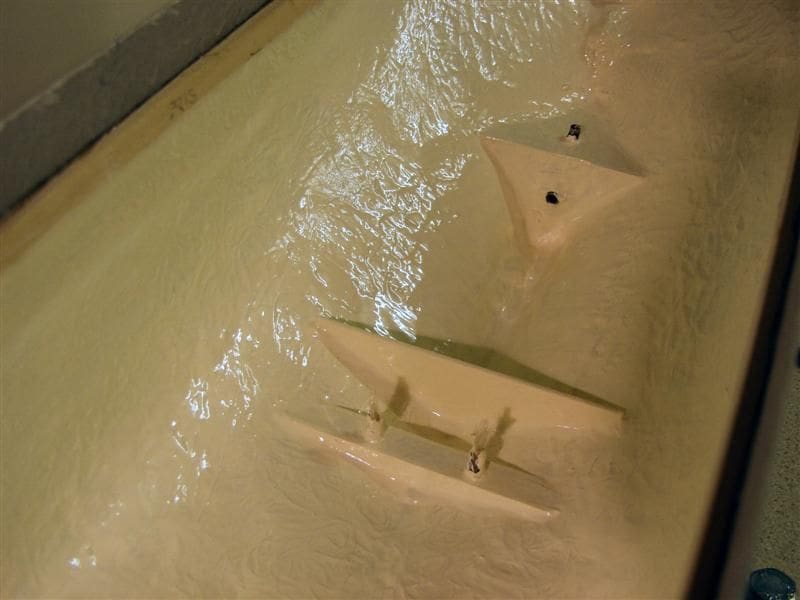

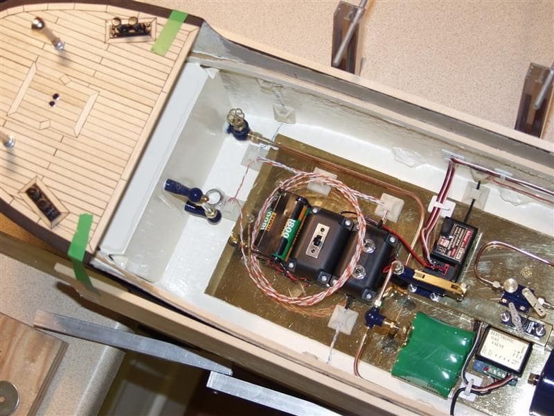

4) I needed to get the plant as far back in the hull as possible to try to get the boiler flue as close as possible to be in line with the models funnel. This meant a Vee Twin Oscillator Engine with a horizontal boiler fitted with a flue at the aft end of the boiler, Photo 3.

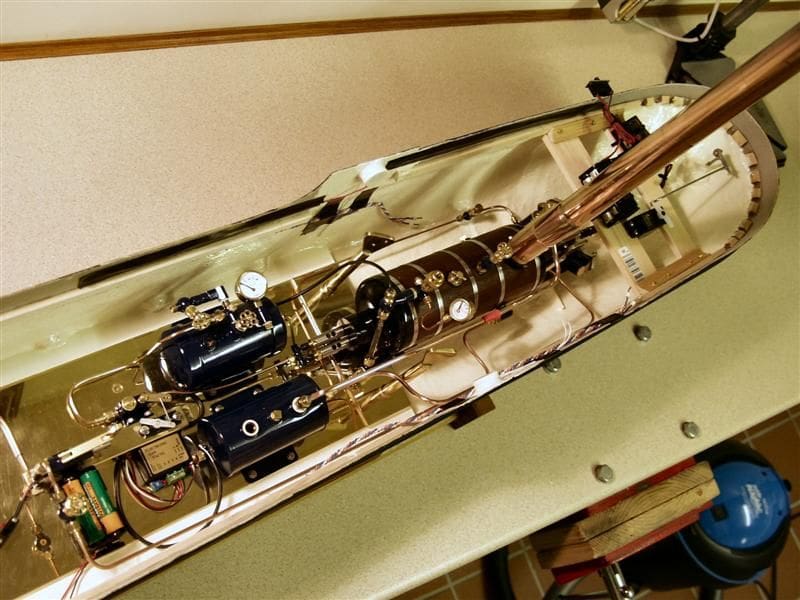

Now you need to get your hull to a reasonably completed stage. If you are building a kit and have a ready made GRP hull then you are there already virtually there, but if you are scratch building or making a plank on frame kit you need to have the hull completed. It would also be easier if you had the main decks available, but not attached, so you can see what height limitations you will have to work with as well as get a feel for your access possibilities. You should have the steam plant base in the hull, which in my case was a brass plate mounted on wooden bearers and covering steel plates which were the main bulk of the ballast.

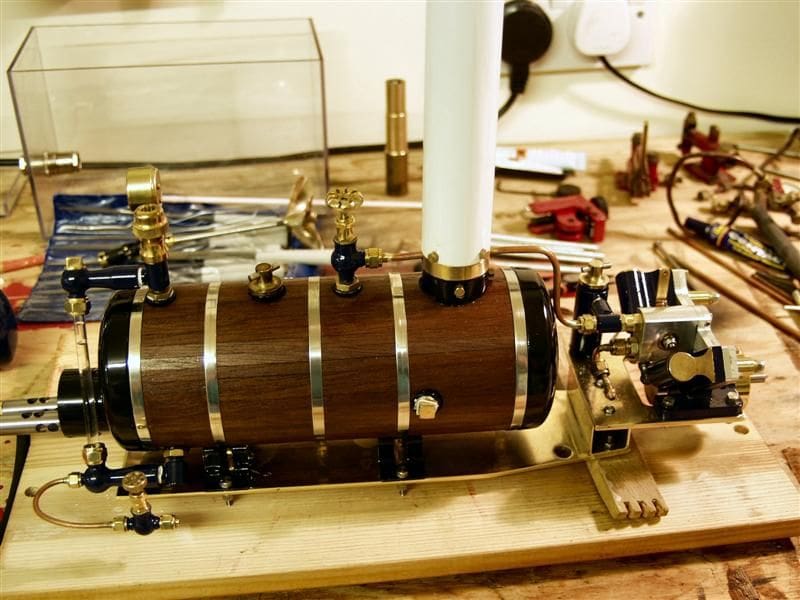

Then, simply play around with the arrangement of the components you have decided to fit. Take your time with this because even when you are finally happy you will still think of things that you had missed and want to make adjustments. Think of how the components relate to each other, how they can be accessed, how they can be removed, how they can be operated in the boat and whether there is likely to be any effect on each other from heat or moisture. Remember that once the decks are secured in place there is considerably less opportunity to move items around, so make the most of this, Photo 4.

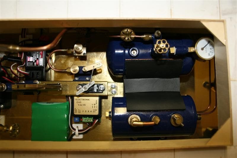

3) The water pump had to be very accessible so it was mounted on a brass square section tube bearer in the middle of the main hatch where it is easily operable with a handle extension. The brass tube bearer was then also used to mount the gas control valve and servo, Photo 5.

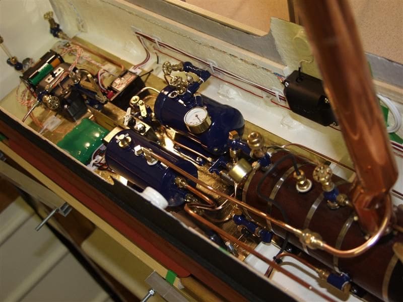

4) The separator tank and the gas tank needed to be near each other to allow for a heat transfer arrangement to be fitted between the two, so they were mounted either side of the main hatch at the aft end, Photo 6.

At last the time has come to start to install some of the larger items into the hull. Starting with the items with very limited flexibility, the boiler and engine assembly are obviously the first. Mine are mounted on another independent brass base to make removal as easy as possible, but I had to come up with a method of fixing the base that could be released externally and secured when the unit was in place. I decided to embed machine screws into a resin floor that could then have nuts simply fitted to them when the plate was in place, Photo 7.
The gas tank, separator tank and brass square tube were all fixed to the main forward brass plate and the water pump attached to the top of it all with stainless steel machine screws. Then the arrangement of all the smaller items such as the batteries, switches, receivers and servos was finalised and they were installed, with most of these being held in place with a blob of silicone sealant, making removal relatively simple in the future.
At the end of the day I was quite pleased with the way all the items went in and the relationship with each other. The gas tank is next to the gas valve which in turn is very close to the boiler burner, so that all goes together well. The separator tank is close enough to the gas tank to enable the fitting of a copper heat sink bridge to be relatively easy and most things are easily accessible and easily removable. Your own plant will be very different to this installation, but the chances of a successful and reliable model will be greatly improved if you follow the same steps that I did. It will be almost impossible to make major changes to the installation after the decks are all fitted, so make the most of this time and be completely satisfied before you progress further.
