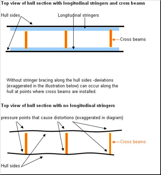

The lightweight stringers and cross sectional supports were glued in place using 24hr epoxy. A word of caution here, is that some five minute or fast setting epoxy glues are actually not fully waterproof when cured.

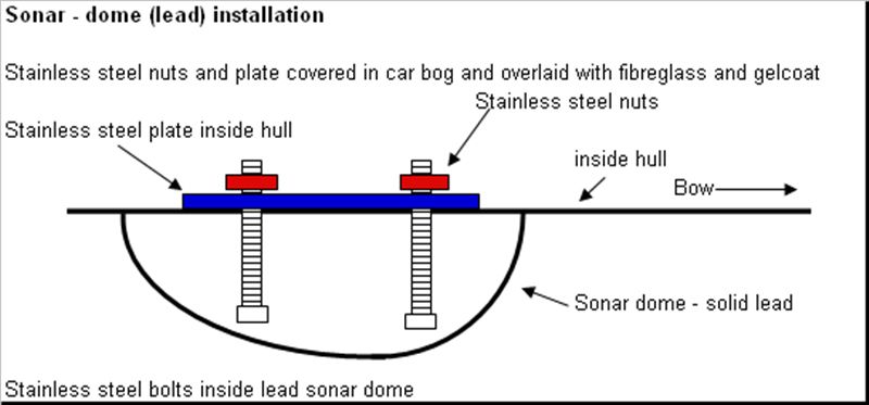

The next stage in the construction was to fit this to the hull. To heed the warnings of those who have built the kit previously, we sought to keep weight as low as possible. In this respect my father, a keen r/c yachtsman hit upon a great idea. He suggested we make the dome out of solid lead. To do so would provide a lead like keel in a position very low down, actually lower than the bottom of the hull and the ballast could then be disguised as the sonar dome. My father built a ceramic mould and cast the dome. Two stainless steel bolts inserted into the lead secured the dome to the hull.
The relatively rough outer skin of the lead sonar dome was then filled with fibreglass filler and sanded to shape. This outer skin was then also coated with a layer of gel coat with a special drying agent added (gel coat remains tacky unless air is excluded or a special additive is included the catalysed mixture). Inside the hull a stainless steel plate was inserted over and around the bolts to spread the load and a layer of chopped strand mat and fibreglass resin secured everything permanently.
