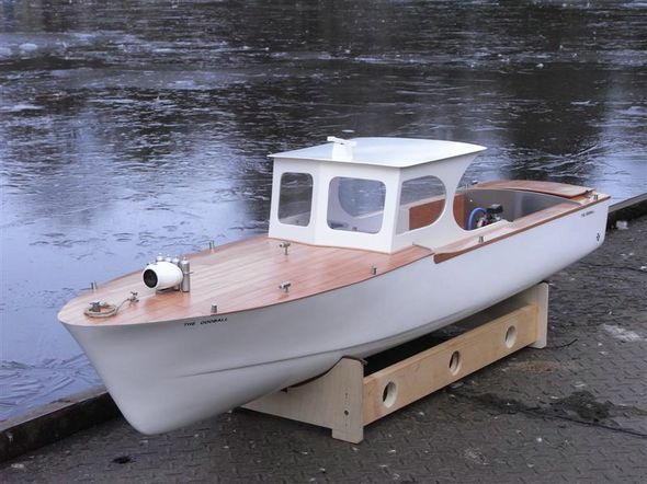

It is a big model. The camera can be seen on the foredeck.
Contemplating my next model, I came up with the following objectives: To scratch build a large scale cabin cruiser of simple unfussy lines and incorporating a well designed 4 stroke engine which although on view would in fact be a dummy engine, the real propulsion being by a hidden electric motor, cooled by water circulated by a pump.

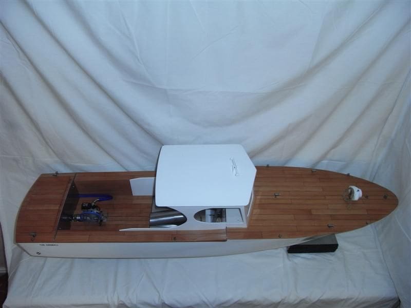

The deck
This was to be planked and these were each cut from sheets of pear. 20mm wide x 1.5mm thick strips were superglued to the sub-deck with black card representing the caulking. After rubbing down and general cleaning up, the planking was sprayed with several coats of good quality polyurethane varnish.

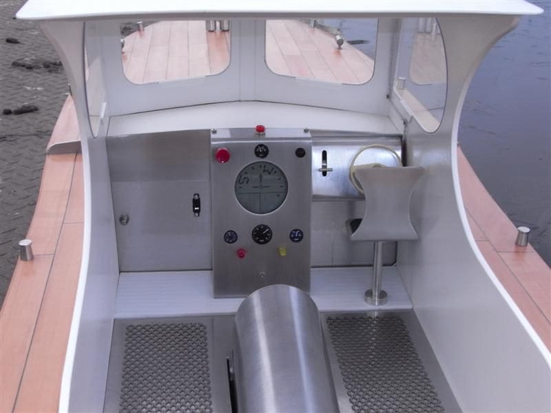

As I had decided on aluminium for the cabin and its visible bulkheads, great care had to be taken not to damage the surface of this material as it is very difficult to reproduce the smooth finish should repairs be necessary. This task, although unusual, was quite straightforward for me and once completed I commenced the final fitting out.

As the whole design is over the top I also decided to fit an electronic compass into the control panel. Using a Halfords’ car compass as a basis, this was stripped and then built into the internal control panel.

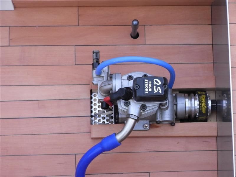

The OS four stroke engine was fitted with appropriate modifications, toothed pulleys being fitted to the engine crankshaft and to outside tube of the propshaft. Once the drive belt was fitted and the flooring in place, together with a sound unit you really would believe the 4 stroke is indeed the power plant. Blue high temperature silicone tubing represents the exhaust pipe.

With the main battery acting as ballast, only a small amount of ballast on the starboard side was needed to offset the weight of the pump on the port side. The model has an impressive turn of speed and I have to throttle back as the wake causes problems to other models due to the wide beam, long length and high displacement of this large craft. Sailing duration on one charge will normally exceed one hour.
