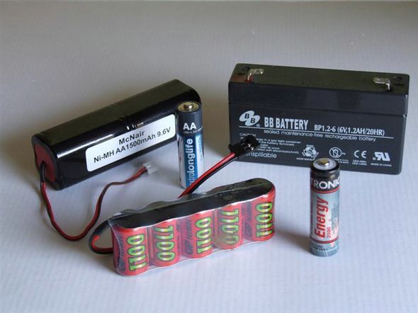

Common cells in use by model boaters.
L to R back: 9.6v NiMH transmitter pack, AA alkaline cell, 6v sealed lead acid battery, L to R front: 6v NiMH receiver pack, AA NiMH cell.

The main types of cell in general use by model boaters are Lead Acid, NiCd, NiMH and the ubiquitous Alkaline primary cell which is sometimes used for transmitter and receiver power, but rarely for motive use. Photo 1 shows the common cells and batteries in use by model boaters. Lithium Ion secondary cells and batteries (pictured later) tend to be used primarily for electric flight and require charging facilities that the average model boater may not possess. However, before we can usefully discuss the characteristics of different cell types in detail, we need to define a few terms.

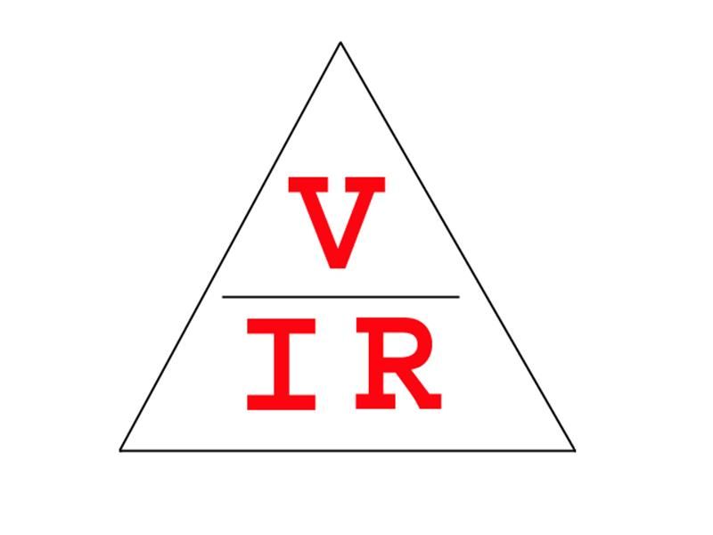

Ohms law: The classic law linking voltage (V), current (I) and resistance (R). Ohms Law allows any one of the parameters to be calculated if the other two are known. Remembering all three possible equations can be difficult, but theres a useful tip I learnt from my physics master some 50 years ago! Remember this little diagram. If you cover up the unknown parameter you have the equation for the other two. Hence V = IR, I = V/R and R = V/I.
