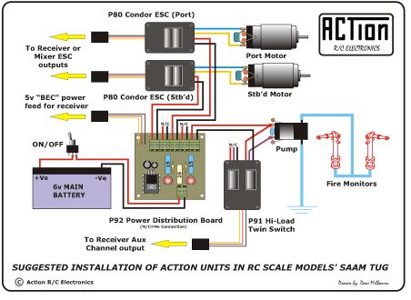

ACTion R/C Electronics is a family run business based in the UK and for some time they have produced a very wide and extensive range of excellent add-on electronic modules. For this model, with their advice and supplied coloured wiring diagram, the following modules have been used: Two Condor P80 20/2 auto set computer speed controllers with one dedicated to each motor, a high load twin switch unit P91 to control the on/off power to the water cannon pump and as this is capable of doing two jobs, I have the flexibility to add working lights or sound later. Another device that has been well thought out and designed is ACTions all new 5+1 power distribution board. This is to cope with all the internal power requirements of the boat at the same time making the connections and wiring a little tidier. This unit is wired into the system after the main on/off switch in the model. The board has three on board protective fuses – for the main overall protection and for the two grouped outputs. A 15amp fuse was ideal for motor protection. Another excellent user friendly feature of this unit, is that if an output fuse blows for whatever reason, the board has two red indicating LEDs which are ON if okay and OFF if not (fuse blown), giving a quick and simple visual indication. All electrical connections are of the screw terminal variety. The last and most important feature is the on board BEC (Battery Eliminator Circuit), which once the appropriate servo type lead has been connected, will supply the correct power to the receiver, thus eliminating the need for a separate receiver battery pack. I used a 6v 4Ah dry fit sealed lead acid type battery, Ripmax, Pt. No. 0-PRP0604, which fits neatly in to the hull plywood cradle. All good model shops should be able to assist, or an alternative source would be a Maplins store, who list the same, Pt. No. L21AC.
Wiring diagram produced by ACTion R/C Electronics
