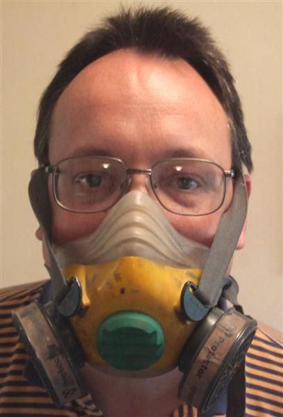

A face mask. You need one of these or you will die, or at the very least make yourself seriously ill. Visit a motoring accessory shop and get something designed for when spraying cars. Buy one with replaceable filter cartridges and make sure they are rated for paint and not just dust. DIY store paper masks intended for dust will not do the job.
