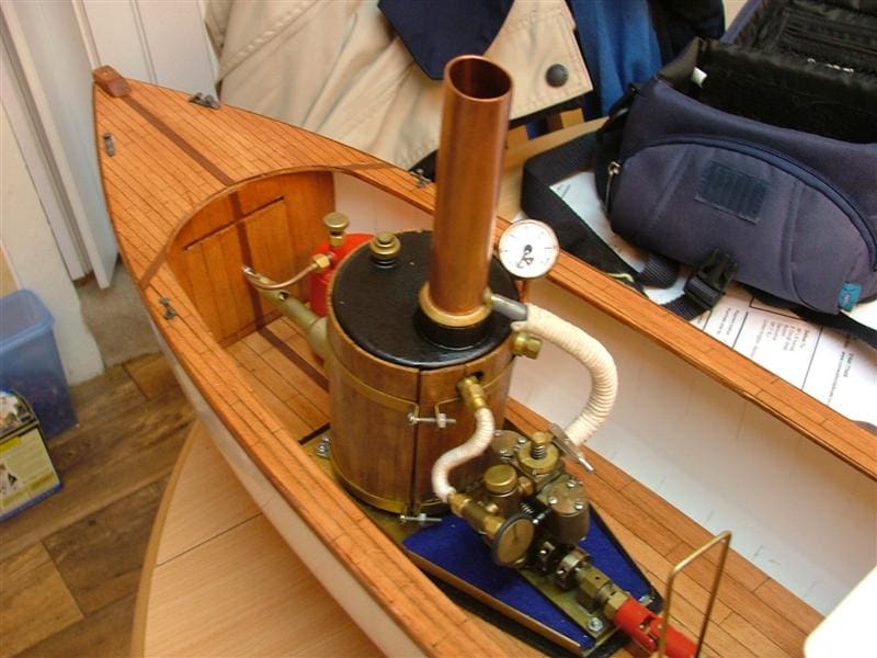

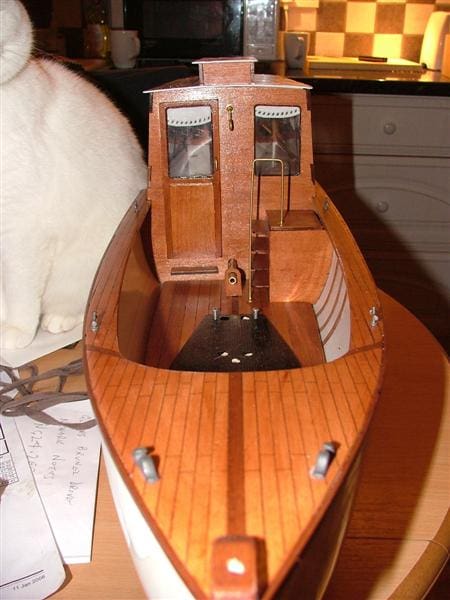

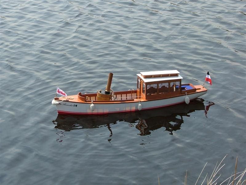

Pic 1: This bows on picture shows the neat deck planking. Pic 2: The steam plant ready for a bench test. Pic 3: The steam plant installed in the model, forward of the cabin.

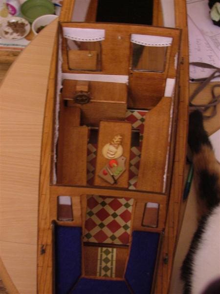

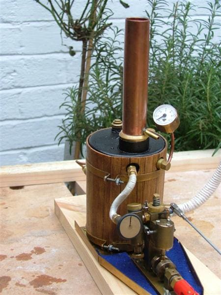

Pic 4: The inside of the cabin and the cheeseboard. Pic 5: Alexandra almost finished except for the name decals. Pic 6: In her natural environment, Alexandra moving under her own steam.
The full-size plans are great, but Krick are a German company, so the text of the instructions is translated by them and fortunately came with the kit. The wooden laser-cut parts are all numbered and are easy to locate and cross-reference to the plan. With a few simple tools and fine sandpaper you can make very good and rapid progress with the project. The steam engine came from Graupner and runs on camping gas from its own small gas tank. Its simple operation made life easy, especially as a close friend of mine makes model traction engines and he was interested in my project. After doing some bench testing and getting to know the engine it was final assembled into the hull.
I have now steamed Alexandra a number of times using Glynn Guest’s idea of putting 5% glycol into the boiler water to get a more visible steam effect on hot days. This works wonders and as Glycol contains a rust inhibitor and is also a lubricant, I think it can’t do any harm (please see Model Boats March 2008 for his ‘Hints and Tips’ piece). Of course no model is the same until it’s come alive with a few extras in the form a turn of the century meal on the table obtained from my local doll’s house shop, but period figures have yet to be added at the time of writing.
