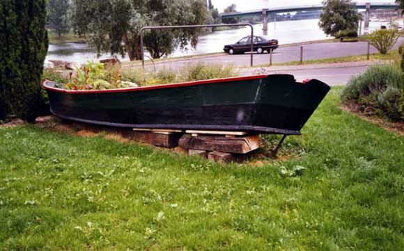

I spotted it on a roundabout in France whilst exploring Burgundy, both the countryside and the wine. There it was, an old wooden river skiff, nicely painted and partly filled with soil and planted with flowers to make a display in the centre of the roundabout – such indignity! Camping nearby, I was soon walking back to take a closer look, Photo 1. All over Europe there are fewer and fewer remaining examples of traditional wooden working boats. When I see one, I like to record my sighting by taking photos and, as in this case, making sketches of interesting details. Sometimes this is with a view to making a model in the future and at other times it is just to make a record, perhaps with a view to preserving something for posterity.
What I liked about this boat was its sleek elegance in a simple and functional way, the unusual construction and the bold green and red colour scheme. The bow also has an attractive curve to it, which for me, just adds a nice touch.

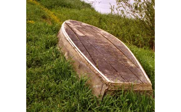

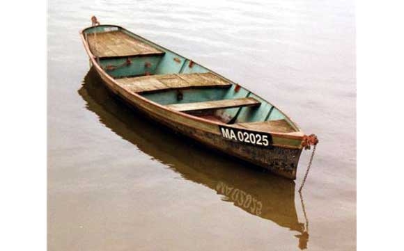

The roundabout with the boat in its centre was in Tournus, a town well worth visiting on the River Rhone, one of France’s massive rivers. A short walk down to the river bank revealed three more boats of the same design. All were very dilapidated; two were afloat and one was upside down rotting on the bank, Photos 2 and 3.

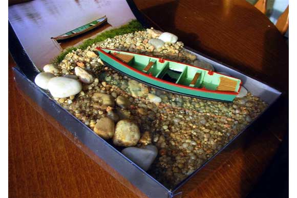

I now had an attractive model, but it needed to be set off nicely. A Christmas card box about to be thrown away gave me an idea for a boat to be ‘floating’ on the cellophane lid. Using some beautiful stones that were in stock and I had collected from the beach, I was able to make a riverbank scene. Those stones below the water were set in ordinary building cement, reinforced with two hook ended lengths of coat hanger wire. After setting, these stones were sprayed with gloss varnish to make them look wet. Those stones above the water, i.e. on top of the cellophane were set with PVA glue in the form of a curved beach, and a photo of one of the old boats set in as a backdrop. A coat of black paint obscured the printed matter on the box, Photo 6. The boulders in the mix of sand and gravel, are at a scale size of about 4ft to 6ft across. The contrast between these great boulders and the fine lines of the boat make a dramatic visual impact.
It never occurred to me that I might have filled my model with some soil, planted some miniature flowers and set it on a model roundabout – even I would not stoop as low as that!
So, my pristine little river skiff is just hauled up safely at the river bank, Photo 7. I am delighted to have achieved a miniature record of a fast disappearing type of boat, in a roundabout way!
