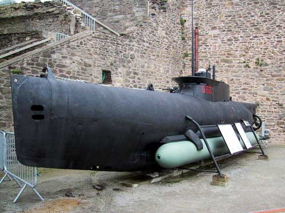

The Polish company GPM have recently produced four card model kits of German mini U-boats, of which the latest two are the two-man Seehund and one-man Biber submarines, each armed with two torpedoes. Both these kits were supplied for review by Marcle Models who advertise regularly in this magazine. The Biber design was based on the British submarine Welman W46 captured in Bergen in 1943. The prototype was finished in March 1944 and eventually 324 boats were delivered by two shipyards Klockner Jumbolt Deutz and the Ansaldo Shipyard Facility in Italy. The Seehund, Photo 1, was a two-man midget submarine with a relatively long range, designed by Kort Fischer and Otto Girm, and built by Howaldswerke dockyard in 1944. 285 were delivered by three dockyards, and they were the most successful of the small U-boats. Both models were built, each being constructed in a similar manner and both in a similar time of 20 25 hours. For the purpose of this review, I shall describe the construction of the Seehund, which being larger was easier to photograph, Photo 2.

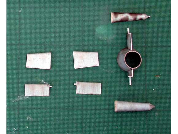

Back to the hull: We have to build the kort nozzle, rudder and hydro-planes. The instructions indicate that you glue the inner surface of the kort to the outer surface, cut out the shape then form it into a tapered tube. On a tight curvature like this, that is hard to achieve, as the inner surface tends to ruckle up. I found it easier to cut out the two pieces together, but did not immediately join them. Then shape and glue together the outer section to the correct form. The inner section is then rolled to form a tube and then slid inside the outer section. A dry run will show it is too long and the ends overlap, but these can be trimmed off and when all is correct, the inner part glued inside the outer one. The rudder sections are formed and added to the top and bottom of the nozzle. The pivot pins for the rudder and hydro-planes are formed from card, but wire or wood could be used instead, Photo 9. Before assembling the control surfaces to the rear of the hull, it is necessary to make and fit the propeller. The boss is formed around the pointed end of a cocktail stick and the three blades glued on where marked. With the propeller in place, the nozzle can be slid over it and its two supporting arms glued to the top and bottom of the rear hull, Photo 10. The horizontal control surfaces can now be made up and fitted, firstly the fixed surfaces and then the moveable ones, with the pivot bar passing between the two through the rear hull, Photo 11.
