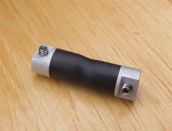

In the 2006 Kits Special I reviewed Sling Shot, which is a ready to run (RTR) fast electric speedboat sold complete with r/c, motor and drive battery and all that is needed are dry cells for the transmitter. Since then the Knightcote Model Boat Club has run a full racing series with around a dozen members running a boat each. Needless to say, once we bought the models we couldn’t resist fiddling with them in some way, so I thought that it would be useful to show just what can be done with a basic RTR model. Fixing problemsThe first type of common alterations were those needed to fix problems experienced with the boats. Very early on, several members found that the coupling between motor and propshaft worked lose. An engineer amongst our group started to offer a service where the pan headed screws fitted as standard were replaced with proper grub screws , Photo 1. This allows them to be tightened up more easily and firmly. Combine this with a flat area filed on the end of the propshaft and you get a good solid grip. An alternative method is to drip superglue onto the coupling and quickly re-assemble the driveline. It’s not proper engineering of course, but also seems to be good enough, but makes dismantling difficult. Another issue is that if enough water gets in the boat, it can destroy the speed control attached to the back of the motor. You know you are in trouble when you have only one speed full tilt! After killing one unit, I carefully unsoldered its replacement and re-attached it via some flyleads. This allowed the speed control to be sealed in a plastic bag, Photo 2. To carry out these modifications you need to remove the top of the boat. This is held down by some pretty stickers which disintegrate if removed and replaced a couple of times. The solution is to tape the top down. Electrical insulating tape is ideal as it seems to give a waterproof seal, bends around the curves of the model and can be easily removed next time you need to get inside. Enjoy more Model Boats Magazine reading. Click here to subscribe & save.

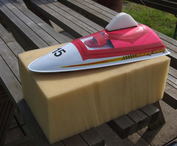

Fixing the lidTo change the battery, Sling Shot features an oval rubbery plastic bung which fits in the top cover. Fairly early on we discovered that this lid doesn’t float. In fact if anyone would care to dredge our pond there are several down there somewhere. The keen racer will use more insulating tape to seal this and keep the water out. You’ll be surprised how far a Sling Shot can run submerged, or how long it can sit upside down without problems. Sorting this problem causes another. The on/off switch is inside, so preparation for a race involves hurried work with tape unless you had the foresight to fit an external switch. In Photo 3 you can see the switch I fitted to my boat. This one came from a radio control car specialist, but others are available. Of course if your lid is at the bottom of the pond you need a replacement. You can order one from Ripmax who distribute the boat, or if there is a handy carpenter in your midst, get him to make up a wooden alternative and this is lighter and it floats. You still need to tape it down to keep the water out, but it’s a start, Photo 4. Self-rightingSling Shot racing is supposed to be a non-contact sport, but some drivers are better than others. Occasionally boats will flip and while all the tape will keep the water out and therefore the model on the surface, several racers decided to try and built self-righting devices. These usually take the form of a fin on the lid. Fins are made from either balsa wood, Photo 5, or dense plastic foam, Photo 6. To be honest the jury is out on how well they work, but if there is a chance that you can keep going after an incident then they are worth the effort. What they certainly do is to make the boat more visible on the other side of the course, which can make a big difference in a race.
