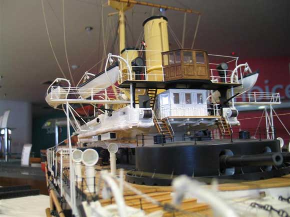

This followed his excellent model of the Victorian torpedo boat Polyphemus. Both are outstanding examples as models of Victorian naval ships in general and the design by Edward Reed of the Devastation in particular. As a point of interest, Devastation was the first RN capital ship to be completed without masts. John Hollis’s model provides a convincing impression of how Devastation may well have appeared soon after commissioning in 1873. A good example of this can be seen in Photo 2, showing the forward turret, which on the original ship was fitted with two 12in MLR (Muzzle Loaded Rifled) barrels and at 35 tons each they were no lightweights!
In this period many larger warships relied on what was termed Inglefield Bed Anchors, where each anchor was mounted on sloping steel castings. The anchor was secured to the bed by a means of small chains, termed shank painters or tumbling chains. These could be easily released allowing the anchor to fall free. Small cat davits for lifting the anchor on to the bed were located close to the anchor at the deck edge. These were hinged at the base and could be folded down on to the deck, allowing the guns an uninterrupted arc of fire, Photo 3.

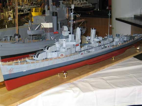

At the other end of the modelling spectrum there are models built using materials like litho plate. A good example of this is seen in Ron Horabin’s fine 1:72 scale Porter Class destroyer USS Moffett (D362). Constructed on a GRP hull, moulded from a plug entirely made from foam, a successful method developed by Ron to construct a one-off GRP hull. The superstructure was built up from a combination of ply and litho plate ( a thin aluminium), whilst that material also provided the outer shell and deck plating. Smaller fittings such as the gun director and the 20mm Oerlikon were from John Haynes with the remainder of the fittings including the gun barrels made from scratch by Ron.
Just as a footnote, the Porter Class of 1850 tons were the USN’s first large destroyers. Unfortunately USN destroyers, other than perhaps Fletchers, are seldom seen at shows in the UK, let alone at 1:72 scale and working as this one in Photo 7.

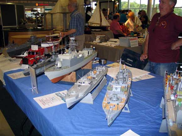

Clubs and vendors are the lifeblood of model boat shows such as Birchwood and there were a large number of models to view and clubs to see. However, I have a brief and as such focus the camera on all things that have a tinge of grey! Yet there were so many models and in particular warships amongst the club stands that it’s difficult to highlight all that could be seen. In Photo 10 is a small display of warship models by the North West Scale Model Boat Club that could be considered as popular subjects for the modeller. Although I did find the radio controlled truck with trailer and steam launch to be a fascinating departure from the norm., this combination did remain true to the theme of the show and it worked well, as the demonstrations were to show.
Best club stand
Over the years competition has become secondary to displaying the full range of models and skills. However, the accolade of best club stand is one where clubs can vie to promote their club and with a little bit of imagination and plenty of effort, they can display their members models to the best effect. This years winner was Kirklees MBC and amongst the models on this well presented stand were quite a number of warships. It’s always difficult to select a model, even though it may be just a personal choice and not one seen through the eye of a judge. Cliff Robertson’s model of HMY Britannia was simply outstanding, followed closely by the Stan Reffin’s escort carrier, which is still under construction. No doubt more words will be written regarding club stands and the models seen there, Photo 11.

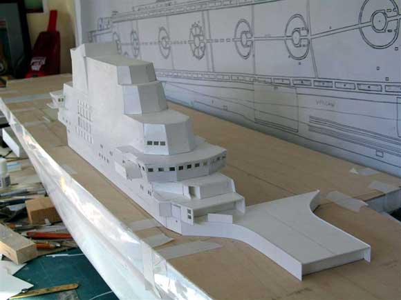

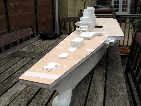

Continuing with the building of the Kiev and starting with just a quick reminder of where we were last issue. The build had progressed to the island superstructure and the methods used to complete the bulk of this large imposing structure. She possesses many features not repeated on other types of warships. Anyway, I decided that the next stage of construction would focus on the deck housings forward.

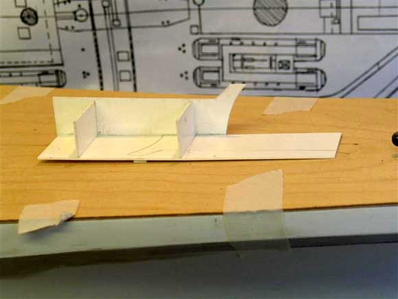

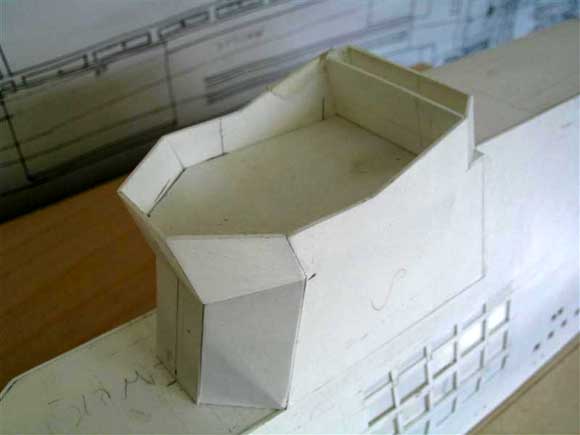

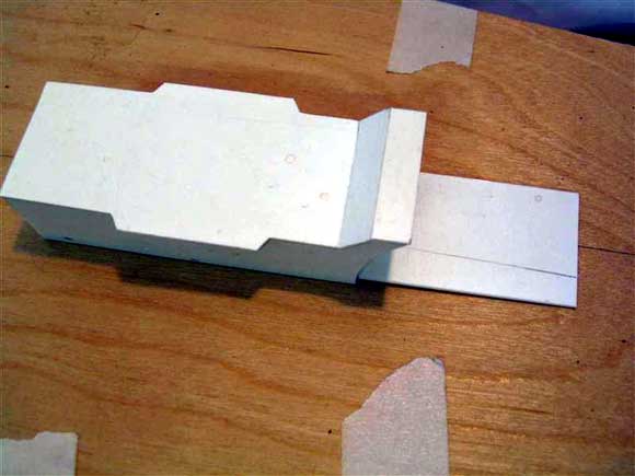

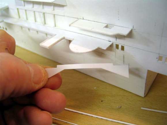

SA-N-3 platform

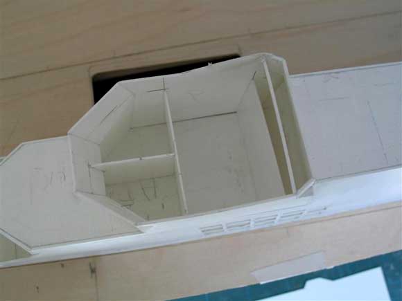

Immediately forward of the bridge is a raised deck housing that supports the SA-N-3 missile launcher, which at a later date will be surrounded by blast screens, but like the main island superstructure, this is made entirely from 2mm styrene sheet, with the basic shapes lifted from the plan using tracing paper and then transferred directly to the sheet styrene, Photo 17. The top was added and the completed structure slotted, but not fixed to the main island. As planned, the widest end rested where the deck was removable, thus effectively hiding the athwart ships joint, Photo18. Like all of the deck housings, this area was fitted with locating rods and pins, which allowed for the deck housings to be always located in the right position during the construction phase. Eventually this deck housing will be permanently fixed into position, Photo 19.
The 76.2mm gun platform
Once again, styrene was the material of choice for this platform mounting the forward 76.2mm gun, eventually to be flanked on either side by the massive launch tubes of the SS-N-12 SSM (surface-to-surface missiles). The 76.2mm dual purpose gun was fitted to a number of classes of Soviet warships from the early 1960’s onwards and with a rate of fire of 60rpm was well suited to installation on the Kiev class. However this deck housing like other parts of the support structures, includes a blast screen associated with the forward SUW-N-1 twin arm ASW (anti-submarine warfare) missile launcher. As with other parts, the 76.2mm DP deck housing was lifted from the plan and side elevation using tracing paper, then transferred to 2mm thick styrene sheet. Each of the individual parts, base, sides and top were cut and assembled into place. It’s worth noting that this housing is laid level and does not follow the shear line forward, see Photos 20, 21 and 22. Additional fittings such as access doors, piping, electrical switch boxes, ladders and the turret mountings will be fitted at a later stage.

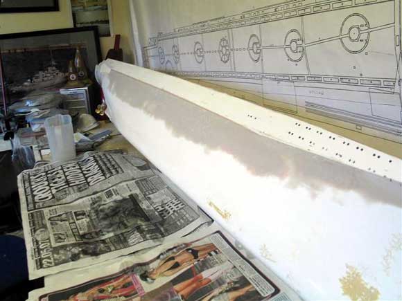

As mentioned in Part One, the original GRP hull required some remedial work to conform to the drawing and photos of the original ship. Further work was required to ensure that the upper part of the hull on the starboard side from the deck down to the knuckle was parallel and the hull was flush up to the knuckle and not forming a lip as originally moulded. This adjustment to the hull can be seen in Photo 28.

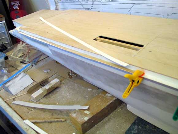

Deck edge walkways
Unlike carriers of WWII where the deck edge walkways often supported large numbers of AA weapons, on the Kiev this deck edge walkway is given over to liferaft containers, enough to ensure that all of the crew could evacuate the ship, Photo 29. These walkways on the model had to be robust enough to absorb the occasional knock that is a high probability on a working model. yet be easy to install. The solution was to cut lengths of 2mm ply to a size that allowed the walkway to be slotted into the side of the hull, see Photo 30. To provide a good surface for painting, 10thou (0.25mm) styrene sheet was cut and laid over the timber using R/C Modellers Glue, an ideal adhesive for this purpose, Photo 31.

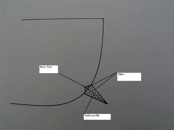

Bilge keels and stabilizers

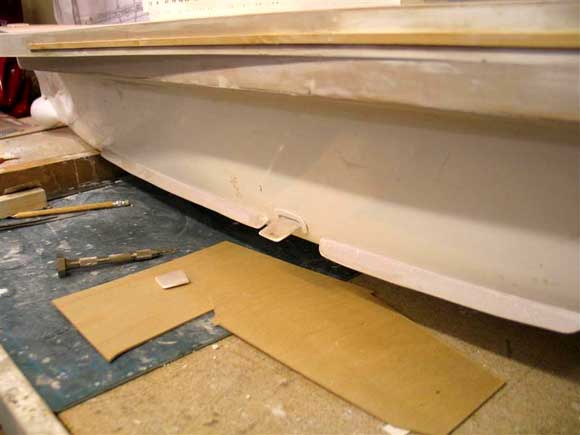

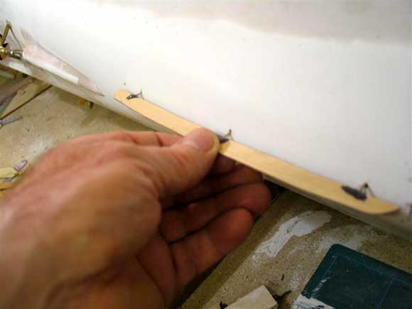

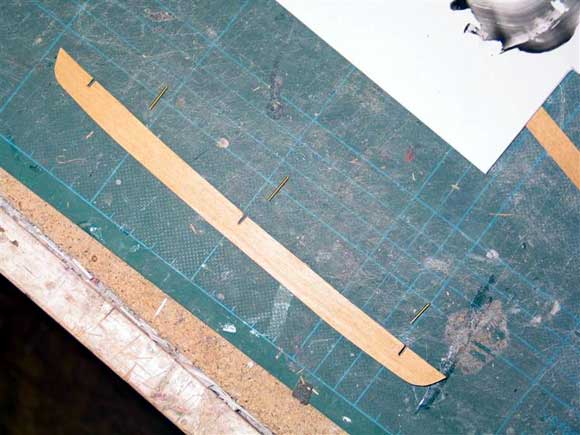

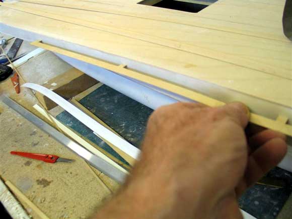

With the upper part of the hull prepared, attention was then shifted to the fitting of the bilge keels, in effect four separate strips cut to a length and width as shown on the drawing. In the absence of any definitive photo evidence as to the exact size of each keel the only option was to accept the drawing as correct. As a matter of interest, this possible conflict of information or lack of information can plague any model maker where accuracy could become problematic.
Methodology

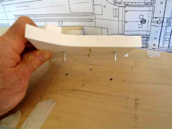

Four lengths of 2mm ply were cut and shaped to conform to the shape of the hull. The profile was then notched out to accept three brass pins, Photo 32. The prepared section was then be offered into position on the hull and at the point were each of the pins struck the hull this position was then marked. Each mark is drilled and the bilge keel offered into position as in Photo 33. The pins were then permanently bonded into place from inside the hull and fillers coated over the edge to form a shallow ‘V’, Photo 34. When set the fillers were gently rubbed down with wet and dry until a good even surface was achieved, Photo 35. Surprisingly, this simple method produces a remarkably strong bilge keel section that is both robust and can sustain impact.
Pic 33: Bilge keel profiles being set into place. Pic 34: The bilge keel in cross section. Pic 35: The completed bilge keels. Pic 36: With the shaft for the stabilizer set in place and at the correct angle, the option is available to have working stabilizers. Pic 37: The inner construction for the funnel casing. Pic 38: A temporary flat panel closes off the top of the funnel. Pic 39: Mystery Picture. Can you name all three vessels (authors collection)?
