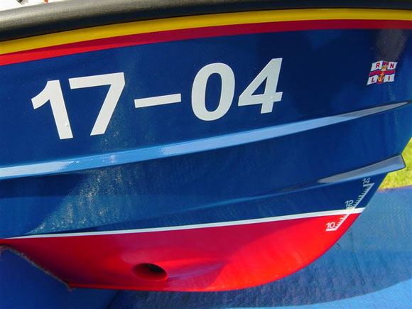

Painting
A model of this size requires careful thought on how and what to spray first, also where and with what. My normal method would be to use the Halfords range of acrylic hand sprays. The finish you get from these is superb, which is ideal for the smaller model and they work very well for the Severn fittings and superstructure, but the hull could be just a bit too big. Working on that assumption, I decided to see what alternatives I could use and where better to go than a local car spray paint supplier, Leonard Brooks of Harlow, Tel: 01279 417501. So after some hours of deep discussions on the various types of paint and application methods, the results included either acrylic paint applied with the use of an airbrush or medium sized spray gun, or a two-part paint product where you have to mix the paint and hardener together making sure you get the correct amounts otherwise problems will occur, plus it has to be thinned to get it through the spray gun. Another important issue with this type of paint is that it hardens chemically and will also do so inside your lungs, so it has to be applied outside, wearing the correct mask for the job. For me, the two part paint along with the chemical side put me off big time! All I wanted to do is to thin the paint and spray with the added bonus of quick drying, hopefully as quick as Halfords aerosol paint. Boy, have us modellers been spoilt!?
Further extended discussions came up with the final answer – synthetic enamel paint and surprisingly cellulose thinner applied using either a touch up spray gun – around £30 from Halfords – or a gravity spray gun at the same price. The air supply was from my normal large compressor, making sure that it could supply the amount of air according to the gun specification.
Synthetic paint colours used were Red Oxide for primer all over, British standard Oxford Blue No.105 and below the water line Satin Red No. 59. The usual note always applies. Never mix different paint types and always stick with the same acrylic to acrylic, enamel to enamel, etc. To obtain a good paint finish requires good preparation, all blemishes filed and sanded, and washed all over with mild soapy water and left to dry. Always spray light coats, not heavy ones, and sand lightly between every few coats of paint with a very fine wet and dry paper (1000 grade) and wash. Warm days are best for spraying, but if it’s very hot then pick a shaded area.
I was initially concerned regards using cellulose thinner at the recommended 10% mix, thinking it might react with the paint or GRP, but I realised that the idea of thinned paint allows for faster evaporation and drying time. According to the experts, using White Spirit as the thinner actually slows down the drying time. At the end of the day the finish was super and equal to that of acrylic. Sometime in 2007 there will be new guide lines as to what paint stores can supply, so things could get complicated.
Once sprayed I decided to leave the hull indoors in a warm location for two weeks while I was on holiday. By doing this you are making sure that all will be dried hard enough ready for a fine ‘T-cut’ to remove any blemishes and blend all in if needed. The decks were painted with my version of anti-slip which I detailed earlier and the kicker boards as well. For the superstructure, it being a bit smaller, I decided to revert to my old faithful Halfords aerosols – first coating it with white primer which shows any areas requiring attention, and once sorted the top coat was applied using VW Brilliant Orange, lightly sanding between coats. For this part and other items requiring the same colour a total of 10 aerosol cans was used.
All was then left for one week to dry hard. Other Halfords colours used were Satin Black, Toyota Silver, Appliance White, Red Oxide primer, White and Grey primer and Ford Polar Grey. For all other fittings my usual method of mounting them on some scrap wood and spraying them as a batch worked very well with any added detail picked out using Humbrol paints. See Photos 171 to 179.

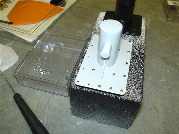

Hex Nuts Heads
On the full size boat there are over 1,700 stainless steel bolt heads left unpainted and in full view. Mostly they secure panels bolted to the outside of the wheelhouse and deck area. These are an important feature of the model which Speedline have gone to great lengths to reproduce, specially made from brass and plated with nickel silver which are stunningly effective on the model. Wherever one is located there is a pre-drilled 1.2mm hole to be found. Now fixing each hex head in position has been achieved by using a good quality make of superglue gel. My choice is Loctite and just a small dab is enough on the back of the hex head stalk to glue home, and with the aid of pair of small fine tweezers I could hold the nut tight across the flats, offer into position and job done. Only 1,699 to go!
A sure sign of old age is when you have to wear magnifying glasses. Anyway, after some six evenings of gluing, dropping, finding and the occasional bad word, all was nearly complete. Note this part can only be done after the orange spraying has been completed, since the hex heads need to stay in stainless steel finish and are a very important detail of the model. I have seen one model with them all sprayed orange. See Photos 187 to 190.

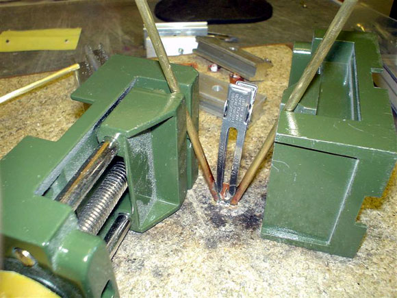

Mob Crane and Brackets
The ‘A’ frame part is made up from brass tube cut and filed to the correct required angles so that it meets at the top etched brass plate. On looking at the photos during the construction, other detail information can be obtained – like how it is retained and where the pulleys go, the rope route, etc. Pulleys are not supplied and have to be made or purchased. Luckily I had four spare in my unused fittings box from a previous build. The links have been made up from 1.5mm diameter brass wire bent around a pair of round nose pliers. The lower pivot point bracket and spacer is all part of the etched brass and Perspex set. Careful soldering is required with very little heat as the brass is very small and thin; too much heat would distort the brass. The spotlights supplied are castings, so if working ones are required then Bow Wave or Reade Plastics have a very good range to choose from. The cleats at the side have been made by bending two 15mm lengths of 1.5mm brass rod at 90 degrees and then mounting them through a rectangular piece of styrene and gluing them to the side of the wheelhouse. I believe resin cast ones are now supplied. I have used Robbe 1mm diameter white polyester model sail rigging cord, Part No.1319 for the pulley ropes and retaining top rope. See Photos 191 to 196.

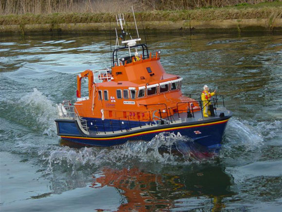

Running the Severn
Before running the model for the first time a ballasting session is required. Normally this can be within the confines of the domestic bath which is fine for the average size model, but we are talking big here and I mean big, so the choice of the local boat club pond is the order of the day for most. For me it’s a 100ft walk down to the bottom of my garden to the river, so transport poses no problem. I was concerned that it might need extra weight, apart from the two lead acid batteries, to bring it down to the water line. How wrong I was and so pleased as well, as once in the water (it took two of us to put it in there) it sat almost perfectly – just a little low at the bow which I felt that once under power would be immaterial.
During the build I always try to place any internal items of weight symmetrically either side of the centre of the hull, thus keeping it balanced, and it seems to work. Of course extra ballast is sometimes required, but not on this occasion which was great news – in fact amazing! After a full radio range and functionality check, all was ready. A little power was applied and that’s when the starting sound of the engines kicked in. What music to the ears! A little right hand down a bit and she moved easily away; a very positive response from the Electronize speed controllers as always and steering was very positive.
Once away from the bank I introduced full power and what a noticeable wash and wake from the stern. I even got my feet wet which was not part of the test! Anyway with the bow up, it was off, water coming off the spray rails just like the real Severn. A gentle slow down to a stop and a little reverse and the turn was just brilliant. Once the water had calmed down I decided to try out the bow thruster which worked to a degree, but not as positively as I would have liked, so a little tweaking of the props is required. However the model will actually turn in its own length just by using the rudders and forward and reverse motor direction, so no big problem really.
Overall a very pleasing run and there is no doubt that large models do look very realistic and now can even sound the part using the JJC engine sound modules. What more could you want. Running time from the two main batteries was around 40 minutes during which I applied full power more than dozen times at short intervals, so very acceptable. Next session on the water I do need to raise the bow slightly with a little extra weight in the stern, even possibly reducing the trim tab angle to allow the bow to rise higher under power. A relaxing, enjoyable sail especially after many hours of enjoyable hard work. See Photos 229 and 230.
