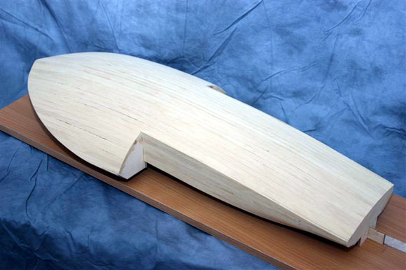

Now we came to the main planking; this needs to be done while the building frame is still fixed to the building board. I started with the full lengths and worked from the centre of the hull installing planks equally both sides so as to prevent any twisting of the hull during planking. This process can be seen in Photos 9 and 10. The planking continued until all of the top part of the hull had been planked, including the sides. At this point the building frame is still fixed to the building board, and now needs to be released. Photos 11 and 12 show the planked hull top after being released from the building board. The building frame now needed to be cut away from the hull so that the hull bottoms could be installed. This is shown in Photos 13 and 14 and was done with the aid of a hacksaw blade, as each frame had to be cut away from the building frame. This left the bottom of the hull to be covered with pre-cut plywood panels both for the stepped hull and the main hull bottom, not forgetting to cut out the opening for the prop shaft. Both the panelled bottom and the planked top can be seen in Photos 15 and 16 with an access panel marked out on the top. Photo 17 shows the hull with the access panel cut out and the rear fin temporarily fixed in position.

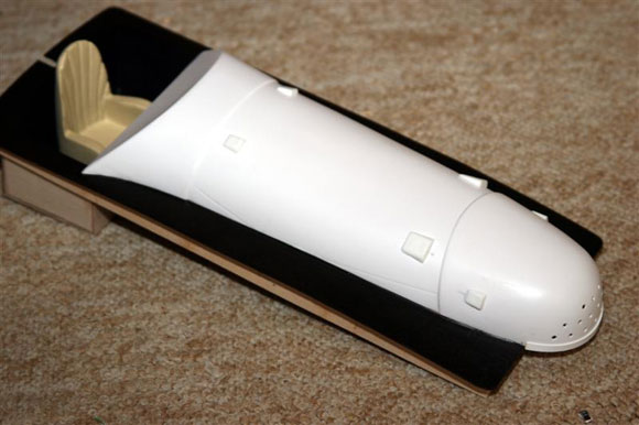

Before starting the veneer planking I constructed the engine cowling to fit the access in the hull top. The cowling was a one-piece ABS moulding mounted on a wooden plywood base and all made to fit perfectly before starting the veneer planking; this can be seen in Photos 21, 22 and 23. A bundle of veneer planking is provided in the kit and is more than enough to cover the hull. Marking a line along the centre of the hull top I started to mark in pencil the correct angle required for the whole length of the hull including the side parts. Starting in the middle of the forward part of the hull and then working towards the front and then to the rear, the veneer was fixed to the planking, again using R/C Modellers Glue, a PVA based glue. After all was dry I cleaned up the edges with sand paper. All this process can be seen in Photos 24 and 25. One tip when cutting the veneer strip is to use very sharp craft scissors, as cutting with a knife tends to split the edge of the veneer. With the whole of the veneer strip complete and dry, a rub down with some fine sand paper is all that is needed.
Just to seal the veneer I applied a coat of matt Humbrol varnish as this would protect it from any accidental marks during the finishing of the model prior to final painting and varnishing the hull. The engine cover as previously mentioned was an ABS moulding on a plywood base, and this item could be completed with the addition of the exhaust pipes, cockpit instrument panel and the driver’s seat. The exhausts were made from wooden dowel as supplied and the instrument panels and gauges were decals, which were also supplied. The finished cockpit was sprayed with gloss paint and then with two coats of gloss varnish, the same applied to the painting and finishing of the tail fin, with the decals being added before the final coats of gloss varnish. See Photos 26 and 27.

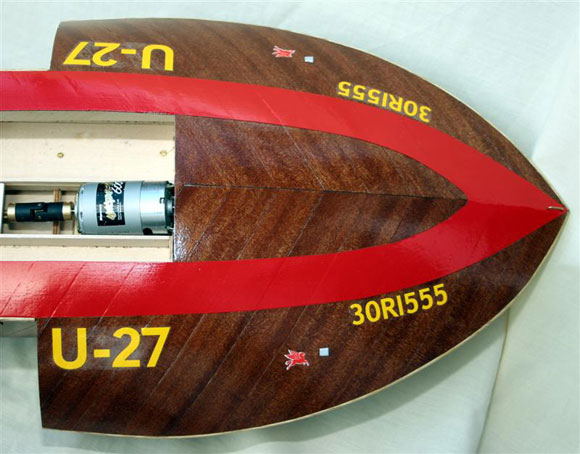

Painting of the hull consisted of a large red stripe running from the bow to the transom in an arrow design. This was done by marking out the hull with masking tape and then spraying with red Humbrol gloss paint, being very careful not to over run on to the veneered parts. As previously mentioned a small hatch cover was made to gain access to the rudder servo; this can be seen in Photos 28 and 29. The bottom of the hull was painted in a steel grey colour and given two coats of satin varnish to seal and waterproof the hull bottom as in Photo 30. The fin was the next thing to install, glued and pinned to the rear deck using 24hr Araldite glue, Also prior to final varnishing the decals were attached together with the fittings supplied with the kit, i.e., petrol tank covers, ventilators, etc. When complete the whole of the model was given four coats of Humbrol gloss varnish, carefully rubbing down between each coat. Decals and finish can be seen in Photos 31 and 32.

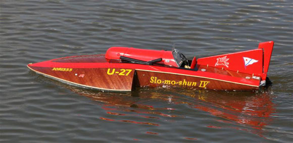

With the model now complete it was time for its maiden run. With the battery fully charged the model gave a stunning performance with exceptional speed and quite a good turning response. With a little better trimming which brought the bow up, to stop the digging effect, it performed a lot smoother on the turns.
