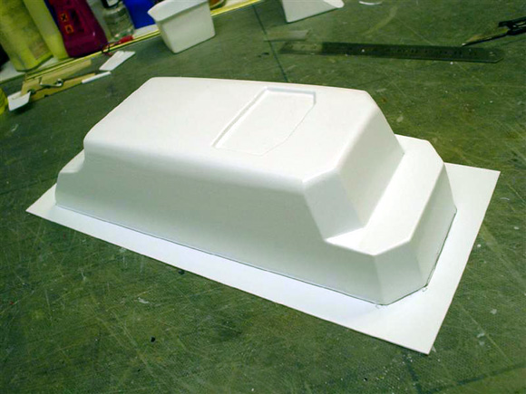

The assembly of this is very straightforward due to its one piece well moulded vac-forming (VF5), Photo 10. Do not cut too much material from the bottom of the superstructure moulding at this early stage, this will be trimmed down later.
The areas that require cutting out have been indicated partly engraved on the vac-forming as a scribed cut line, but do follow the drawings as well. The use of scissors or a sharp knife would suffice in cutting out, followed by a light sand down with abrasive paper. The sloping back of the superstructure needs to have a 2mm lip or return edge all around. Two sidewall printed part doublers (P11), need to be cut out from the printed part sheet, Photo 11 and glued in place, Photo 12. Once these are in position, the rear bulkhead (P10) position is also then established. The cockpit was next is to be assembled, Photo 13. This is a simple box like construction, the use of a small engineers square or a small piece of square wood helps in the construction just to get the side pieces square to the base. It is worth noting that the printed parts if cut to the line (or very close) will be square on assembly – a good sign of quality printed parts. Its final position once any join lines have been filled with the use of Humbrol model filler and lightly sanded down, is to be glued to the underside of the main superstructure. Cutting out the windbreak VF6 moulding, Photo 14, could be a little fiddly as you need to leave a 2mm lip (or return), all around for gluing . Once again the limitations of vac-forming can cause the plastic to be thin in tight corners and one thing that styrene solvent glue does eat well is thin plastic, so once again take care at all times. I always find that a small brush with only a few hairs on it holds less liquid glue and that way just enough is applied to do the trick. For the window positions, Photo 15, I transferred all the required dimensions as per the plan,. Then as per the instructions, I cut lengths of printed styrene P21 to create the window frames these are very fine straight lengths of plastic, so a nice sharp blade is required here and 300mm long straight edge ruler, preferably a metal one. Once cut, the best way to hold the strips in place on the model during gluing , is with small lengths of masking tape making sure that the plastic is on the pencil mark and apply the glue with a fine brush only around the window edges and not the entire length of the plastic, once set the non required plastic strip can then be trimmed back with a scalpel or sharp knife by two light scores and broken away gently. Once complete, the inner window part can then be cut out and removed, Photo 16. The same plastic strip, P21, is also used around the front cabin lockers as per the plan, Photo 17. The roof strips P22, which have to be added, need to be spaced as per the plan, working from a centreline easily worked out, with the first ones 2mm either side of it making the spacing between each, 4mm until ten in total have been fitted. The engine room companionway is assembled from printed parts, P32-P34. Once again no real assembly problems here, just cut and file the two curves as per the printed marks.

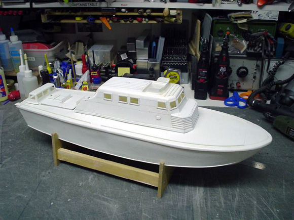

There are two lockers that need to be made up, which combined with the front locking tongue secure the cabin to the hull. These two boxes locate on the inside faces of the rear sidewalls of the cabin each having a length of bent brass wire to make up the latches. The sequence of fitting the superstructure or cabin is clever and very simple. First lower the cabin onto the deck opening, the rearward pointing pins fitted to the deck locate into holes in the locker-boxes first, then by pushing the cabin forward once the pins are located, the front underside tongue engages into the front hull slot piece, P4. Simple and very effective and this slot piece can be seen in Photo 33.

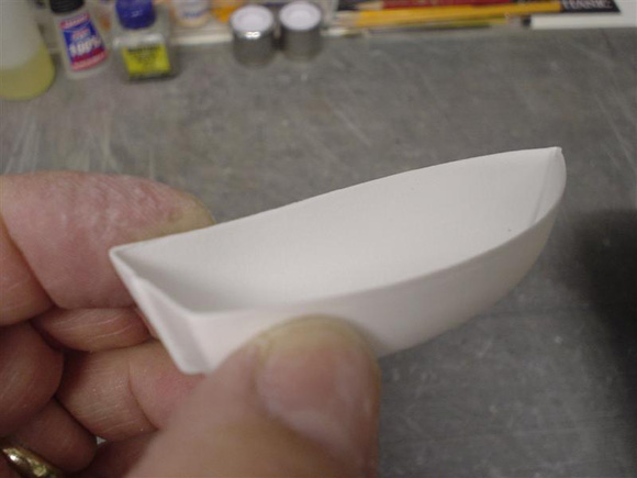

This vac-formed part requires cutting and trimming to shape as required, making sure that the top curve up to the point of the bow is the same both sides, Photos 18 and 19. The final position on the deck once it is painted, is upside down on two stands, cut and shaped as per the printed parts, a very simple job – nothing too difficult, just cut, trim and paint!
