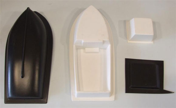

You get what you pay for. Thus when you pay less than ten pounds for a boat kit you don’t get a lot. To be precise, what you get are four bits of vac-formed plastic and a plastic bag, Photo 1. No fittings and best of all, no instructions! ‘Best of all?’ I hear you ask. Well in this case yes. In fact when I bought the kit George didn’t even have a finished model on his stand, so I didn’t really have any idea what I was going to build. What I did have was the freedom to do what I wanted without anyone telling me that I had got it wrong.

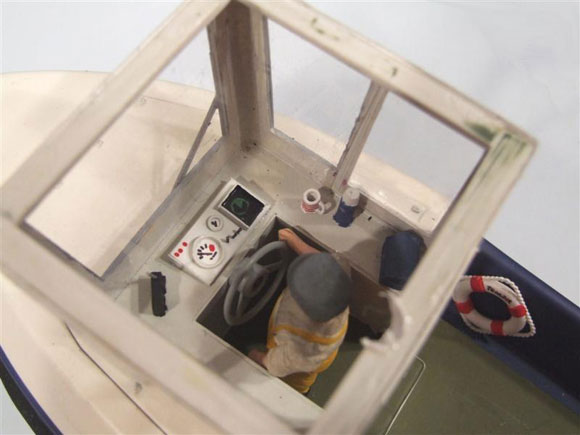

One mistake I made when buying my kit was not to buy a crew at the same time. Having a suitable figure makes it easier to work out where things should go in the wheelhouse. The skipper comes from George’s range of 1/32nd resin figures. When he arrived I felt he was a bit short, but managed to insert 4mm into his legs above the wellingtons, Photo 8, using bits of plastic, superglue and filler. Once painted the addition is invisible, Photo 9.
Before fitting the roof I took the opportunity to add some details made up from scraps of plastic such as a mug, flask, instrument panel and radio, Photo 10. With such large windows (glazed after painting with clear plastic recycled from the collar stiffeners of new shirts, I felt something had to be done to bring the area to life. The roof had to be trimmed to size and then stuck to some plastic as it’s larger than the top of the wheelhouse to allow for an overhang. Based on pictures of real tugs, I added a mast from plastic tube along with lights from various sources, Photo 11. The mast acts an aerial tube – I fed the wire up from inside the bottom end and glued it at the top.

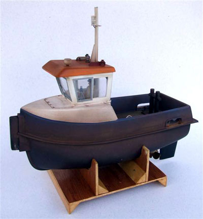

A much better and tolerable performance, Photo 13. The deck stays dry even at top speed and in tight turns. The model will turn in 30cm diameter circles which makes it possibly too manoeuverable – or at least it was in the steering competition. Steering astern isn’t bad although you need a bit of thrust to make the rudder take effect. The position of the battery is critical in keeping the craft level. Ideally it would be lower in the hull but then I’d have to reposition the servo making the rudder linkage awkward.
