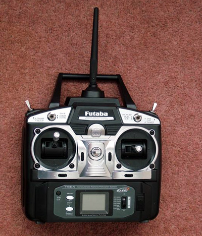

Pic 4: Transmitter. Pic 5: The transmitter display. Pic 6: Receiver. Pic 7: The receiver showing red LED. Pic 8: The receiver showing green LED. Pic 9: Rear of the transmitter showing green LED – note CE label – don’t buy one without it! The ReceiverThis is quite compact (measuring 1.64 x 1.08 x 0. 36ins or 41.6 x 27.5 x 9.2mm) with the servo connections and switch harness at one end. The aerials, yes there are two, emerge from the other end. These aerials should be positioned so that the angle between them is a 90º right angle and they should be kept as straight as possible. Care should be exercised to keep the aerials away from large metal objects and as usual away from drive motors, electronic speed controller etc. As with all radio systems, a range check should be carried out before use. This system has a ‘Power Down Mode’ to make this process easier. With the Mode Key held down and then the power switched on, the output (RF) power is reduced. The model’s functions should be operational from thirty to fifty paces away. After one minute, the power will return to the normal level. The system has a couple of other functions. It has a trainer setting, primarily for aircraft modellers and a throttle-cut function which may be useful for i.c. boat modellers. The servos are exactly the same as the normal ones currently in use – if you want miniature or larger ones then just as with normal 27 and 40MHz equipment they can be purchased separately. When first available these systems were about £200+, but market forces are playing their part and the price has been driven down and a bit of searching will find these systems on offer around the £150 mark. I purchased mine from Inwood Model Supplies, tel: 01480 411519 (there is also a web site – www.inwoodmodels.co.uk)) for £134.99 plus £6.00 delivery. I also purchased the optional spring and plate for the left hand stick to replace the ratchet for £1.99. All I need now is a new model in which to install it permanently!
