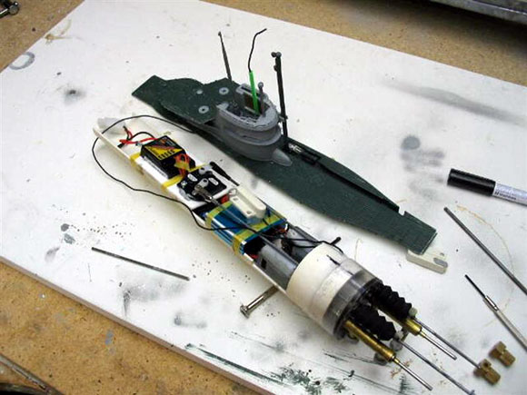

During the long and laborious task of cutting out all of the flooding holes in the kit’s hull, Wayne and I worked on designing and building the water tight compartments for each of our models. Photo 6 shows our final design. For the clear tube we used a fish tank vacuum tube with a 40mm PVC inner tube as a tray cut in sections to house each of the internal components.
After that it was time to plan and organise just how to hook up the rudder posts and dive planes with the two sets of push rods coming out of the WTC. Photo 7 and Fig 8 are an attempt to illustrate how I’ve done it. With this setup the dive planes work opposite each other, meaning that when the bow planes produce ‘down force’ the stern planes produce a bit of ‘up force’, making it very easy to dive the model. The next hurdle was to sort out how I was going to easily insert and remove the WTC from the model. In what initially was a drastic move I decided to cut away the port side, mid section of the model, following the lines under the ballast bulge of the U-boat casing. Photos 9, 10 and 11.

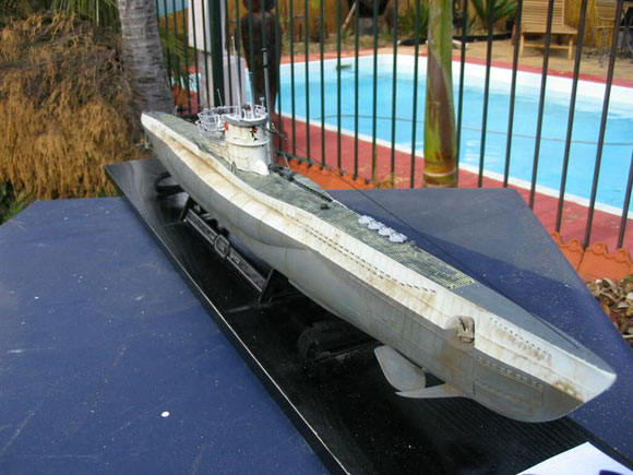

Oh yeah, diving tests. I consider myself to be your average modeller and that means getting the thing in the water and working properly before I actually finish building it. To that end I had to fasten the deck sections down with elastic bands during testing so that they didn’t float away. Photo 14 shows the first day’s testing in my pool, sorry test tank. Again, I needed the help of Wayne Baker to drive the sub while I took the photos. I had a go later. To say that this was fun is a gross understatement. I found it so much of a challenge to think and sail in three dimensions that I didn’t want to stop. Unfortunately the batteries needed a rest after about 20 minutes of full throttle and reversing so I had a break and celebrated with a beer or two. This model performed amazingly well. After I made some minor adjustments on the dive plane angles she dived really easily with not that much throttle and cruised nicely along the bottom of my pool at a depth of four feet.

The best way to do this was to run the antennae wire up through a tube in the conning tower. I made sure to seal the top of the wire so that water doesn’t come in contact with any bare wire. The tube I used will be painted to look like it’s meant to be there. Photo 15 shows how the PVC tray is removable from the clear tubing of the WTC. She works in the pool but does she perform as well in the Hubertus MBC lake? You’d better believe it! See Photo 16.
