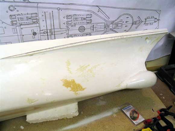

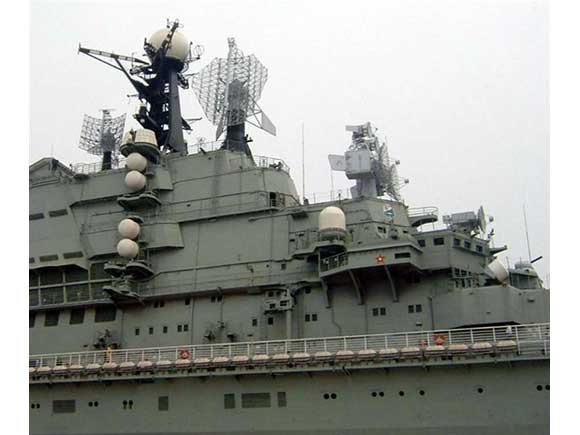

Pic 1: The GRP hull, deck and superstructure, which formed the bulk of the Kiev Kit at 1:144 scale. Pic 2: Kiev at anchor. Pic 3: The graceful lines of the Kiev. Note the unusual stern. Pic 4: Helix Ka 27, like the Kiev’s Hormone KA 25s uses contra-rotating rotors. Pic 5: Kiev’s radars from left to right ‘Top Steer’, ‘Top Sail’ and the forward “HEAD,’ LIGHT’ pair. The white-coated radar domes are part of the ECM outfit and are still termed ‘Side Globe’ in NATO nomenclature even though the Russian names have been available for many years. The radar array mounted atop of the Bridge is referred to ‘Owl Screech’. Pic 6: Modellers draughts of Russian origin and used as reference.

The kit manufactured in the Ukraine was, without being unkind, disappointing. The drawings were less than adequate and there were no instructions of any kind. However I convinced myself that these were minor problems, until I saw the hull, deck and superstructure, which were all moulded in GRP. The hull although well made was in a number of respects deficient in shape. The deck was far to heavy with the shape of the superstructure also open to question. The kit was made as a static model hence the moulded GRP deck. Many of the fittings were also open to interpretation. On the other hand, the scale was perfect and to be fair my enthusiasm remained undiminished and perhaps even clouded my better judgement, Photo 1.

Air defence was provided by a combination of the longer range 55km SA-N-3 Goblet (NATO code) launcher just forward of the superstructure and two retractable SA-N-4 Gecko to provide short-range (15km) point defence (similar in purpose to the Sea Cat system deployed on RN ships of the period, but operationally different). The second of the two retractable launchers was located on the starboard side immediately adjacent to the after 76.2mm/60. Also located forward on a raised deck housing was the forward 76.2mm twin naval gun and forward of that the SUW-N-1 launcher for the FRAS –1 (Free Rocket Anti Submarine). This was a weapons system of last resort, as it was a short range ballistic nuclear weapon, unguided and with a limited range of 30km could be seen as a weapon that there would be some reluctance to make use of!
Air Group
Like the RN Invincible class, the Kiev’s operated the YAK 38, a VTOL aircraft but unlike the Harrier this used a combination of two dedicated forward lift engines and a single dual lift cruise engine. This configuration was to provide a greater lifting capacity, but failed in a number respects to live up to expectations. Scratch building these to 1:144 scale will be discussed later in the series. Kiev also operated a combination of two types of helicopters. The Hormone B for targeting and the Hormone A for ASW. Unlike helicopters in NATO navies, Soviet carriers like Kiev used the Hormone and the later Ka 27 Helix, with a system of contra-rotating rotors, Photo 4. For bringing aircraft from the hanger spaces below there were two elevators. One adjacent to the superstructure amidships, another sited abaft of the after 76.2mm gun and also a much smaller elevator for accommodating deck vehicles and ordinance. Certainly peculiar to Soviet /Russian warships is the extensive use of a narrow gauge track, which is sited along the deck both fore and aft for the movement of ordinance and other equipment.
Radars
Unlike the present generation of radar arrays, where reduced radar cross section and phased array determine that these radars form an integral part of the superstructures, those used on Soviet warships during the Cold War were the very antithesis of the new generation of modern radars in their construction. An example of which is the huge ‘Top Sail’ long-range 3D Air Search early warning radar and the ‘Top Knot’ spherical navigation radar. As we progress through the construction of the model, many of these features will be highlighted and explained, Photo 5.

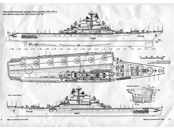

As mentioned in the preamble, the kit was bought in Germany and was of Ukrainian manufacture. Also mentioned were a number of deficiencies in the shape of the hull form forward. However having a modeller’s drawing of Kiev was the catalyst that allowed the kit to be built. This drawing can be seen in Photo 6.

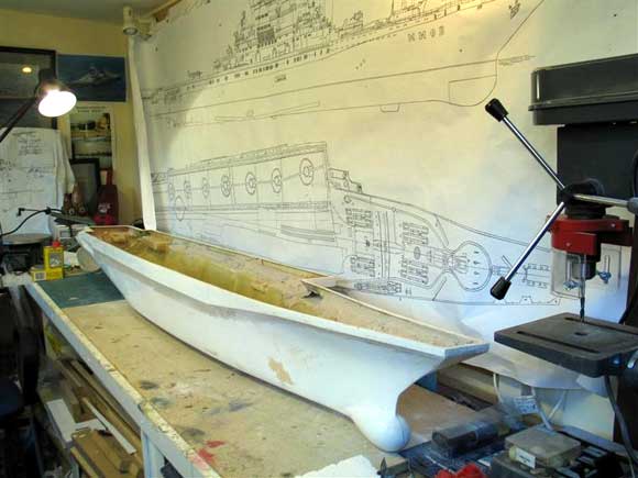

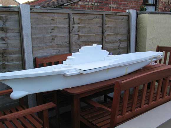

After assessing where the hull needed to be altered, work on the model could begin. Essentially the two most noticeable features that required attention were the shape of the forward upper knuckle and the shape of the angled deck. Both of these features can be identified in this superb photo of Kiev towards the end of her life as an operational carrier, Photo 7. Note the shape of the upper knuckle and the fact that on the model this was to exaggerated in depth and needed to be reduced and given a sweep that conformed to the drawings.
Pic 17: Re-working of the AK 630 Gatling sponson to conform to that on Kiev. Pic 18: Cut to shape the underside is re-worked. Pic 19: Looking down on the AK630 sponson. Pic 20: Preparations for rebuilding the underside of the flight deck overhang. Pic 21: Timber strip added to and raised clear of the original sponson. Pic 22: A timber strip of 1.5mm marine ply sited to increase the depth of a re-worked support sponson. Pic 23: A section 1.5mm thick marine ply forming the new sponson. Pic 24: The sponson covered and re-worked. Pic 25: Deck overhang sponson with AK630 support sponson completed.

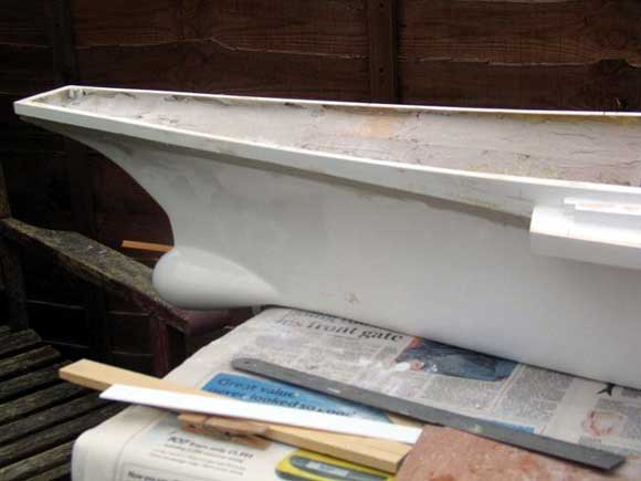

Altering the Bow Knuckle

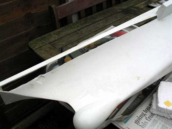

Alterations to this part of the hull involved the amended shape to be lifted from the drawing and transferred to a plastic profile, which was put in place against the existing bow section, Photo 8. A line was scribed, the former removed and a cutting wheel was used along the line as in Photos 9 and 10. In order to maintain the sweep of the hull upward a section of the hull approximately 25mm diminishing to 10 mm was cut and removed, leaving a section of hull as in Photo 11. Note that to maintain the integrity of the hull forward only one side was removed at a time.
The gap was covered internally with zinc mesh, the sort of material readily available in car accessory outlets. Followed both externally and internally by fillers and generally rubbed down to conform to the sweep of the hull up to the re-aligned knuckle, Photo 12. With the final result conforming reasonably well with the drawing and that seen on the full size vessel, Photo 13.

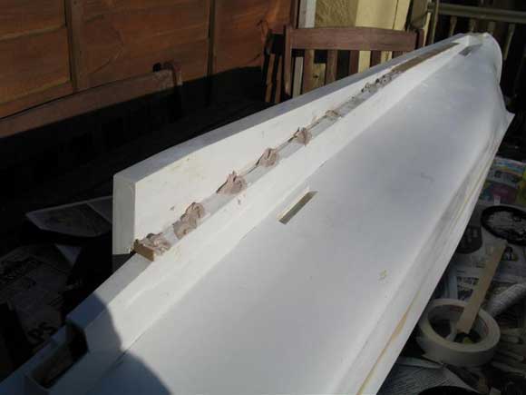

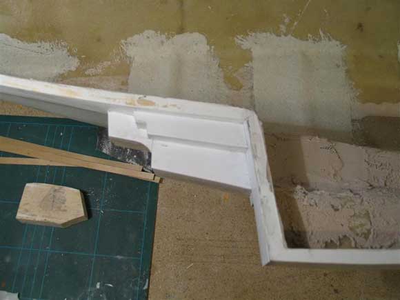

Amending the Angled Flight Deck.

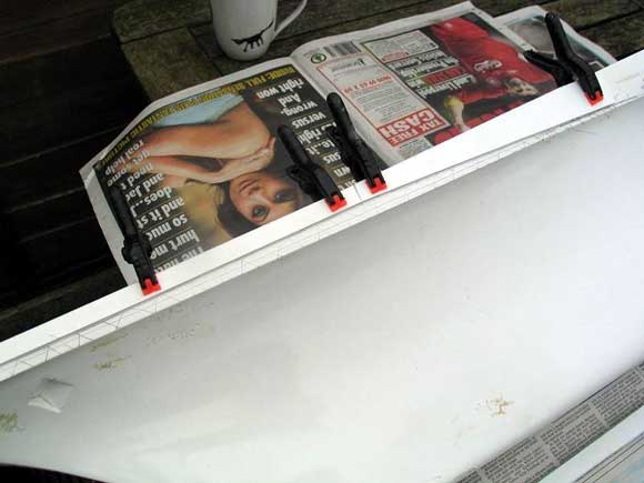

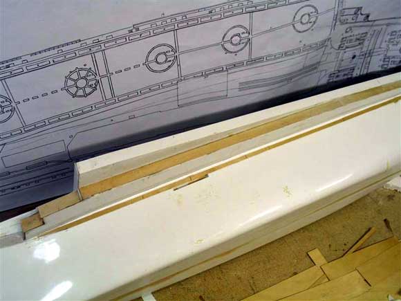

Kiev possessed an angled deck of five degrees to port from the centre line. This feature was fitted to create more deck space and had no relationship to take offs or landings as on USN carriers. The angled sponson supporting the deck was moulded as part of the hull. However it would appear that during the curing process this sponson pulled downwards and would have been impossible to lift up to give a straight line athwart ships and marry with the deck. The only answer was to separate part of the sponson from beneath and along the forward edge, thus releasing the tendency for this part of the moulded hull to slope downwards, Photo 14. This simple expedient allowed the sponson the freedom to move upwards and regain its level athwartships. Zinc mesh and fillers were added to reinforce and bond together the separated sections of the sponson, Photo 15 and 16. Note the lip along the deck edge. This would eventually provide a good seating for the deck without the need to add any additional deck edge stringers.

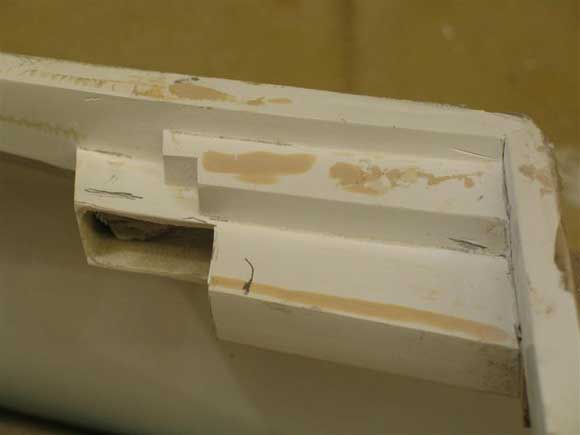

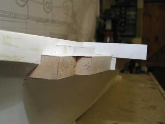

Amending the 30mm AK630 CIWS Platform
As mentioned above it became necessary to separate the angled sponson from the forward 30mm gun platform. However this platform, which was also part of the moulded hull form, was of the wrong shape, refer back to Photo 1. The shape was lifted from the drawing and the alterations took the form of removing part of this sponson creating an ‘L’ shaped section as in Photo 17 and reinstated as per the shape seen on Kiev, Photo 7. The material used in reshaping this platform consisted of 1mm ply for the lower sections and 20thou. styrene sheet for the upper part, Photos 18 and 19.

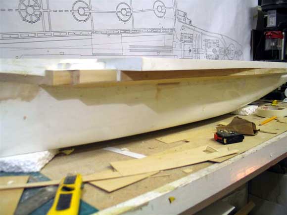

Amending the lower sponson
The lower sponson, which adds structurally to supporting the angle deck, needed to be re-shaped to give the correct depth. Although this part of the hull was in fact moulded in the generally correct shape, the angle of slope and depth did not conform to the drawing or the photos. The first task was to alter the initial shape by lifting the sponson 15mm clear of the existing moulding. This involved laying out and bonding into place a timber strip, Photos 20 and 21. A further strip of 1mm ply was sited as per the depth required, beneath the existing lower sponson, Photo 22. Here the sloping section could be fitted into place as in Photo 23, extending to the entire length, Photo 24. Note that to conform to the curve of the side of the hull the length was divided into 5 segments. The completed results conform to the plan even down to the sharp slope upwards into the lower part of the 30mm CIWS platforms. With the depth of the lower sponson increased, the existing opening into sides of the hull was almost covered. Thus a new opening needed to be provided for which conformed more accurately to the drawing and original pictures, Photo 25.

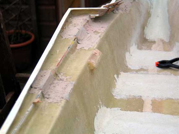

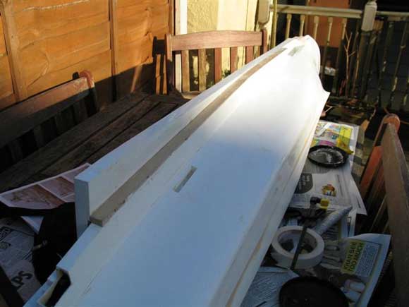

Decking

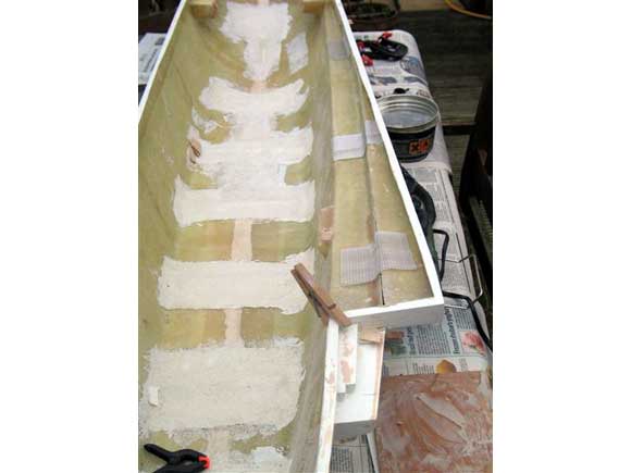

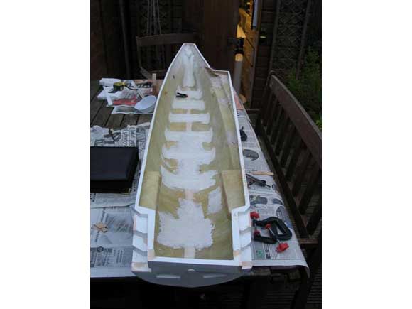

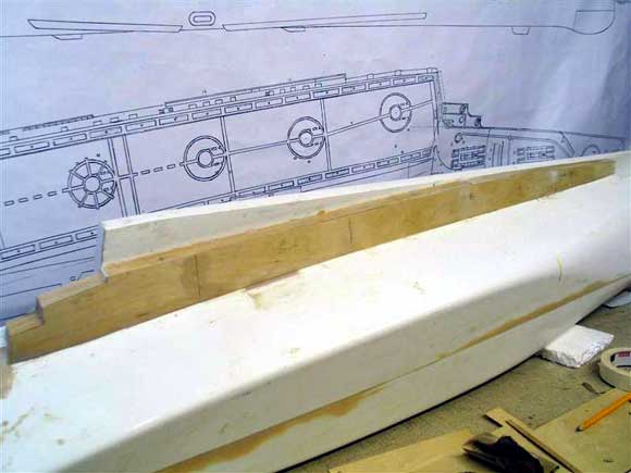

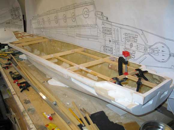

Originally the GRP deck was to be self-supporting. However as this deck was discarded in favour of a marine ply, the inside of the hull at deck level needed to be braced to support the timber deck and provide strength and rigidity. The timber of choice for the bearers was ramin using a combination of 15mm x 6mm for the athwartships bearers whilst lengths of 8mm square were used for longitudinal bracings. A space was left clear amidships to allow for the deck opening bearers, which were added later once the size of that opening was determined, Photo 26.
When building a hull from scratch or if using a GRP hull, I prefer to have the deck inside and flush with the top of the hull, but with the Kiev hull this was not possible. Thus the deck had to fit on top of the hull as shown in Photo 27. Once marked and cut to size the sections of the deck were temporally secured to the hull with masking tape (the majority of the deck sections were to remain temporary, until ballasting and sea trials were completed), Photo 28.

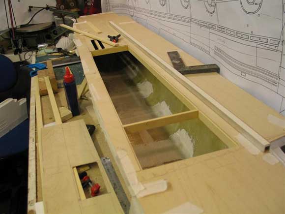

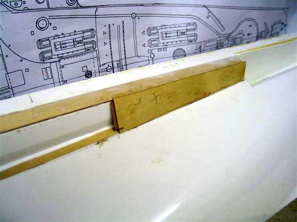

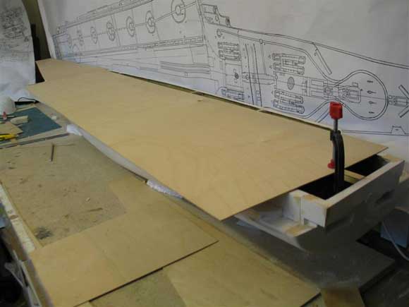

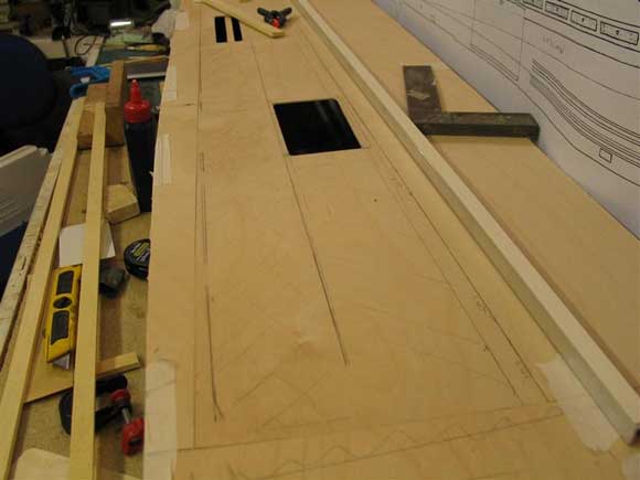

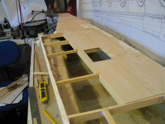

The next task was to remove a section of deck that would provide access into the hull for batteries etc. When building carriers with expanses of uninterrupted deck space the problem faced is to make that all-important opening as unnoticeable as possible, which is often quite difficult . Personally when providing for opening on warship models such as destroyers, cruisers, etc., the aim is to minimise, if not eliminate any obvious cuts along the deck and use the edge of the superstructure to define the size of the opening . With warships having superstructures within the centre of the deck area, achieving this aim is less problematic, but with carriers another approach is necessary to achieve the same results.

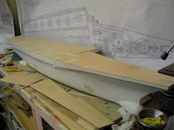

When building Moskva the entire flight deck was a single piece of styrene, which in retrospect was an unwise choice, as styrene in large unbroken areas has a tendency to warp, whereas timber is more stable, but requires greater effort to achieve a good painted surface. That leaves aside the fact that Kiev had heat resistant tiles 50cm Square laid across 50% of the deck space, a feature for the model that remains to date unresolved .
To give the maximum access with the minimum of visible cuts into the deck as discussed earlier, it was decided to follow a line that corresponds with the separation of the angle deck and parking area, a division emphasized by two parallel white lines running fore and aft on the angled flight deck, this can be seen clearly in Photo 29. The positions of the flight deck, and main elevator were worked out using a combination of drawings and photos. The results can be seen in Photos 30 and 31. The island superstructure will eventually sit on the area of deck forming the hatch.
The deck access hatch now follows the lines of the parallel white deck markings and the forward SA-N-3 deck-housing and hides the athwartships cut, Photo 32. Once removed the hatch is reinforced with cross bracing timbers of ramin and made to fit snugly into place with almost no gap, Photo 33.

Pic 26: Deck beams fitted into place. Note that there are no side stringers and the thickness of the deck edge seating (2mm) has been taken into account when fitting the athwartships deck beams. Pic 27: Sections of 1.5mm marine ply moved into place to provide the best coverage and reduce waste from a 4ft x 1ft sheet. Pic 28: Each of the four-deck sections temporarily held in place. Pic 29: The inner white parallel lines along the flight deck are used on the model as a cut line for the hatch. Pic 30: With the deck hatch and elevator opening cut to size, deck beams were set in place to accommodate the angled deck. Pic 31: The hatch in place. Note the lines/cut adjacent to the straight edge. This corresponds to the fore and aft white broken line on the flight deck and will be almost invisible to see, when the deck is painted. Pic 32: A spacious access not only for batteries but also maintenance. Pic 33: The deck hatch will also provide support for the entire superstructure. Pic 34: Mystery Picture.
