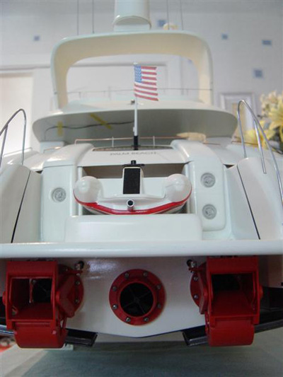

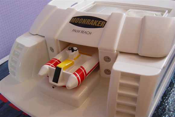

Pic 04: Aft detail showing the inflatable boat. Pic 05: Inflatable boat showing good use of ‘Trimline’. Pic 06: Rear cabin detail. Pic 07: Side view. Pic 08: View from above showing the roll over mast detail.

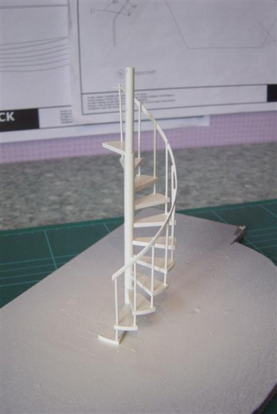

Pic 09: Spiral staircase assembled and ready for fitting. Pic 10: Close up of spiral staircase and table and chairs.

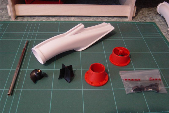

There are three of these to construct. They come with their own set of instructions and are a relatively straightforward process to put together. They work on the principle of an impellor assembly that draws in water from the inlets on the underside of the hull and propelling it through outlets on the transom underneath the rear step, so causing forward motion.

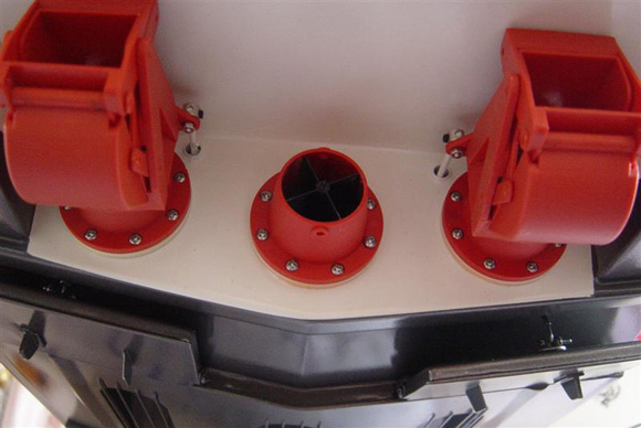

Reverse motion is brought about by actuating the bucket assemblies which divert the thrust and also rotate to steer the vessel – really neat! Once initial work on the aft section of the hull is completed there came what I found to be one of the most important and crucial parts of the build – the installation of the units into the hull. It is very important to follow the instructions carefully at this stage with regard to the fitting of the impeller shafts so they do not bind, and critically pay attention to the sealing of the units to the hull inside and out. I rubbed down the areas for adhesion with silicon carbide finishing paper (my choice of abrasive available from B&Q). This is imperative to key the ABS plastic prior to gluing with two-part resin (again my choice is Stablit Express which I have found to be very reliable when a good bond is required).
On the underside of the hull, once the propulsion units have been installed, I used Humbrol Model Filler to seal and tidy up the join. Only then were the inlet guard rails affixed. These stop debris – leaves, small twigs, etc., entering the units and ‘clogging up’ the system when underway.

Pic 11: Business end showing the outlets and reversing mechanisms. Pic 12: Trim tab assemblies. Pics 13 & 14: Internal view showing the motors, servos and linkage assemblies. Pic 15: Alas the Captain could not find any bikini-clad beauties aboard so he drowned his sorrows in a couple of crates of beer! Pic 16: Superbly detailed aft section.

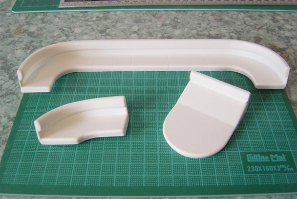

The superstructure consists of a number of vac-formed parts with the cabin windows pre-cut, saving a lot of time and effort. Although there is only minimum internal bracing the whole assembly is quite rigid. A simple affair of putting these together was made only slightly more difficult by the cutting out of the roll over mast from vac-formed parts and affixing these to the main superstructure. I found it important to pencil mark the cut lines on these vac-mouldings, cutting back to just before the marked line and then sanding back when satisfied all is well. The upper deck also makes good use of vac-formings for the seating arrangements, sun bed and tables on this luxurious vessel.

Once painting is complete the fittings can be attached and also work can be started on the small boat which is attached to the rear step. In this case the boat was first painted and then trim line used to ‘decorate’ it. For the seat I used a ‘fluffy’ strip of Velcro. At the aft end of Moonraker is a small access hatch (vac-moulding) which has a table and eight chairs attached to it. I spent quite a long time masking off these parts and spray painting them, but the effort is worthwhile. At the same time I affixed the two large glazing pieces for the sliding doors – nice part of the boat this. Other fittings such as lifebelts are placed as indicated by the plan and instructions.
