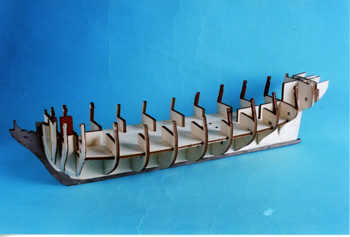

The Hull Construction
There was an excellent pictorial guide to supplement the instruction manual for this part of the build and no problems were experienced in making the basic hull carcase. All the pre-formed parts were accurately produced and no fitting was required to assemble the bulkheads to the keel. However, sequence was important and I would repeat the manuals advice that the edges of the bulkheads and the plank termination pieces be roughly chamfered before using the glue.
I also prefer to chamfer the rear faces of the keel below the bearding line to avoid very thin rear edges to the subsequent planking. The rudderpost was not therefore put on until after completion of the planking. This is a personal choice and not a criticism of the design.
Once the main hull framework had been completed and all the required bulkhead edges finally chamfered to provide full-width seating for the planks, Photo 1, the main gun deck was planked on the fore and aft areas indicated in the manual, Photo 2. I used white PVA adhesive for this task and, when completed, large headed drawing pins held down the edges of the deck (planks uppermost) while the glue dried. This prevented warping and difficulty in fitting the deck to the hull. While the glue was drying, I painted the beams and the bulkhead extensions in those areas covered by the subsequent fitting of the upper deck and forecastle. (There is always some clever dick going to look at your model with a dentists’ mirror).
After rubbing down and varnishing the planked deck, I used a fine scalpel to cut the deck down the centre line into two parts. This facilitated the fitting of the deck to the hull. However, it should be remembered that any adjustment required should be done by trimming the deck edge slots and not by removal of material from the centre-line edges.
With the main deck glued in place, the next stage was to put the deck fittings in place, since once the upper decks are in position access is denied. These items were simple to make but a couple of points for the less experienced may be of help.
The forward riding bitt assembly comprising parts 46 and 47 were best put together on the bench, the unit then dropped into the holes in the deck and Parts 57 then glued in position.
The capstan main spine should be cut from 10mm diameter dowel and not 8mm as indicated in the manual. This is fairly obviously a printing error witnessed by the size of the holes in the pre-cut parts. The 22mm length suggested may need trimming down after assembly to permit the bottom face of the lower part 105 to fit flush down to the deck. Failure to achieve this state will result in the top of the capstan fouling on the underside of beam No.9a.
When making the gratings, it was important to get things the right way round and note that the top faces of the battens, which run fore and aft, are to be seen in their entirety. This state is correctly shown in the hull construction manual. The assembled parts are shown in Photo 3. The upper decks were then temporarily pinned in place and their edges blended with the edges of the bulkheads to provide correct seating for the pre-formed gun-port strips. These needed about an hours soaking at the front end to make them more pliable. Even so, care was needed in introducing the bend where the weakest sections occur at the first and second gun-ports. Once their correct position had been established on the hull framework, they were securely pinned and glued in place, remembering that the ‘midships bulkhead extensions had to be removed at a later time in the construction. When the glue had dried, the stern end of each strip was trimmed up to match the contours of the stern counter patterns, Photo 4.
The fore deck beam was then glued in place, being held with clips while the glue cured. This part (No.39), was a little shorter than the distance between the gun-port patterns and was be fitted centrally to leave an identical gap each side to take the bulwark planking to be done later.
Image 1
Pic 12, Pic 13, Pic 14, Pic 15, Pic 16, Pic 17,

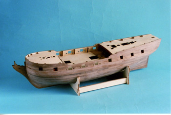

The First Planking
The upper decks were left in place while the planking was done. The quality of the 1.5mm x 5mm lime strips was excellent and made the first planking operation fairly straightforward. Starting at the bottom edge of the gun-port strip each side, planks were laid progressively towards the keel, pinned and glued at each bulkhead position, leaving the pinheads proud for easy removal. Tapering was necessary particularly at the forward end and stealers were required at the sternpost end. Soaking of the timber was also a great help. The major point for consideration is that the planks should follow, as far as possible, their natural run and sit fully across the edges of the bulkheads. This provided a sound surface for the application of the second planking later on thus, cosmetic appearance of the first planking was not of major concern. It was important however that the ends of the planks be angled and carefully fitted against the sides of the stem and against the forward edge of the sternpost.
When all glue had dried, all the pins were removed, making a double check that none had been overlooked. Sanding down the first planking with successively finer grades of abrasive paper was a task that took a couple of hours and required the wearing of a suitable mask and the frequent use of a vacuum cleaner, particularly if the work was being done in the house! The main target is to provide the base surface for the second planking, no bumps or blemishes being the order of the day. A highly finished surface was not necessary, Photo 5.
The stern counter pattern was then glued in place and its edges trimmed to match flush with the first planking.
The Second Planking
In the review kit the 1mm x 4mm walnut strips came in at least two different shades and needed to be sorted before commencing the second planking. The object of the exercise was to separate those planks to be used for the area above the waterline, which were to be left natural wood (the surfaces below the waterline and the strips used for the main wales were to be painted).
The manual indicated where the second planking was to start and the termination of the planking at the stern was clearly shown. Tapering of virtually all planks was required and a good soak also helped. In fact, at the commencement of planking, I used a tall vase half filled with water and put a bunch of planking strips into permanent soak with an occasional top-up.
The second planking required more care than the first in order to attain the snug fitting at the ends as well as plank-to-plank. Each plank was glued in place with thick grade cyano acrylate and accurate positioning and fitting was necessary, particularly where the wood was still damp. The hull at this stage is shown in Photo 6.
The rubbing down task was done as before with various grades of abrasive paper. While it was recognised that the area below the water-line was to be painted, it was still very important to get a good surface. White paint will show up every bump and blemish, in fact, I deliberately used a coat of primer to highlight any faults that could be either removed by further rubbing down or filled before painting.
The temporarily fitted upper decks were now removed and eight gun carriages were glued in place. It was not forgotten that these had to be painted first. To ensure that their fitting was indeed permanent, the cast carriages were pulled across a sheet of abrasive paper to provide four small clean flats on the bottoms of the wheels. A round needle file was used to clean the grooves into which the barrel trunnions would ultimately fit before actually gluing the carriages to the deck with epoxy resin. I suspect that there will be many modellers who will be pleased with the cast carriages provided; they certainly look OK when painted. However, the purists may not be so happy and would probably prefer the task of making up wooden assemblies.
The two decks were replaced using pins and glue and the hull set aside while the glue dried.

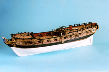

The Main Wale and Upper Rail
The application of the main wale was largely a matter of getting the position right and, just as importantly, getting both sides symmetrical. Each side comprised three 1 x 4mm strips and I chose to paint the top and bottom edges before assembly, again to get a clean line with the hull. I used the decorative etched brass pieces to correctly position the upper rails and the drift rails as advised; it would be disastrous to find later when permanently fitting the decoration, that the width between the rails was too narrow!
The relative positions of the wale and upper rails can be seen in Photo 8, 9 and 10.
The Stern Fascia
The relevant parts of the stern fascia and glazing are shown in Photo 11. I decided that I would glaze the windows as suggested in the manual but having had bad experiences in the past where glazing suddenly decides to ‘ping’ off the back of the frames, I took a further preventative precaution. Having glazed each window as directed, I took a strip of black card that had been cut to match the height of the windows and placed it behind the glazing, sticking it to the back of the fascia between the windows. This was not readily apparent from the outside and even if the glazed pieces should ever become loose, they were totally constrained by the card. Be careful of using cyano on joints involving clear acetate sheet, it can cause fogging and looks pretty awful. Generally speaking, PVA is less hazardous.
All remaining decorative strips were then put in place together with the figurehead and other castings, all benefiting from pre-painting.
Channels, Gun-Ports and Chain-plates
Whether the port lids were to be assembled in the open or closed position, I suggest that they be dealt with before putting the channels in place. The hinges and eyelet were assembled to the lids on the bench. I chose to put mine in the closed position and used the projecting hinge stubs as a guide to depth when gluing them in place. A 0.75mm hole was drilled centrally just above the top edge of each lid and the port lifting tackle rigged.
Each channel was identified for port and starboard location and the eyelets fitted accordingly. The fit of each channel with the side of the hull was checked for total seating and pins placed into the rear edge. The deadeyes and strops may be assembled before or after fitting the channels to the hull. I prefer to do the task on the bench, but that is a personal choice to avoid unnecessarily stressing the channel/hull joint.
The chain-plates are fiddly and laborious although made to conform to the original design and are easier to fit than many I have found in the past. Even so, for those of us with thicker fingers, I found it easiest to put the top two links together, hang them on to the eye at the bottom of the deadeye strop then, use a needle in the hole at the bottom of the lower link to guide them into alignment and mark the hull for drilling.
The top hole of the lower plate is then pinned through the upper links into the hull. A needle is again used to align the bottom plate and mark the hull ready for drilling for the final pin. Again, this is a personal choice of working but I recommend giving it a try if you experience difficulties. At this stage of the proceedings, I would suggest that a check be made to ensure that the swivel gun posts have been drilled. It would become increasingly hazardous to do the drilling once the masts have been stepped and the rigging started.
The completed hull made a very acceptable model in its own right and would be suitable for anyone with a small display area, Photo 12.

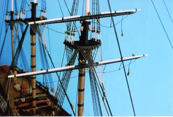

Lower Masts
The manual and drawings gave a fairly clear indication of how the various components should be prepared and put together. One procedure I adopted for making the masts from kit parts was to build the tops, trestletrees and crosstrees first. This provided an accurate dimension for making the square sections at the top of the lower masts and the bottom end of the topmasts.
Eyelets were fitted to the tops as indicated. It was essential to make sure that these were well fitted and secured. The last thing you would want to happen is for one to pull out during the rigging process, because getting it back would be almost impossible. The eyelets, wooldings and masthead bindings are shown in Photo 14.
When assembling the various mast parts, it was essential to observe the correct sequence. Everything was dry fitted first but noting that the tops had to be put in place on the lower masts before adding the simulated iron straps to the lower masthead.
Topmasts
One minor problem that had to be overcome was the square sectioned portion at the bottom of each topmast. I found that the reduced section of 5mm square on the foremast needed to be taken down to 4mm and extended to the bottom, then the lower 10.9mm built up with 1.0 x 4mm scrap to provide the 6mm square section required. A similar rectification is required for the main and mizzen topmasts.
On the latter, the mast cap should be slid down the topmast before fixing the truck at the top.
Topgallant Masts
The construction of the topgallant masts was done in a similar manner to the topmasts. However, it must be remembered to slip the topmast cap into position before gluing the truck in place at the top of the pole.
Mast Assembly
Sequence was all-important and a dry run helpful to ensure that I didn’t finish up with something I couldn’t get on!
Blocks were identified and attached where indicated. The holes in the blocks were also checked out, first to make sure they were there and secondly to ensure that they were clear. The one that the thread will not go through is always the one in the most inaccessible position!
The deadeye strops either side of the tops were fitted with deadeyes and placed in position. It may seem a bit ‘belt and braces’ bearing in mind the self-locking design of the strops, but it is worth applying a small dab of adhesive to the slot in the top. Strops are features that you definitely don’t want to come loose during the rigging process.
The Yards
These were all straightforward to make following the dimensions provided on the drawings. Small flats were filed on the spars to provide a good seat for the various cleats made from 1mm square or 1 x 2mm strip. These were stuck on to the yards well oversize and cut to length and tapered after the glue had thoroughly dried.
I was disappointed in the provision of copper strip for making the stuns’l boom irons and substituted black cartridge paper which made a better and neater job all round. 1mm diameter wire was used for the ‘iron’ bracket at the end of the yard. The iron fitted into holes in the yard and the boom. Once the correct 45 degree attitude was established, I drilled through both yard and spar toward the butt end of the boom and passed a pin through to secure.
Blocks and footropes were added as required and the finished yards put to one side.
Note that all brace pendants were tied to aft on the yards except those for the mizzen crossjack yard, which were tied forward. A double check was made to identify those blocks that needed an eye for attaching tackle falls.
Stepping the Masts
This may be done as indicated in the manual, that is after securing the yards to the masts or, as I chose to do, before putting the yards in place. This is a personal choice, having advantages and disadvantages. I prefer not to have the yards in the way when tying on ratlines later in the rigging process, but then suffer the possible fiddling about with trusses and parrals when I finally come to put the yards on. You pays your money and you takes your choice, so to speak.
The bowsprit was stepped first paying attention to alignment with the centre of the hull and then getting the cap perpendicular with the stem. The gammoning was then put in place.
Note that the gammoning was not just a matter of wrapping a length of rope ‘twixt bowsprit and stem several times. It was passed from the aftermost position on top of the bowsprit to the most forward position in the slot through the stem. This induced a twisted effect prior to tying on the frapping turns. Once the gammoning is correctly applied the effect is hardly noticeable except, that is, to the eye of a discerning judge. Medals and certificates at exhibitions can be won or lost by such detail.
Having checked that the three masts had been completely ‘blocked’ and ‘deadeyed,’ they were dropped into position, not forgetting to slip the mast feet in place first, Photo 15.

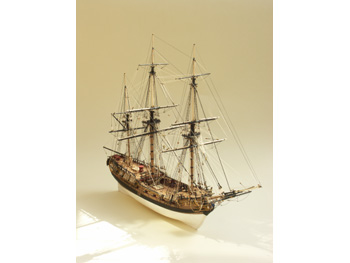

Conclusions
This kit makes up into an attractive, highly detailed and decorative model, in fact a real gem. It is not really one for the beginner and certainly some knowledge of rigging, or reference to the subject, would be to advantage. Given that, the result can be very impressive and I can see it turning up in competitions and exhibitions for a long time to come.
I thoroughly enjoyed building this kit and I have to say that it offered a standard that bodes well for the forthcoming kit for H.M.S. Vanguard that is expected soon.
The materials were of good quality and all fittings and castings crisp and clean. With a fairly small workbench, I found the smaller format drawings an advantage. The resulting half working scale was not found to be a problem since all finer detailed stuff was drawn full size.
