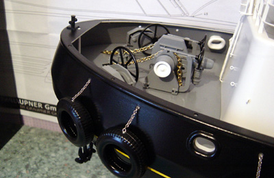

Pic 1: The mast constructed and primed. Pic 2: Bow detail showing anchor winch. Pic 3: 003 Aft deck detail showing tow winch. Pic 4: Mast and assorted fittings. Pic 5: Underside of superstructure showing the monitor servo.

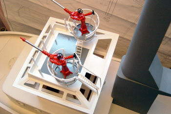

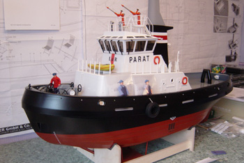

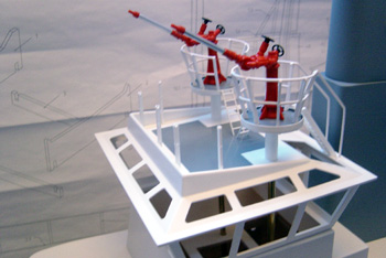

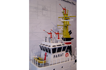

Pic 6: The impressive superstructure and wheelhouse. Pic 7: Servo tray and servos for the VSP drives. Pic 8: VSP Drives complete with motors. Pic 9: 12v water pump for the three monitors.

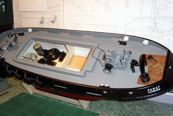

Pic 10: Photo of the finished hull and VSP drives. Pic 11: The VSP apertures marked and drilled ready for removal and accurate filing. Pic 12: Kit box and contents. Pic 13: Tail fin, resined and held in place. Pic 14: Resin applied with a syringe for neatness. Pic 15: Internal timber frame fits snugly into the hull with little trimming.

The hull / deck / bulwark has pre-cut holes for the hawse ports and scupper openings, and the lower superstructure and wheelhouse are all accurately pre-formed and come together very well to give the model a real ‘tug feel’ very early in the build. The guard for the VSP drives, constructed from ABS, aluminium and brass, is attached to the hull using resin. Stablit Express was used giving a very strong bond but it is down to personal choice which brand to use.
The superstructure fits over a generous coaming on the deck with very little ‘fettling’ required to obtain a super fit. The wheelhouse roof and monitor platforms were constructed prior to attaching to the lower wheelhouse which eases the building process. The funnel array which consists of wood, ABS and brass is worthy of mention as a little more patience than usual is needed to put it together in an accurate fashion. Also the monitor platforms need to be constructed with care. There are two on the wheelhouse and one atop the mast which has the added feature of being able to extend – quite neat! This is achieved by the fitting of a sail winch at the base of the funnel inside the superstructure connected to a pulley system within the mast and funnel, giving an impressive elevation.

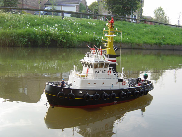

Pic 25: Upper wheelhouse and monitors. Pic 26: Starting to look like a tug. Pic 27: Hull ready for painting. Pic 28: Painting the hull using aerosols. Pic 29: Superstructure and wheelhouse assembly. Pic 30: Anchor winch kit assembled using polystyrene glue.
Fittings and painting
The fittings supplied by Graupner as ever are superb quality, especially the various winch kits which need very little preparation and fit together beautifully. Painting was achieved with commercially available car aerosols which I find give a very good finish, although slightly more expensive than brush-on paint but in my opinion worth the extra. It is down to the individual modeller how he or she finishes their model boat – some prefer a weathered look to the finished vessel, others a more ‘showroom finish’ – all down to the individual in my opinion.
Without the adding of further auxiliary functions the Parat is a very detailed model, but I chose to add a working radar which I like on all my models if possible, and some interior detail in the wheelhouse in the form of an instrument panel, lighting and 1:25 scale figures for the ‘skipper’.
Image 1
Pic 31, Pic 32, Pic 33, Pic 34, Pic 35, Pic 36, Pic 37, Pic 38, Pic 39,
Pic 31: Parat looking good. Pic 32: Parat with scale skipper on deck. Pic 33: Buoy set (not included in the kit) used to ‘populate’ the deck area. Pic 34: Sail winch and servo assembly for extending fire monitor. Pic 35: Extending monitor assembly ready for insertion in the funnel and mast. Pic 36: Wheelhouse console detail (not included in the kit). Pic 37: Wheelhouse console complete (not included in the kit). Pic 38: Companionway being assembled. A really good fit. Pic 39: The fully assembl ed VSP drives complete with motor.
