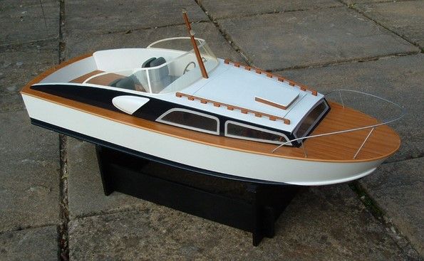

Fairey Swordsman

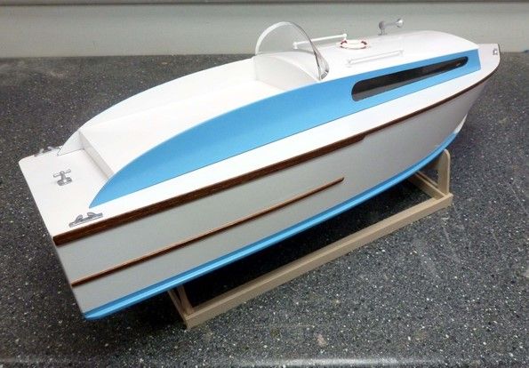

Twinkler design by Vic Smeed built by Dave Milbourn

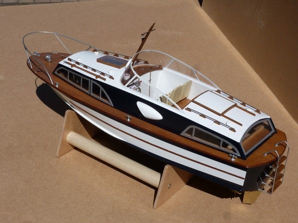

Fairey Huntsman 31
