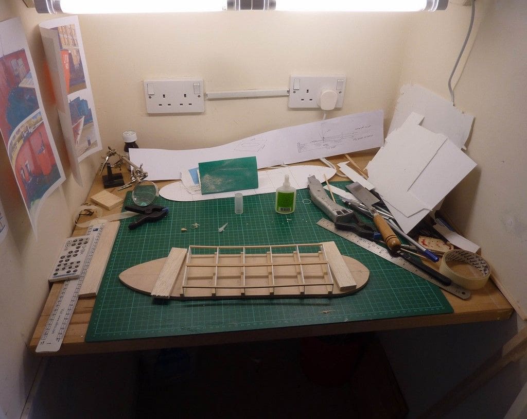

Having decided upon a subject, some drawings are needed. Hull Maritime Museum had the original drawings, but could not copy them and Hull is also a long way from my home. Fortunately, Jan van der Elsen had a general arrangement drawing which was too large to be copied, but was photographed and a tracing of the deck plan and other sections was made. There were no full depth hull cross-sections, so after some deliberation a waterline model seemed to be a good way forward. Domestic workspace is limited to the cupboard on the house upstairs landing, Photo 1, so a 1:72 scale model with a length of 550mm seemed like a good idea. Photocopier rescaling of the tracings produced waterline and deck drawings and a mid-line section.

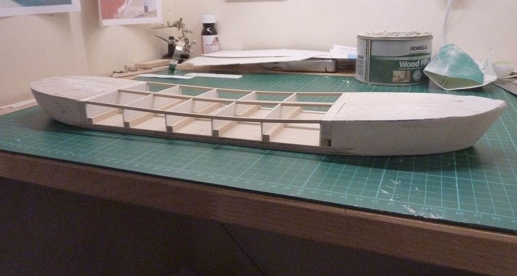

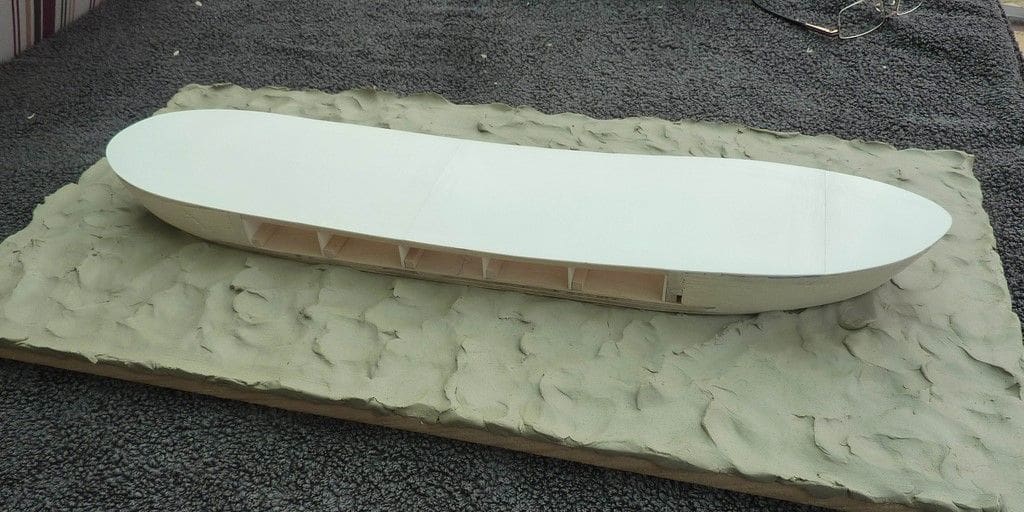

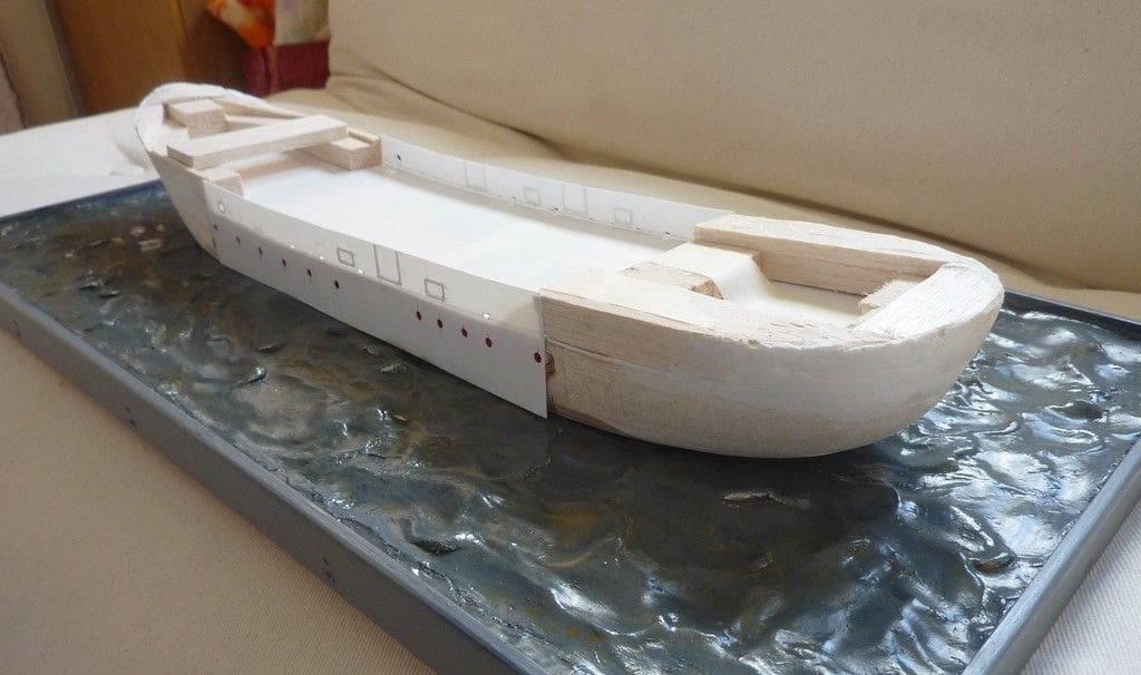

The hull framework up to main deck level was made from balsawood as in Photo 2. On the top of this was fixed the main deck , this being from sheet styrene as in Photo 3. In this last picture you can also see the start of the North Sea base on which it will eventually be properly displayed.

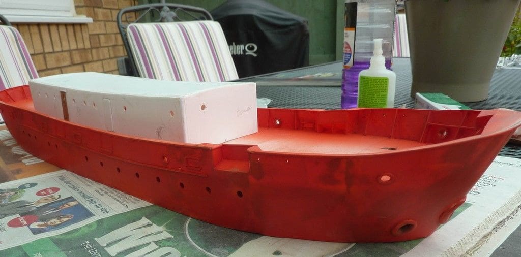

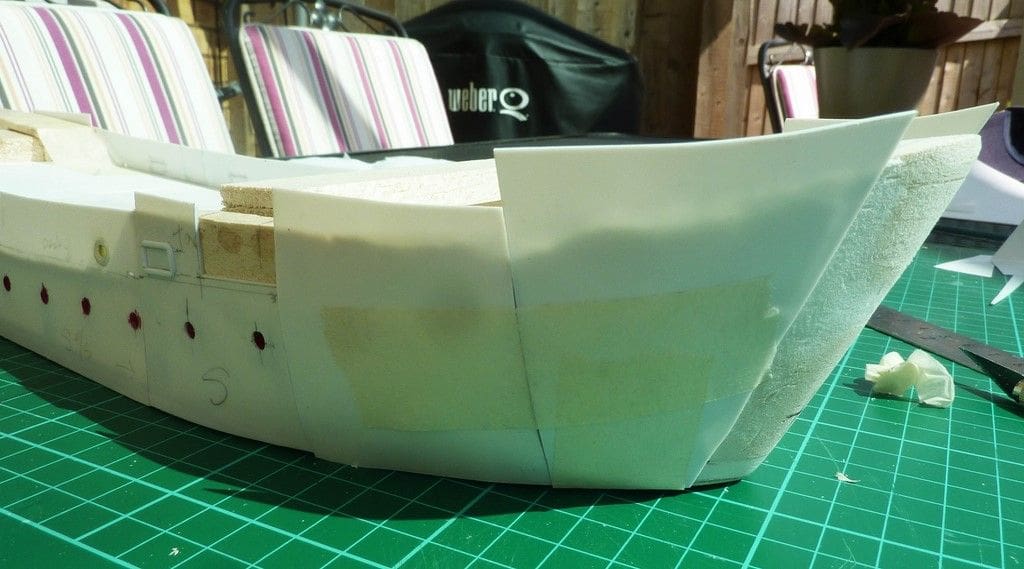

Temporary balsawood formers were fixed with tape, fore and aft above the main deck to create the shape of those bulwarks, but these would be removed after cladding with styrene sheet, Photo 4. I had no idea if this would work, but that’s the joy of scratch building isn’t it? 0.5mm styrene sheet was used for the hull shell plating, superglued to the lower sub-structure, after first drilling holes for the portholes, Photo 5. As you can see, the bow and stern sections used shaped pieces of sheet styrene cut to follow the hull lines and with insets to allow the curves to be formed. The temporary balsawood pieces were then carefully removed and the result was not perfect, but it had a battered look to the hull, so it was at this stage that I decided to make the model ‘weathered’ a bit, as if moored in the North Sea.
Cutting and fitting the bulwark support pieces was fiddly, but once capped with a rail, it looks okay. They are not 100% in their correct positions, but without a drawing it was the best that could be done. The hull was sprayed with an acrylic red paint , Photo 6, and later had its black areas picked out by hand.

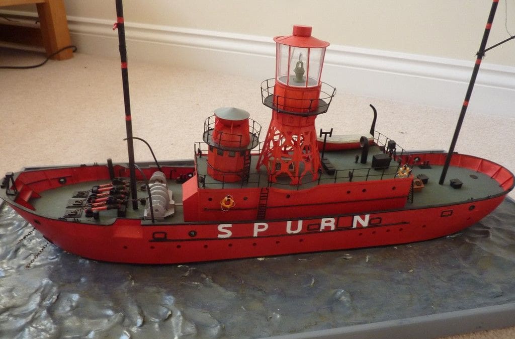

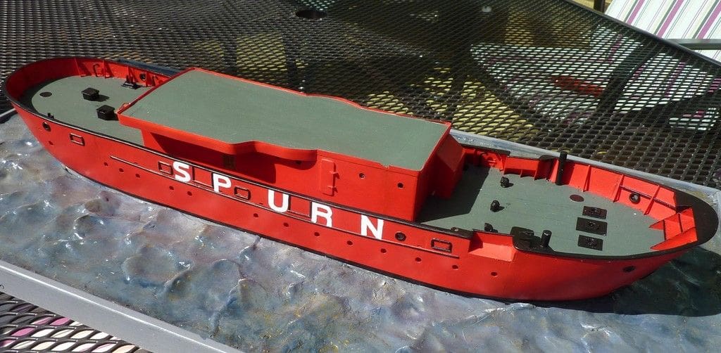

The deckhouse unit was constructed of styrene sheet, its profiles shaped to follow the deck lines and drilling the portholes in it produced a tiny raised edge which mimicked the welds on the original vessel. This main cabin was loose fitted and some hatches etc. made, but when these were glued to the main deck it was discovered that the deckhouse unit was about 30mm too long, so a ‘cut and shut’ operation was performed on it and the resulting joint filled. Styrene rod handrails and associated brackets were made, fitted and painted black. Some of the access doors are of 1mm mahogany, that re set in to the deckhouse sides, with their panelling drawn with a fine black pen. The porthole glazing is clear acrylic glued to their insides, but painted dark grey. The deck was brush painted a blue/green colour and suddenly the whole thing started to look like a lightship as in Photo 7, here on its painted display base.

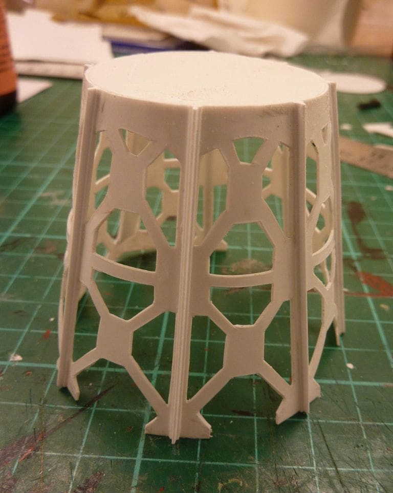

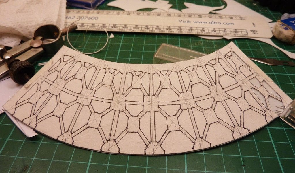

The supporting tower is a truncated cone of latticework. This was carefully drawn on paper that was stuck to 0.5mm styrene, Photo 8, and each lattice piece cut out. A lot of work here, but it is a major feature, so well worth the effort, Photo 9. You can see in this last picture some reinforcing T-pieces of styrene fixed vertically between each lattice part. The railings on its circular walkways were made from brass wire, glued at the joints with thick superglue, which produced reasonably realistic stanchion balls.

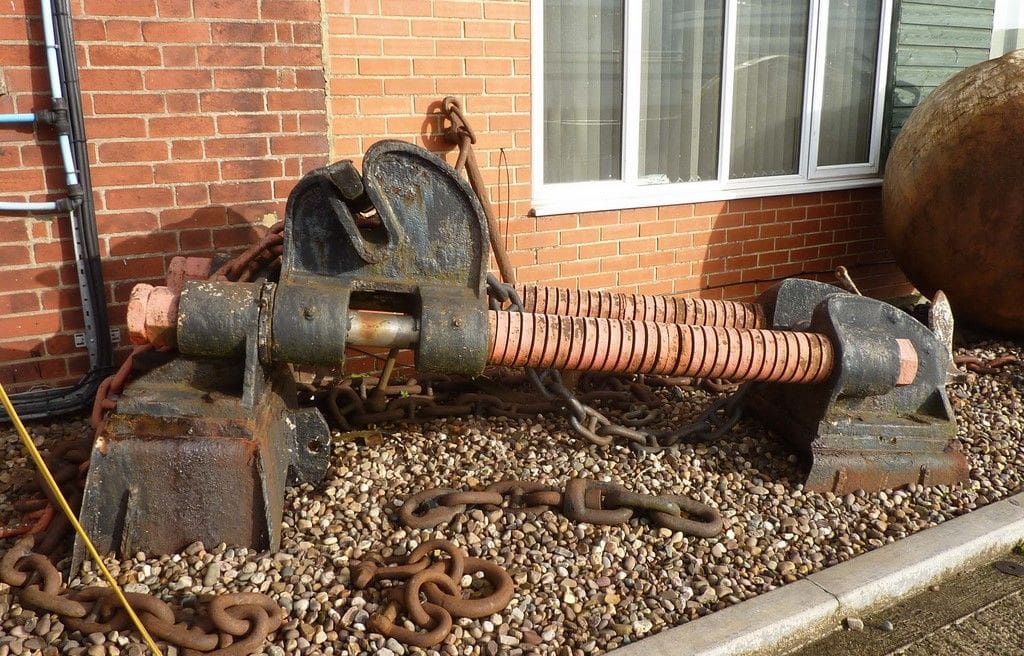

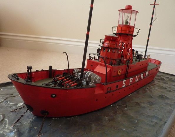

The mooring clamps and their chains are missing from Sula as now at Gloucester. One such device, which had been removed during the refit is at Sharpness Dry Dock, Photo 10, so a quick visit to measure and photograph it meant that they could be easily modelled,. The anchor windlass is, I am sorry to say, built using modeller’s licence from photos and the somewhat sketchy plan. The two stepped steel masts are of shaped dowel, with toothpicks as their spars. The various small deck fixtures are from styrene section and sheet and the ventilator cowls were also moulded from a paper craft mould and Photo 11 is of the complete model on its painted display base.
