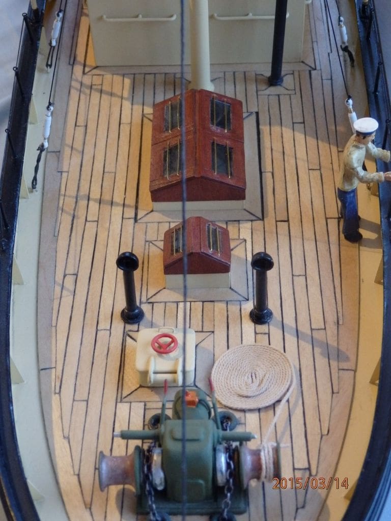

The foredeck of Vigia is a little sparse with just a few fittings, so I decided that with so much deck on view, the planking had to be correctly laid. Again a search of the web brought up articles and drawings of correct practice, which I followed, even down to joggling the joints between the planks and the margin board. It took a long time, but I was pleased with the result.

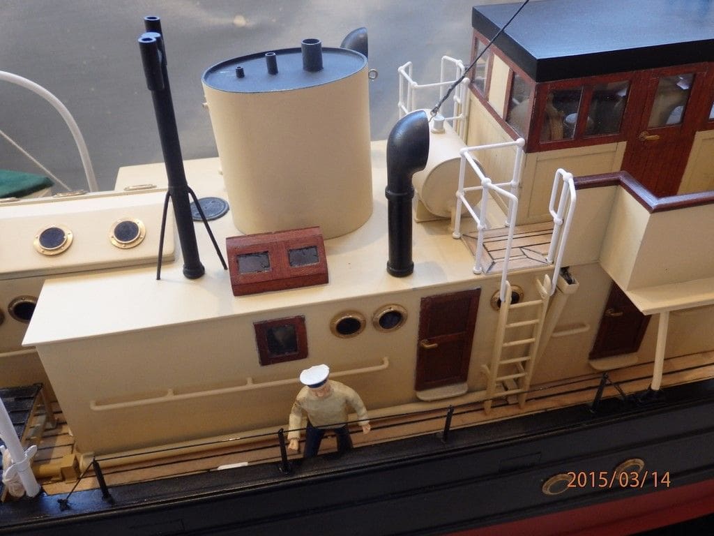

The original Vigia was covered with numerous brass ports and these and many other superb, and reasonably priced, fittings were ordered from Keith Jewel at Modelling Timbers. He had literally just moved from three miles up the road from me to the Isle of Man, but an email and online payment saw the fittings arrive within a couple of days.

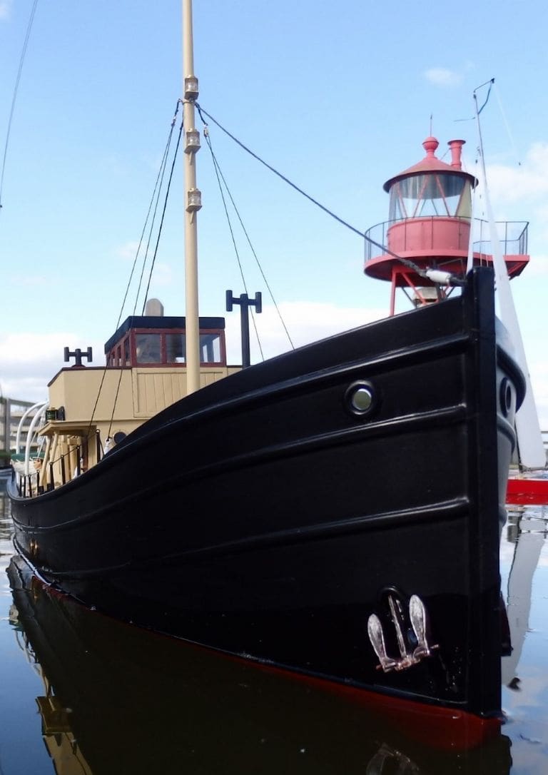

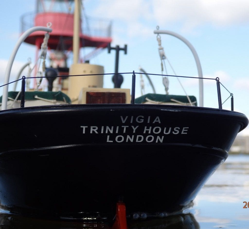

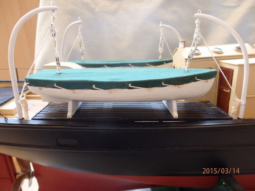

Another issue to be settled was how the two boats were stored onboard, as one of the small photos suggested they did not sit on the deck, but were level with the top of the bulwarks. Living near Hull I was aware of the preserved lightship in the marina. Although this was built for the Humber Conservancy Board I assumed the arrangement would be similar. Having been able to get up close to the full-size boats, I was happy that the storage was practically the same, with the davits being made from parallel steel tubes, just like Vigia. Heat bent brass tube, with more brass rigging blocks from Modelling Timbers ensured the boats looked right. When it came to painting I followed the details in the article, so although additional information was at a premium, she should be in the correct Trinity House corporate scheme.

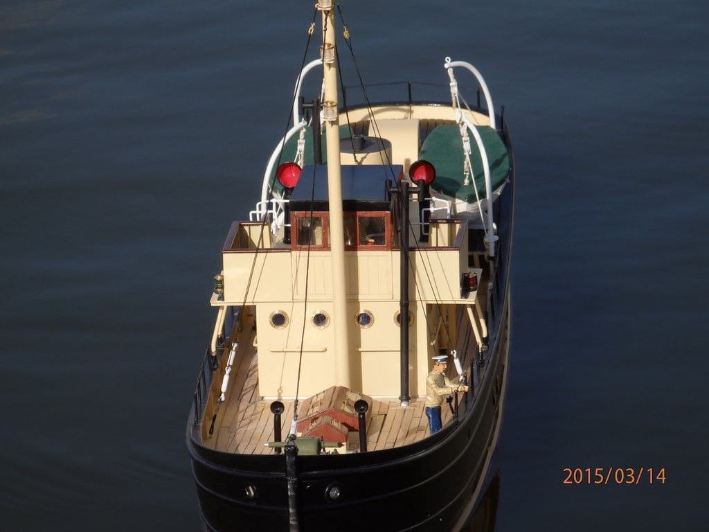

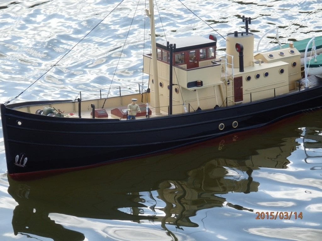

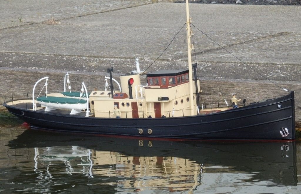

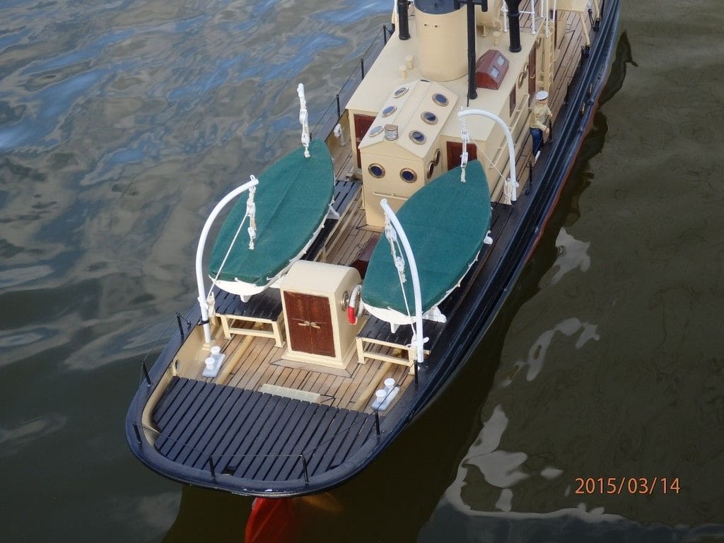

With a not particularly powerful motor and a large propeller, she sails at a realistic scale speed and is very stable, so much so that recently she was hit broadside by a model yacht running before a good wind and barely shuddered.

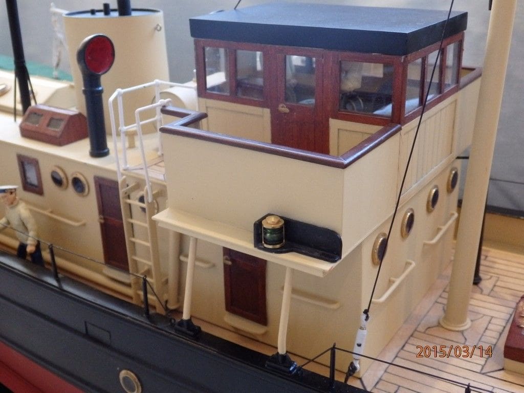

I now have a model that is somewhat different to the other Trinity House models seen at shows and I can honestly say I have not seen another version of Vigia on my travels. I hope the pictures convey the main features of the model and as I wrote earlier, it all came from that fibreglass hull bought for just £20.
