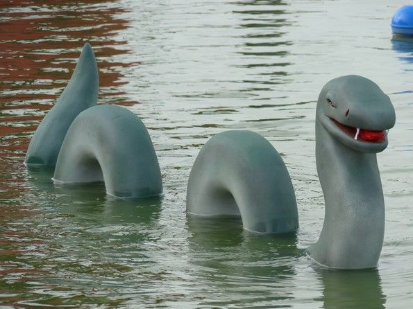

Preparing Nessie to sail is quite straightforward. The main 7.2v battery is fitted into the power unit and connected, the two speed controllers are switched on and the operation of the system checked from the transmitter. The lid of the power unit is then fitted and the four corner screws tightened to pull the lid down on to the O-ring seal. The power unit is then inserted into Nessie’s base and the aerial wire is fed up the tube in Nessie’s torso. If required the 9v battery is also fitted into the base of the torso to light up the eyes. The torso and lid is then attached to the base unit using two screws and each of the sections fixed together with the curtain wire hooks. It takes two people to put Nessie into the pond in one piece, but if necessary this can be done by one person by sequentially connecting each section in the water.
Nessie sails remarkably realistically, Photo 15, and has attracted a lot of attention when sailing at club events or at our local water sports lake. She is very manoeuverable and can turn tightly, but is not very quick and can’t really reverse. The use of a mixer unit and differential propeller thrust for steering works well in this type of model. It is difficult to synchronise the two motors over the whole throttle range, so there is some lead or lag between the motors when accelerating and decelerating. To some degree this effect can be minimised with rudder trim, or by setting the neutral for the two speed controllers to slightly different signal positions. However the slightly wandering behaviour is not out of character and adds to the appeal of the model.
