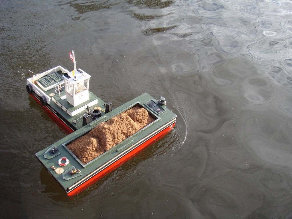

I’m not claiming to know a whole lot about tugs and in truth I don’t know the strict difference between a Pusher Tug and a Springer Tug, but I do enjoy scratch building models and this has to be about the easiest of the type to build. This variety of tug appears to be very popular and having built and sailed two of them, I can really see their attraction as it’s a cheap robust model that can shove a barge or football around the pond with no fear of damage to itself. These model tugs are always fun to sail on their own, or you can challenge your club-mates to a pushing or pulling competition for a bit of fun.

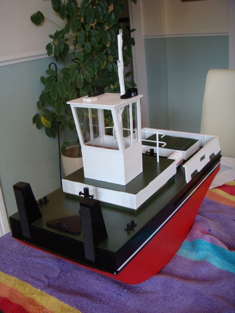

There are plastic vac-formed and wooden kits available for this type of model, but I reckon you can build one for half the price of a kit and achieve twice the quality if you are prepared to source your own materials and build from a simple plan. The level of detail and total cost is down to you, but the real attraction is that it is a cheap and quick-to-build robust model boat that you won’t mind bashing into things, as after all it is really just a glorified wooden box.

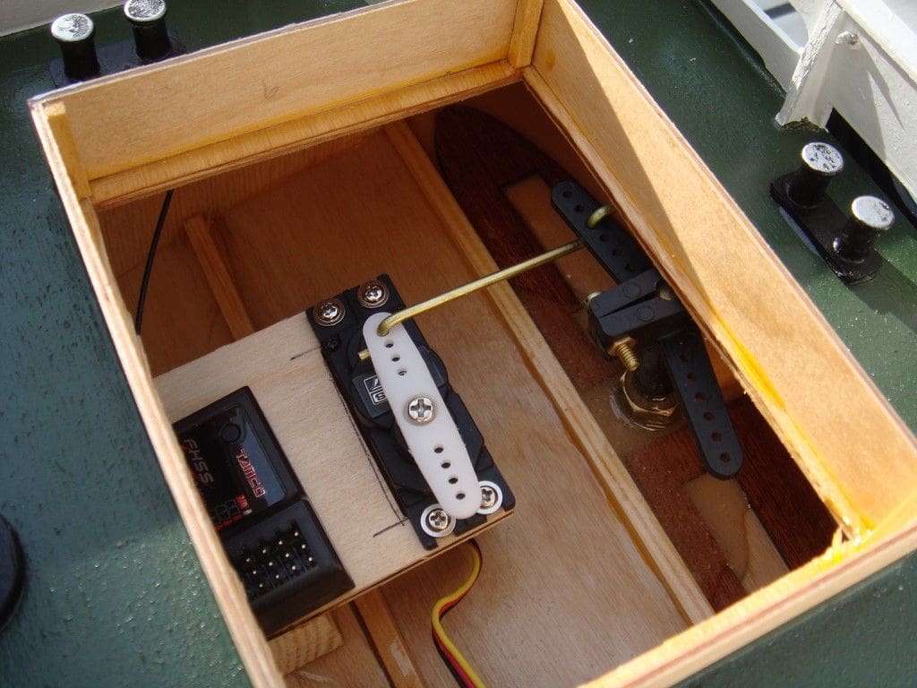

Whether by luck or judgement, this homegrown plan produced a hull that performs very well indeed, as long as one get’s as much angular throw as possible on the rudder. It will then practically turn on the spot if you get that just right. The plan is reproduced, gratis, in this magazine and you can either have it enlarged or just take the written measurements from the plan and transfer them to your pieces of wood.

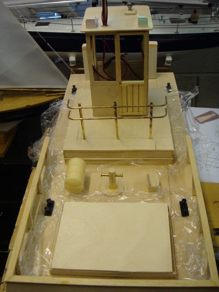

There are plenty of options for these, but I used 4mm Birch plywood for the deck and hull sides and virtually everything else was 2mm ply or balsawood. 2mm plywood easily bends to the shape of the hull bottom to create the distinctive shape and standard PVA wood glue is easy enough to use, being a perfectly adequate adhesive for the job in hand.

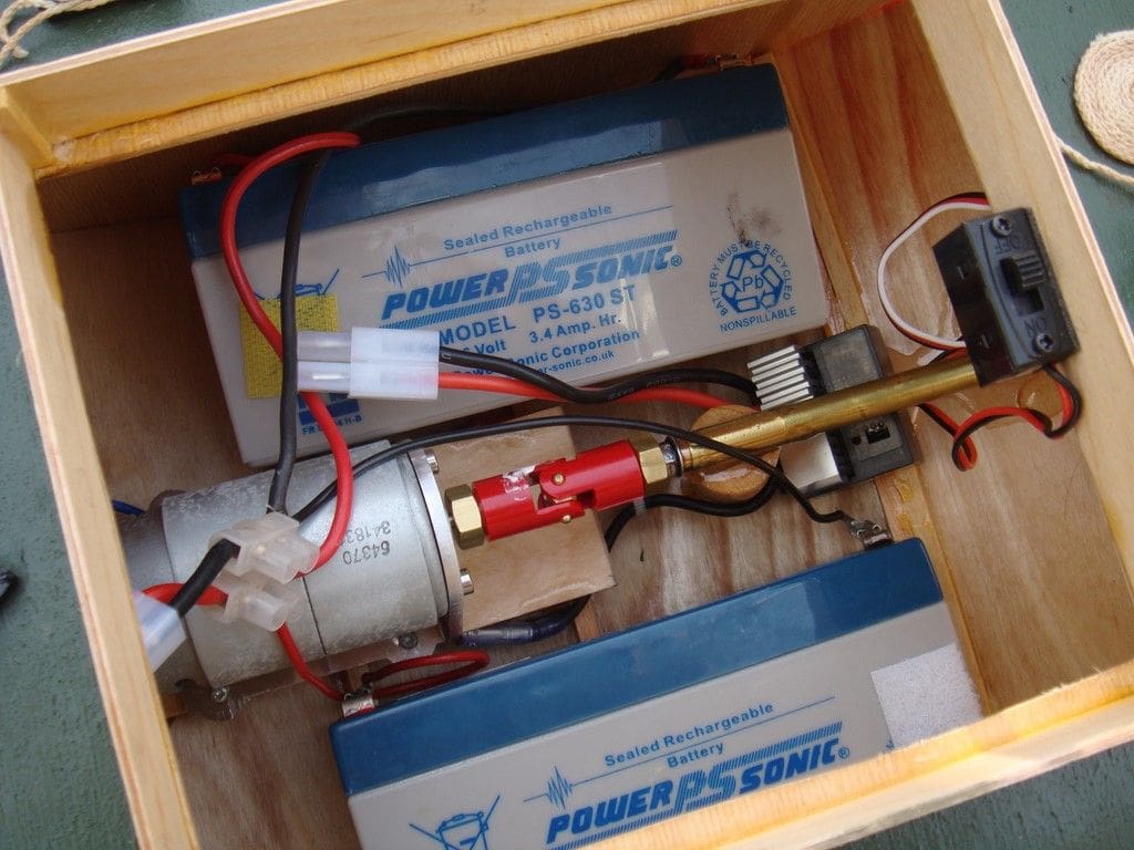

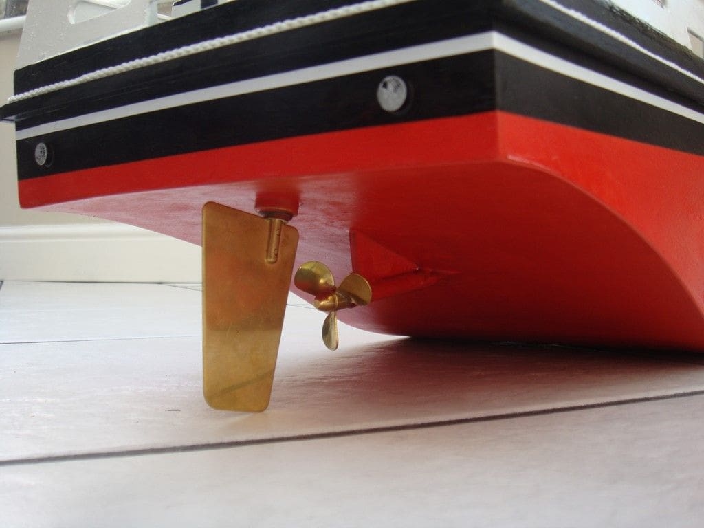

A Johnson 600 brushed motor and 5 inch propshaft tube with a 6.5 inch shaft driving a 35mm brass propeller, together with a standard pre-fabricated large brass rudder proved ideal for the running gear.
Battery and electronic speed controller (esc) choices are of course endless, but a cheap 1:10 scale buggy esc from that well known internet auction website and two sealed lead acid house intruder alarm batteries provide the power source. These batteries sit nicely either side of the propshaft adding to the ballast. However, some additional pieces of lead-flashing were still needed for this, as the hull is one big box that is also quite difficult to sink, as it so happens.
