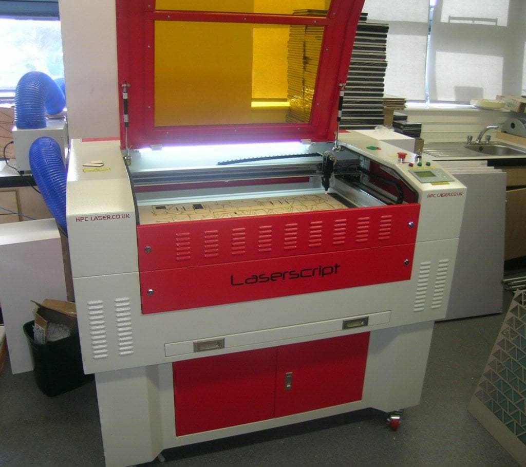

The laser cutter I have used, has a bed capable of holding sheet material up to 900mm (36ins) by 600mm (24ins) in size. I favour 3mm and 2mm thick birch plywood for model making, but a range of recommended materials can be cut, up to about 25mm thickness, Photo 5.
A computer, connected to the laser cutter, displays the drawing to be cut and the various controls which govern power and speed settings, dependent on the assigned line colour. Once these commands have been entered, they can be saved together with the drawing file, so that the operation can be easily repeated. Photo 6.
Laser cutters work very much in the same fashion as inkjet printers, with computer guided stepper motors providing the head movement. However, whereas the inkjet head only has a lateral left to right movement, the laser cutter has a second track allowing the additional simultaneous movement of the cutting head in a forwards and backwards direction. So, the laser is capable of traversing the entire cutting surface, creating simple or very complex shapes.
The laser itself is situated in a light tight box at the back of the machine. The light beam reflects off a 45 degree mirror at the end of this box emerging through a narrow opening to reflect in turn off another 45 degree mirror which directs the beam on to the last mirror on the moving head, set at a 45 degree angle to the horizontal. This reflects the beam down a short tube through a focusing lens on to the cutting surface. All this means that the cutting head itself is very light in weight and can zip around quite nippily depending on the depth and nature the of material to be cut.
A tinted glass cover prevents any eye damage from the glare of the cutting flame as it does its business. The laser light itself is invisible, so the whole lot is contained in a weighty housing with micro-switches to cut off the laser should you decide to lift the lid for a closer look, Photo 7.
