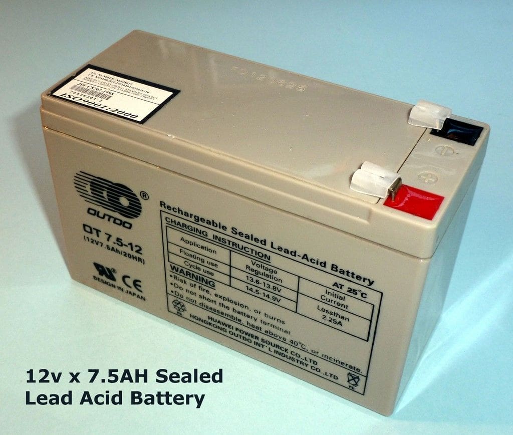

SLA batteries are heavy, the ‘L’ stands for lead after all, and cannot generate very high currents, so are used where slower motors are appropriate, and where they can contribute usefully to the total weight of ballast required to get the model down to its scale waterline, e.g. in tugs. The usual sizes for SLA batteries are 6v and 12v, both in many different capacities, although there are also some 2v cells around these days, Photo 1.

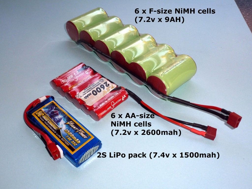

Nickel Metal-Hydride (NiMH) batteries are generally made up in packs of joined-up cells, each cell having a nominal voltage of 1.2 volts and the cells coming in different case sizes. The smaller case sizes have the smallest capacity; typically around 850mAH for an AAA pack, while the largest cells, ‘F’ size, go up to 10000 mAH (or 10AH). Packs of these cells are much lighter than their equivalent capacity SLA types and thus suitable for faster models where low weight is more important. NiMH cells can supply a lot more current than SLA batteries and can also be fast-charged at the lakeside from a portable charger. The term ‘nominal voltage’ is used to indicate the voltage at which the pack will discharge for the majority of its discharge cycle. When fully charged, a NiMH cell can have as much as 1.55 volts across the poles. This will quickly settle down to about 1.2v and stay at that level until it is almost fully discharged. At that time the voltage starts to drop quickly and should not be allowed to go below 1v per cell or damage will occur.
Finally, Lithium Polymer (LiPo) batteries are the newest kids on the block and are lighter and more powerful even than NiMH cells. Their nominal voltage is 3.7v per cell, BUT they do have to be carefully handled and monitored. Careless handling or overcharging/discharging can in the extreme case, cause them to catch fire and even destroy your model. For this reason it’s always advisable to use a speed controller which will monitor the battery voltage and cut off the power to the motor before it reaches a critically low value, e.g. the Mtroniks Tio range. You can also obtain a stand-alone device to do this, or a simple monitor which just sounds an alarm when the value is reached. That said, LiPo batteries are in use all over the world and instances of such accidents are becoming rare. As regards charging, if you purchase the correct type of balancing charger and follow the instructions, then you will have no problems. LiPo packs come in multiples of 3.7v and are quoted in the form ‘XS’ where X is the number of cells. Thus a ‘3S’ pack is 3 x 3.7 = 11.1 volts. The capacity is quoted in the usual way i.e. mAH, and the maximum current which can safely be delivered is given in the form ‘YC’, where Y is the value of the capacity (confusingly in Amp-Hours). As an example, a 1700 mAH LiPo pack has a corresponding ‘C’ value of 1.7 and so a pack rated at 20C can supply a maximum of 20 x 1.7 Amps = 34 Amps, Photo 2.

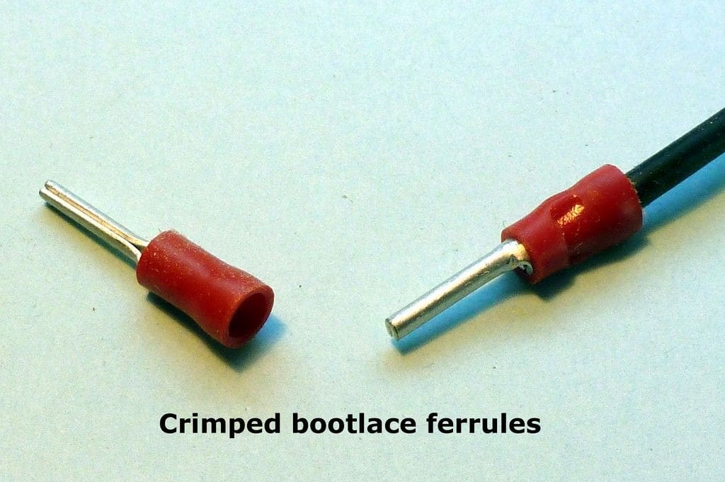

If your electronic units have screw terminals then you will need to prepare the ends of the cable to suit. NEVER just twist the strands of cable together and stuff them into the terminal. You will inevitably discover one day that there is a loose strand (or ‘whisker’) of wire which finds its way across to a neighbouring terminal, causes a short-circuit and melts or blows up something. At the very least you should strip, twist and tin the strands with solder, then crop them to length, Photo 6. Ideally plain cable ends should be terminated with a crimped bootlace ferrule; the blue and red colour-coded ones are the most useful sizes for models, Photo 7.

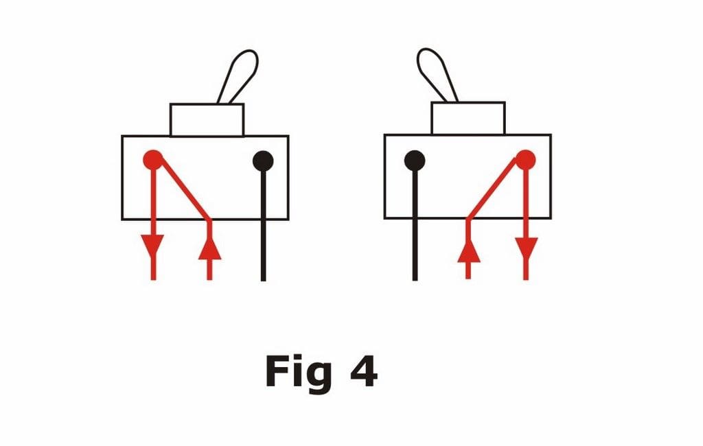

These are devices which are operated either manually or via remote control and are used to turn electrical circuits on and off. In its simplest form, a switch has a lever which moves a conducting piece of metal into a position where it makes contact with another fixed conductor, thus bridging the two and allowing an electrical current to flow between them. Each of these is called a terminal (or pole) and is connected to the wires within the circuit, thus controlling the current in that circuit, Figure 3.
Manual switches are used in model boats to turn on and off the power from the batteries to the various loads. Usually these switches have an extra terminal, so that the moving contact is touching one or the other of two fixed terminals at any time. This can be used to divert the flow of current from one circuit into another and is called a changeover (or double-throw) switch, Figure 4. A simple switch which only has one set of terminals is called a single-pole switch, while a switch which can operate two independent circuits with just one toggle is called a double-pole switch, Figure 5. You will find switches referred to by their abbreviations SPDT and DPDT, which are respectively Single Pole Double Throw and Double Pole Double Throw. The centre contact of a set of three is always the common contact.
The choice of switch depends upon what you want it to do and also what current it will be conducting as switches are rated for voltage and current. I recommend a 16A toggle switch for motor circuits and either a 2A or 5A toggle switch for lower current circuits, Photo 8. Note that these ratings are for the ‘switching’ current at a mains voltage, i.e. the current which will flow instantly as soon as the switch is thrown. In practice they are capable of conducting a higher current once they are ‘on’. In nearly all cases in a model boat we are dealing with much lower voltages and there will be very little current flowing initially until you actually move a transmitter stick and energise something like a motor. I don’t personally use slide switches, but they are still fitted by radio manufacturers in the wiring harnesses which they supply to connect receivers to battery packs, Photo 9.
Switches being what they are, the toggle or slide needs to be accessible from outside the model. This means either leaving it standing proud but in a less visible place (e.g. inside an open cockpit); hiding it under a removable hatch, or modifying a deck feature so that it moves and operates the switch. For submarines none of these options are practical, so you might want to fit a magnetic switch. This is based on a magnetic reed switch and is mounted on the inside of the model, right up against the outer skin. To operate it, you simply ‘wipe’ a permanent magnet along the outside of the skin from front to back of the switch area. This energises the thin reed switch, trips a latching relay and makes the circuit. Alexander Engel KG sell two different types; one for models with a BEC (Battery Eliminator Circuit) speed controller and one for those without, each in either 6v or 12v versions They are however, as the Editor says, not exactly cheap, Photo 10.

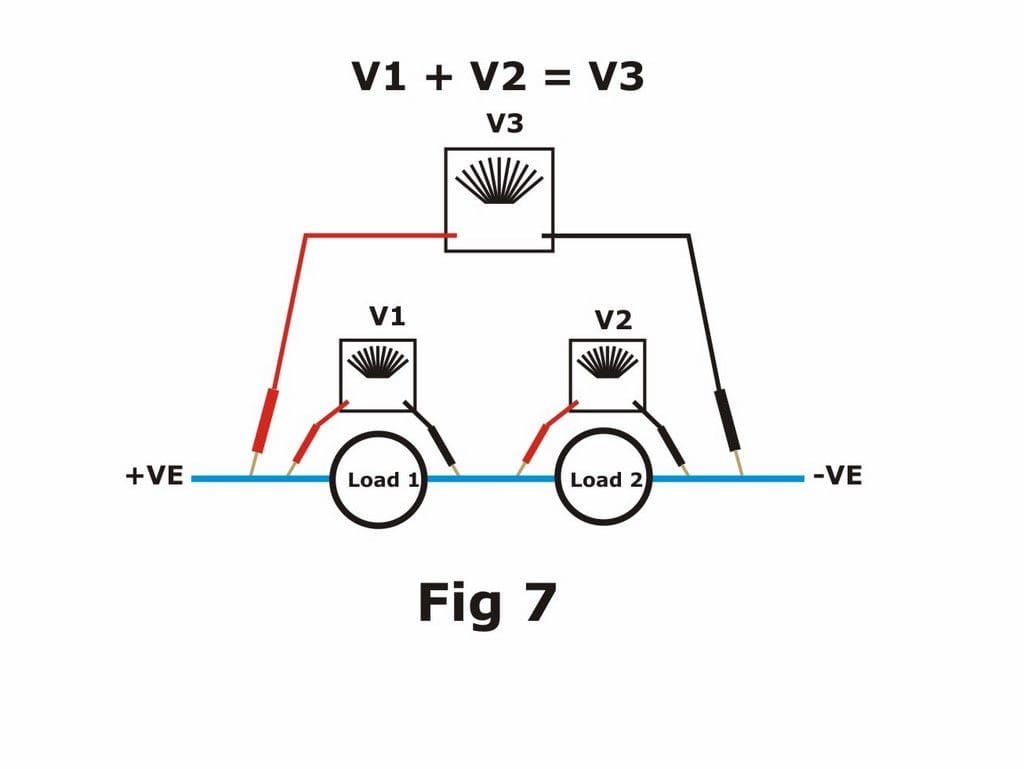

Series versus Parallel Connection and Loads

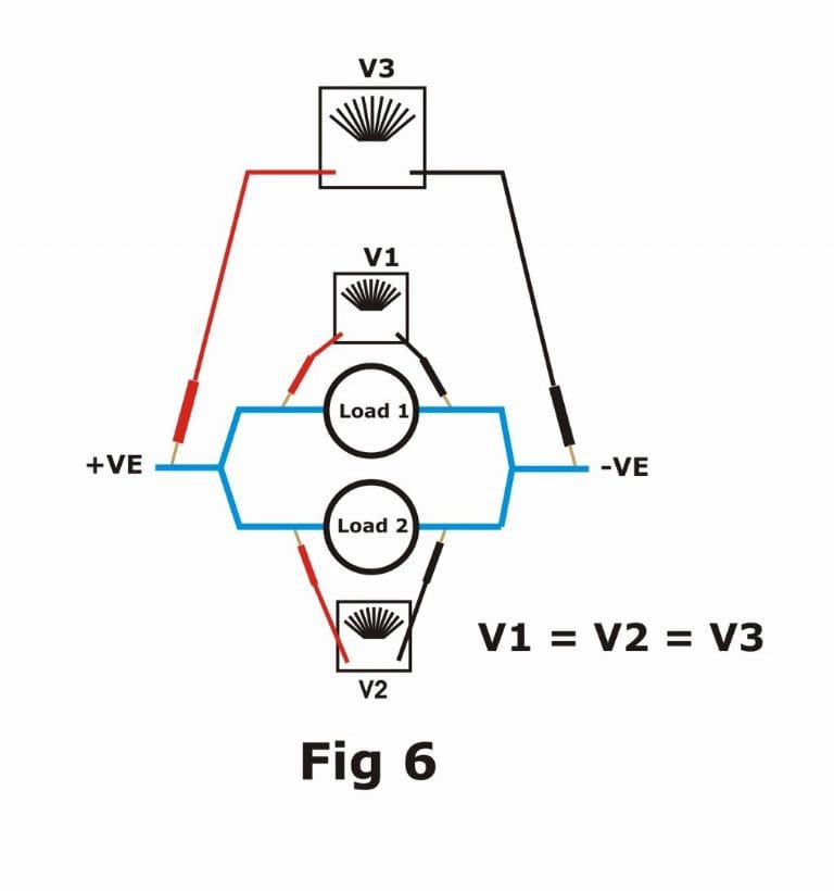

At this point I will have to explain those confusing terms parallel and series. There are two very simple rules here.
Loads connected ‘in parallel’ go alongside each other in side-by-side (parallel) cables which are then connected at each end, like two sidings along a single railway track. The voltage across each load will equal the total voltage across the circuit, Figure 6.
Loads connected ‘in series’ are connected one after the other along the same cable i.e. like a series of programmes on TV. The voltages across each load will add up to the total voltage across the circuit, Figure 7.
As I said earlier, a load can be anything which consumes electrical energy but typically will be a motor of some sort, or lights or a sound effect unit. You can fit such loads in series into a circuit where their total operating voltage equals that of the whole circuit. As an example; two 3 volt bulbs wired in series will require a total of 6 volts across the pair to operate them. This is a good way to combine bulbs of a different voltage, e.g. two 3 volt bulbs and a 6 volt bulb all in series adds up nicely to 12 volts. If you wire two 3v bulbs in parallel however, they will require only a 3v battery across the circuit as each will receive 3 volts. You can combine loads in circuits which involve both series and parallel wiring if you like. Please see the illustration of a typical lighting circuit in a modern tug model, Figure 8. Here the supply voltage is 12v and it’s supplying both a series circuit comprising of 2 x 3v bulbs and a parallel circuit of 2 x 6v bulbs. Note that if one of the bulbs in a series circuit fails then the whole circuit becomes dead, whereas a failed bulb in a parallel circuit has no effect on the other bulbs. You’ve quite likely already discovered this when hanging Christmas tree lights?
The terms ‘series’ and ‘parallel’ are also applied to connecting batteries, but beware! While you can connect two batteries with different voltages and capacities in series, you must NEVER connect two batteries of a different voltage in parallel or one will discharge into the other, with potentially serious damage to both batteries and possibly the model. As before, the total voltage of a series pair will be the total of the two battery voltages, Figure 9, while the voltage of a parallel pair will be the same as the two individual batteries, Figure 10. The capacity of a parallel pair will be twice that of the individual batteries. In practice you should always make sure that the two batteries in the pair are the same type (e.g. SLA or NiMH) and the same capacity (e.g. 7AH), irrespective of whether you are wiring them in series or parallel.

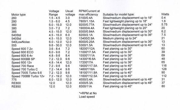

Electrically-powered model boats exclusively use Direct Current (DC) motors, although there are thousands of different types and sizes. Essentially they all involve using the power supply to energise a coil or coils of wire inside the motor. These coils form the armature of the motor. The electrical energy creates a magnetic field in the coils which in turn rotates the armature inside the motor. The armature shaft extends beyond the end bearings in the motor case and the propeller shaft is connected to it via a coupling. There are very many websites which show their construction and operation, with both coloured diagrams and animated graphics.
Brushed motors
In what we call a ‘brushed’ motor, the coils of wire are wound around the poles of the armature which is caused to rotate inside a permanent magnet or magnets. These magnets are fixed around the inside of the motor case. The almost-universal way of conducting the electrical current to the coils of wire around the armature is via fixed carbon ‘brushes’, which rub tightly against brass contacts on the armature as it spins around. These contacts form what is called the commutator of the motor. The rubbing action creates quite a lot of friction and heat; it can also create electrical sparks which in turn put out a very messy radio signal. This unwanted radio frequency (called RF) can interfere with the signals received by the radio in your model and cause servos to twitch uncontrollably. This effect is known as Radio Frequency Interference or RFI for short. You can, and should, fit small suppressor components called capacitors to the motor as shown in the diagram, Figure 17, to eliminate the effects of RFI, Photo 17.

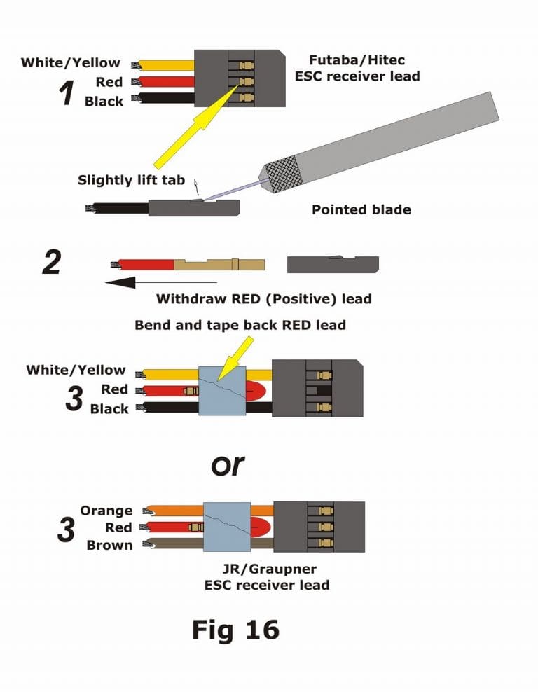

The only other variable is whether or not the ESC contains a battery eliminator circuit (BEC – see earlier). If it does, then you must NOT connect an additional power supply to the receiver. Some BEC-equipped ESC’s have a small slide-switch on a pair of thin wire leads. This usually controls the onward power from the internal BEC voltage regulator to the rest of the radio system and therefore serves as a radio ON/OFF switch. It does not control the power supply from the battery to the ESC, so I would recommend also fitting an addition high-current switch in the positive lead from the main battery to the ESC unless you are in the habit of disconnecting the battery physically each time you remove the model from the water. If you do disable the BEC for any reason, then leave the little switch in its ON position or you may find that the ESC doesn’t work; again, this should be covered in the ESC Instructions.

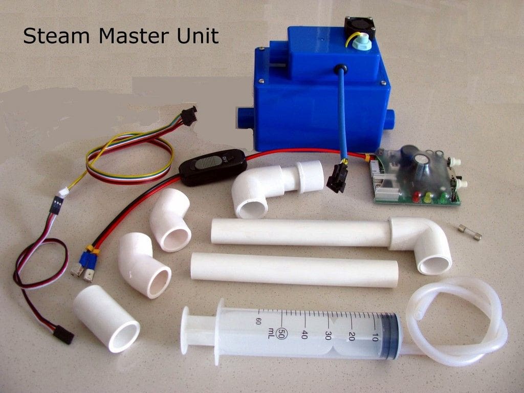

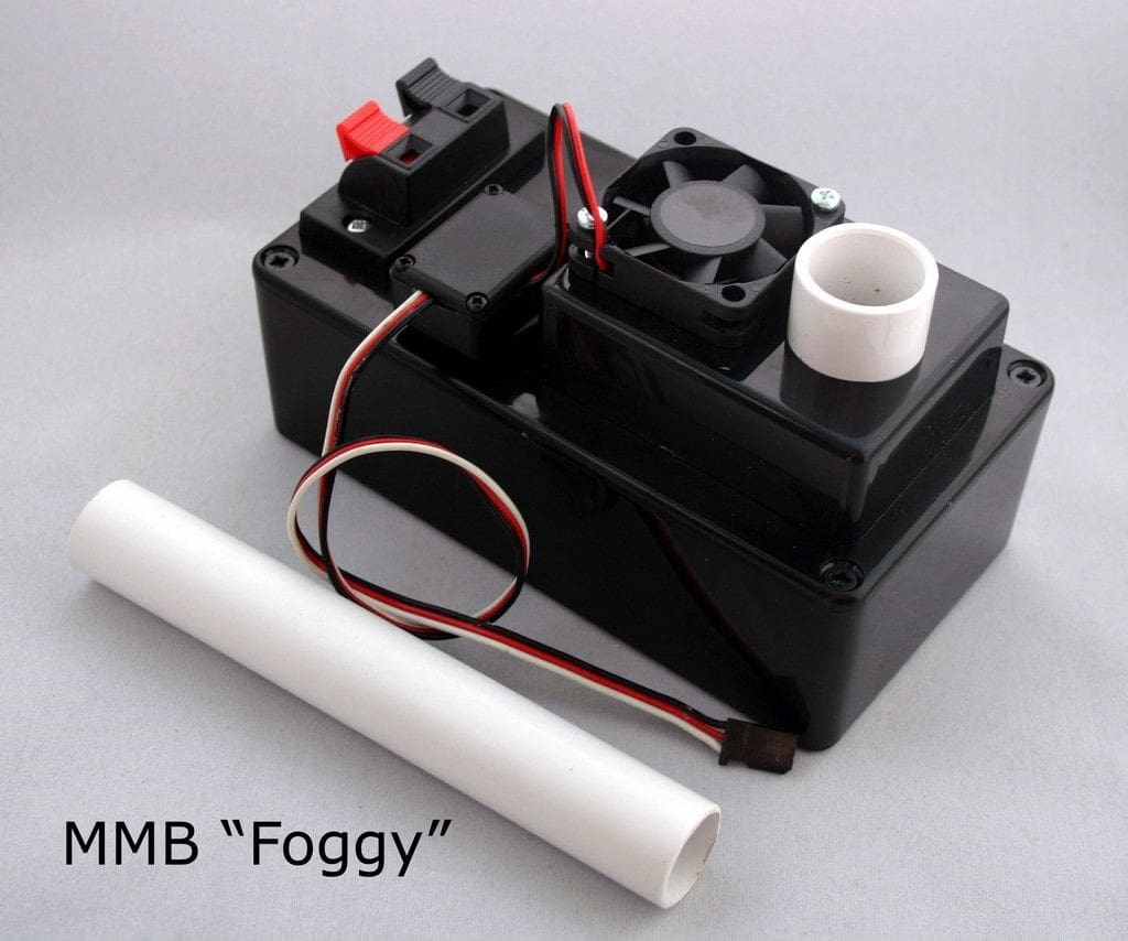

Smoke
For some modellers there is no option but to have a funnel belching smoke as the model steams away from the side of the lake. If you are considering fitting such an effect then make sure, as with an engine sound, that this is appropriate for the type of model, e.g. modern large diesels will give a cloud of dirty smoke on start-up, but then run without any visible exhaust, while other vessels have exhausts situated below the waterline.
Smoke or steam simulators work on two different principles. The first type e.g. Marks Model Bits’ ‘Foggy’ has an internal nebuliser and runs on water. The nebuliser creates a mist of water vapour which is then forced up a short plastic funnel by a small computer fan. This is quite a bulky unit and requires a 24v power supply to run (or a 12v/24v voltage converter). A more sophisticated version is available which has a small speed controller to increase the speed of the fan and thus the volume of smoke as the throttle is increased. The newer Steam Master unit does essentially the same thing, but works on any supply from 6v to 20v. It’s also smaller, but produces greater volumes of steam; has four different, programmable smoke outputs and is nearly twice as expensive.
The other type of smoke unit actually does produce real smoke, usually from a commercially-available hydrocarbon-based distillate. This oil is retained in a metal reservoir which also has a wick inside it. This soaks up oil and is ignited by a heating element to produce the smoke. This exits the funnel, either with or without help from a fan, as per the Foggy system. Hunter Systems’ unit works on 12v, but has no fan assist, while the daddy of them all has to be the Harbor Models unit. This 12v ‘squirrel cage’ blower-assisted unit is expensive, but mightily impressive and there is a video on their website.
The other pros and cons I have heard, are that the water-based units are ineffective in hot or humid countries, while the oil burners can leave a sooty residue all over the model. Oh, and you won’t get black smoke from either type, at least not safely, Photos 20 & 21!
