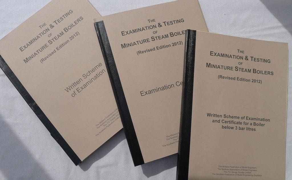

Looking back through my records I was surprised to see that it is now over two years since I did a column on Boiler Test Regulations in Boiler Room No.10 (October 2011 MB), so in conjunction with the introduction of a brand new revised edition of the old ‘Blue Book’, I think makes it about time we had another look at what is required. I think the easiest way is to have a look at the old Blue Book side by side with the new revised edition ‘The Green Book’, and see just what changes have been made and what it means to us as steam modellers, Photo 1.

As of the 1st January 2013, the latest revision came into effect and we are now covered by the requirements of ‘The Green Book’ set of rules. So let’s have a look at what has changed.
The changes
Although there are many out there who prefer to throw their hands in the air and claim ‘doom and gloom’ for the steam enthusiast, the bottom line is that there is very little in the way of practical change and most of The Green Book has simply been rewritten to clarify some of the requirements. Probably the first thing you will come across when comparing the two books is the fact that boilers below the 3 bar-litre limit used to be exempt from the requirements of the code, but with recommendations, and these are now actually included in the code. From what I have read on internet forum sites, there are some who see this as more restrictive, however to me what was being recommended was reasonable and easy to maintain and most clubs require the steam test to be done anyway, so now becoming ‘requirements’, makes little practical difference. So, now the regulations state that we have to do a steam test on boilers annually, which I have to say is not a bad idea. It is a ten minute procedure and involves a calibration check of the pressure gauge, an operational test of the safety valve, plus a visual inspection and Photo 5 here shows the basic test apparatus.
