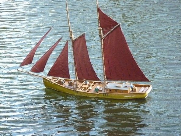

At the deck gunnel end, the shrouds are usually attached to the hull using a pair of deadeyes, one of which is already attached to each shroud. This task requires some dexterity, but if you gauge the height of the upper deadeye, threading between it and the lower deadeye is straightforward enough as in Photo 4. Aim for just a slight tension on this cord and there will usually be a gap of about one inch between the two deadeyes, although it could be more or less depending on the scale of the model. Please note that the two middle holes on the deadeyes are always the furthest apart. Photo 5 is a close-up of the shrouds/ratlines on the Grand Banks Schooner.
