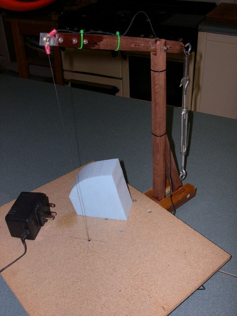

Bench-top cutter

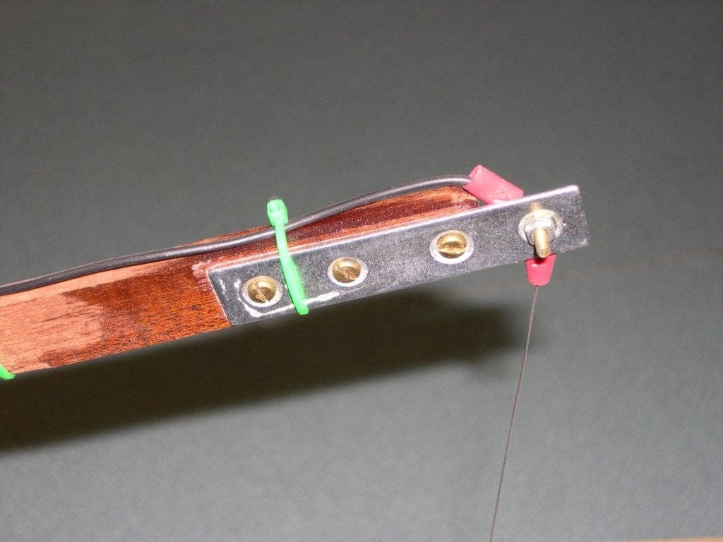

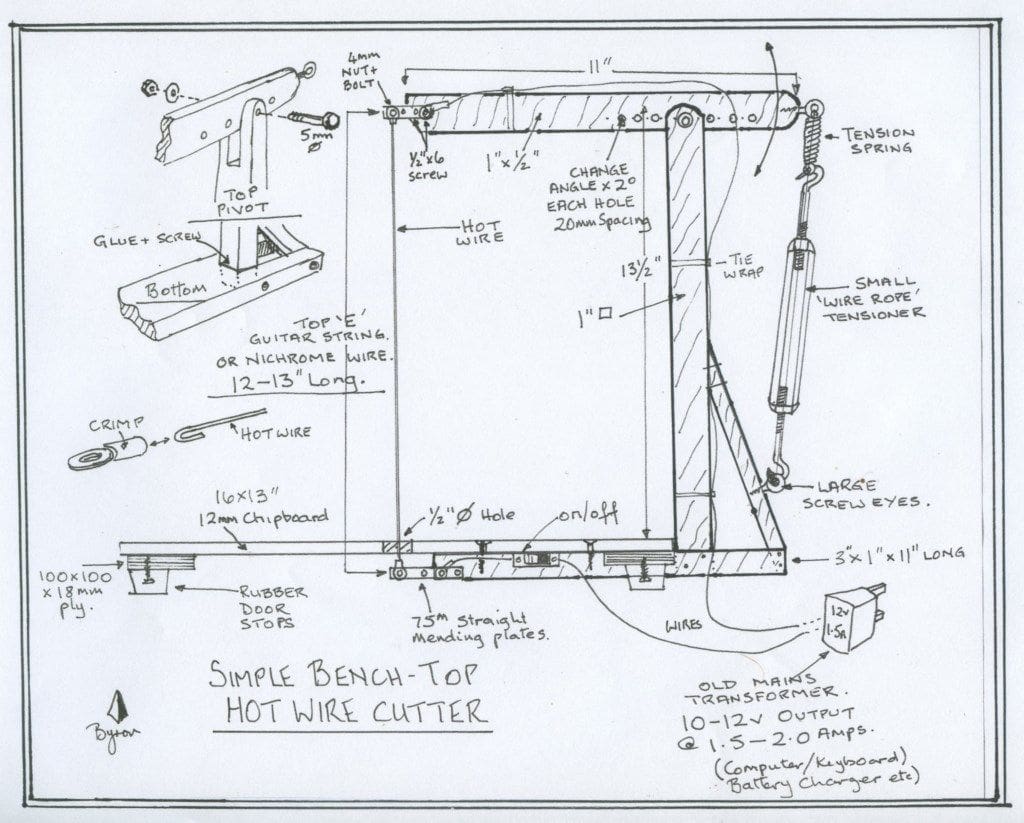

Blocks of foam up to ten inches thick needed to be cut at an angle of two degrees from the vertical, however they also needed to be cut vertically, so some form of angle setting device was needed. Industrial units have a tilting table but that was more work than could be justified. Consideration was given to putting angled bits of wood under the foam as it was cut, but that could never be 100% foolproof. In the end, a series of holes in the top beam that could be chosen as required and held with a bolt for a pivot, tilted the wire at progressively increasing angles, so that’s what was made as in the Diagram printed here. As you can see, by moving the pivot point on the top beam, the Hot Wire will move out of vertical and the tensioner is easy to adjust to ensure it remains taut. When tested on some ten inch thick blue foam, the cut was smooth and clean, provided a firm continuous pressure was exerted on the block as it was pushed past the Hot Wire, with cut marks only appearing if you stopped. The length of the throat of the device is not a problem, as the wire cuts in any direction, so long lengths and curves can be cut by pushing the foam block through from the side rather than the front.
Cutting was very fast in cheap white polystyrene foam and only a bit slower in the Styrofoam block (Blue Foam) used for the model boat hulls, because this latter material has a denser consistency. The pores of the cut foam were actually also sealed very nicely by the cutter, leaving a slightly shiny surface.

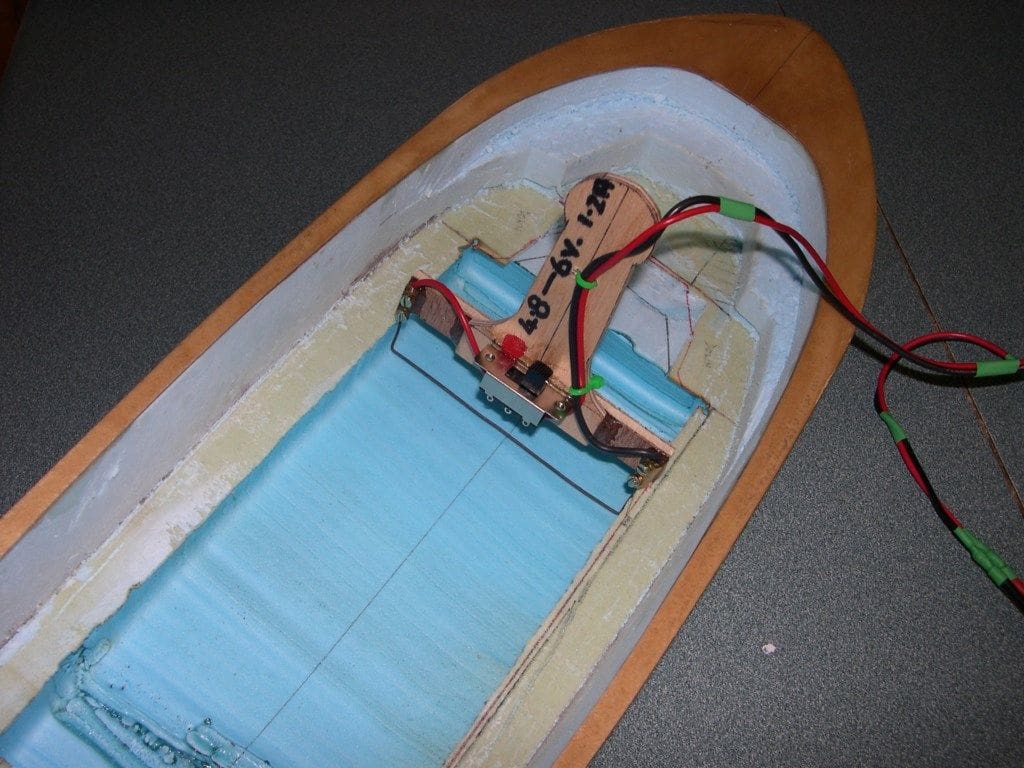

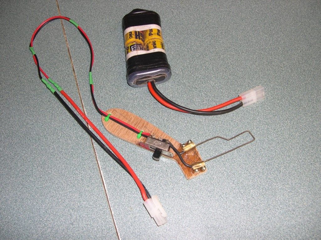

Smaller cutters were needed to make slots, recesses and cut-outs in the foam blocks inside the hull. An example of this would be cutting out a servo mounting hole in the foam, but a guitar string is not rigid enough to do this. In fact a semi-rigid shape needs to be formed in a wire that can be cut and shaped to a specific size of hole or opening. Therefore, a thicker type of wire was required and this was found in the Hobbies catalogue. A couple of metres were ordered and when it arrived it did indeed stay in shape when hot, but was also easy to bend into the desired shape with pliers.
Two small handles were made with terminals from electrical connector blocks which allowed for different shaped wires to be selected and fitted to do different jobs.
Sticking to the previously tested 5 to 6 inches of wire and plugging into the pack of four sub-C NiCd’s (4.8v), this rigid wire worked very well. The two hand-held cutter tools needed switches and these were fitted so they could be switched on/off quickly with the push of the thumb. In use, a cutter drew 2 to 3 amps from the NiCd pack and it needed to be re-charged following intermittent use after about 30 to 45 minutes which was more than adequate for my needs.
The thin wire on the bench cutter left a very small cutting slot (Kerf), but the thicker wire on the hand-held cutters burnt a kerf up to 3mm oversize, so this has to now be taken into consideration when planning a cutting job.

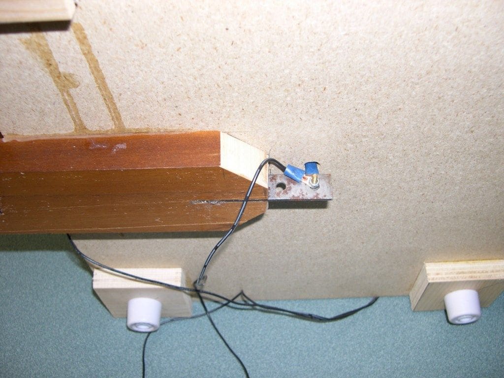

1) The mounting points were three inch long straight ‘mending plates’ and together with the tensioning device, which was actually a ‘wire rope’ tensioner, these were all bought from Screwfix Direct, website: www.screwfix.com or tel: 0500 414141 for your local store.
